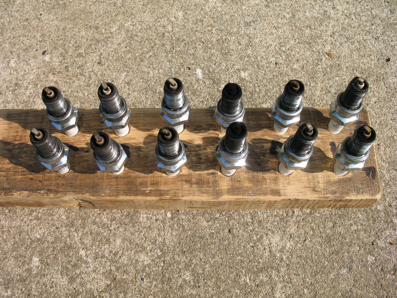

On 06/08/2011 05:03 PM, j. davis wrote:
If I push fairly hard on the bottom (push rod side) of each tappet I can compress the
lifter slightly, then it returns.
Actually, I just revisited my tappets. I put each cylinder at TDC and used my thumb to
push on each tappet. 10
of the 12 depressed just slightly, maybe 1/8". The two tappets immediately adjacent to my
'problem' cylinder (3), (number 1 intake,
number 5 exhaust) each fairly easily depressed about 1/4", maybe even 3/8". Does this mean
something bad? Seems coincidental that bthey are the adjacent tappets, although I can't
see how that would affect a different, adjacent, cylinder, but what do I know :")
Thanks again for all the advice, people!
Regards, J.

J.  If you are getting a leaky valve or possibly valve bounce, it will indeed effect other cylinders by disturbing the pressure waves of the incoming charges.  Remember, it is the negative and positive pressure waves that do the work, not as you would imagine a steady flow of fuel and air coming in and out of the cylinders.  I recently had a sticking exhaust valve that directly caused this particular 3300 to run on 3 cylinders, not just the one affected !
Worth a try - change out those valve springs....
Martin
Thanks, Martin, but I have a hard time swallowing that at just 100 hours, and running fine
last fall, that I would
need to change out valve springs that are not broken. That would be a sad statement
regarding the Jabiru engine indeed.
Just doesn't make sense. I need some hard evidence
before I commit to start pulling heads off. Don't forget, it's currently running fine,
just the #3 plugs are sooty.
And leak-downs are fine, so no sticking valve as was your case. You may be right, but at
this point I'm not
convinced... I'm leaning toward the hydraulic lifters right now, hoping some more Jab
experts will chime in
(Pete, Roger, where are you when I need you ;')

J - as it is running fine, I would tend to leave well enough along also.  But the fact that your adjacent valve springs are noticeably weaker must mean something.
The fact that it has only done 100 hrs is of little consequence in Jab world.  We had to rebuild 2 heads at 100 hrs, again at 200 hrs and replace all rocker bushes and pins at 250 hrs. So we are now using the LCH ones from Rotec.....

It's not the springs that are weaker, it's the lifters that compress easier. Yeah, its running smoothly now, but if those two plugs actually foul, that'll be bad...

I've attached a picture of the plugs just to illustrate what I'm seeing. Don't be alarmed
that the others
look too lean, I was aggressively leaned at shut-down.
Thanks!
Regards, J.

They don't look lean to me.  Obviously you have never raced a 2-stroke....  Wink
Besides, you 'read' a plug by looking down the bottom of the insulator, not the firing end....
Still a mystery
Cheers
Martin

Compared to yours, I'd need to wear sunglasses to read my plugs. : )

PostPosted: Thu Jun 09, 2011 10:30 am    Post subject: Re: Help! 3300 rough running puzzle. Reply with quote
Hi J
To respond in order, when you checked the coil resistances were the coils hot? Resistance goes up with temp. increase....Plug color or how dirty they are, new or otherwise is a function of mixture and the completeness of combustion supplied by the ignition. You could buy a pair of NGK Iridium Plugs which require less juice to fire and install them in the #3 cyl for experimentation. They worked for me at .025" gap no antisieze on threads per NGK.
.""Also magic markered the magnets to witness any potential future contact""
What i thought was interesting...
Just wondering if you had seen evidence of contact before as quoted above. Thought the plugs looked dirty indicating a possible over all ignition problem thats all. Everyone knows that your problem could become their problem in the future, hope the solution can be found and reported here, keep trying.....Don B
Zenith 701 #76120
Jabiru 2200A #2456 95 hours
Sensenich Wood 64-PJ-36 Prop
jd(at)lawsonimaging.ca
PostPosted: Thu Jun 09, 2011 2:54 pm    Post subject: Help! 3300 rough running puzzle. Reply with quote
On 06/09/2011 02:30 PM, dons701 wrote:
Hi J
Cold. The Jab maintenance manual doesn't specify a temperature at which to test, so I'm
assuming they mean cold.
Check.
.Also magic markered the magnets to witness any potential future contact
Just wondering if you had seen evidence of contact before as quoted above and thought the plugs were dirty indicating a possible over all ignition problem thats all. Everyone knows that your problem could become their problem in the future, hope the solution can be found and reported here, keep trying.....Don B
No, not personally, but I've read of coils destroyed by contact, don't know how/why that
happened, but I like to just be able to give a quick
glance to ensure that my black magic marker is intact and unscathed ;') Just for the
comfort factor...
As an aside, I discovered that my 'soft' lifters just needed filling. Spun the engine with
no plugs, watched oil pressure climb. After that, they were just like the others. One more
possibility ticked off as not the cause. There must be a definitive and scientific reason
for these two sooty plugs,
still hunting ;'(
Regards, J.
- Sonex #325 C-FJNJ, Jab 3300a, Prince P-Tip, Aerocarb
- former C-IGGY CH701 owner/builder, CH750 in progress
- see both (and more!) at http://cleco.ca
J. Davis, M.Sc. (comp sci)
email: jd at lawsonimaging.ca
*NIX consulting, SysAdmin
http://cleco.ca
My aunt gave me a walkie-talkie for my birthday. She says
if I'm good, she'll give me the other one next year.
--- Steven Wright
aerobiz1(at)gmail.com
PostPosted: Thu Jun 09, 2011 3:18 pm    Post subject: Help! 3300 rough running puzzle. Reply with quote
J - given that your two plugs are sooty rather than wet, I would hazard a guess that the mixture is too rich rather than the plugs not firing.  Have you tried twisting the carb a few degrees off centre ?
Martin
On Fri, Jun 10, 2011 at 8:49 AM, j. davis <jd(at)lawsonimaging.ca (jd(at)lawsonimaging.ca)> wrote:
[quote] --> JabiruEngine-List message posted by: "j. davis" <jd(at)lawsonimaging.ca (jd(at)lawsonimaging.ca)>
-->  JabiruEngine-List message posted by: "dons701"<burdon1(at)comcast.net (burdon1(at)comcast.net)>
Hi J
Cold. The Jab maintenance manual doesn't specify a temperature at which to test, so I'm assuming they mean cold.
Check.
No, not personally, but I've read of coils destroyed by contact, don't know how/why that happened, but I like to just be able to give a quick
glance to ensure that my black magic marker is intact and unscathed ;') Just for the comfort factor...
As an aside, I discovered that my 'soft' lifters just needed filling. Spun the engine with no plugs, watched oil pressure climb. After that, they were just like the others. One more possibility ticked off as not the cause. There must be a definitive and scientific reason for these two sooty plugs,
still hunting ;'(
Regards,  J.
http://cleco.ca
                               --- Steven Wright
ine-List" target="_blank">http://www.matronics.com/Navigator?JabiruEngine-List
MS -
k">http://forums.matronics.com
e -
         -Matt Dralle, List Admin.
t="_blank">http://www.matronics.com/contribution
vvkidd(at)mindspring.com
PostPosted: Thu Jun 09, 2011 4:38 pm    Post subject: Help! 3300 rough running puzzle. Reply with quote
Not sure that this could be your problem but I had a similar problem with a C172.
Found that the hose coupling between the two halves of the intake manifold had slipped and was admitting air into the manifold thus changing the mixture.
Victor Kidd
