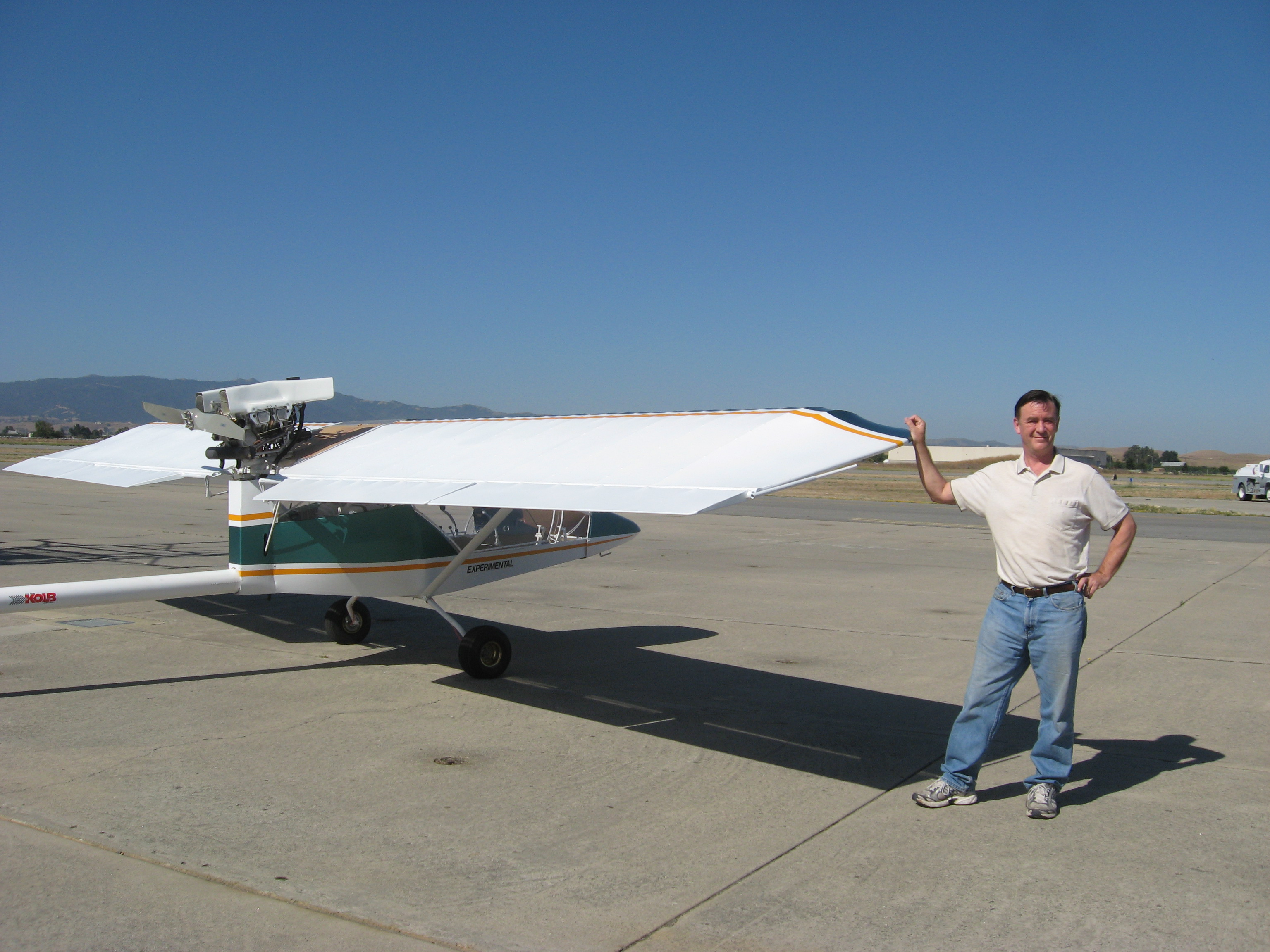

PostPosted: Sun Jul 03, 2011 12:33 pm    Post subject: Re: N1014S MarkIII Xtra 2nd "first flight "- Fr Reply with quote
Hey Gang,
Gotta share..
Its a wonderful day in Hollister CA.. no wind, getting HOT, 75deg F , 6000 feet of paved runway..
Just finished doing high speed taxi tests, Line up , feed in power, WOW we're up and climbing like Hell... Ease off the power, engine getting hot, climb to 2500ft, CHT still up there , red light on. still need slight nose down trim (Push). back off the power, Fly around for 10 mins, feels good, slow down on purpose, left wing drops a little between 35-40, good.. Line up for landing careful to keep power in at 50MPH.. down, down Ok start to feel for runway, THUNK, ok landed.. still had 2 feet to go when KOLB STALL kicks in .. but my new steel legs did OK.. Taxi back. stop..
Thanks Travis and kOLB folks..
As you may know my very first flight was with my wings and tail rigged incorrectly, WAYY to much up elevator...
SO now I very close to the following angles..
motor mount and Engine = 0 deg
Boom Tube = -6.1deg
Wing= +3.4 deg.
Horz Stab = -4.8 Deg , I think I need to add a few Deg more. to reach this number..
New long steel legs.. A REAL 1st flight
Now I have an airplane...
Time to fix that radio that is garbled, work on the high temps of the Jabiru, and put in a dynamic trim system.. and raise the LE of the horz Stab slightly.. Fun Fun..
Fly safe, these are GREAT airplanes..
FrankD

PostPosted: Sun Jul 03, 2011 2:52 pm    Post subject: N1014S MarkIII Xtra first flight - Frank D Reply with quote
Congrats Frank. You did good. Airplane looks fine.
Have fun tinkering.

Frank, Have not seen those cooling fairings before.Where did you get them?
G.Aman MK3C jabiru 2200a Head temps well below 300f, 630 hrs
ces308
Joined: 03 Nov 2008
Posts: 317
Location: houghton lake ,mi
PostPosted: Sun Jul 03, 2011 8:55 pm    Post subject: Re: N1014S MarkIII Xtra first flight - Frank D Reply with quote
Good job Frank !I'm glad you are getting it
dialed in !
On your air scoops...does the air flow right through them? And the way they are spread apart looks like it may actually be blocking the air flow or not letting air go through them...just a thought...
