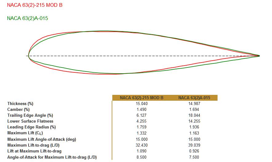

In an earlier posting Graham enquired about the actual airfoil profile for the TR-1. Attached herewith a diagram which can be used for that purpose to a very close approximation.
It is a comparison between the 63(2)-215 [in red] and 63(2)A-015 profile [in green] with identical chord length.
For all practical purposes the TR-1 wing profile could be considered to match the red outline for the left half of the chord and then follow the green outline for the rear section of the chord.
This diagram can be accessed at: http://www.worldofkrauss.com/foils/show_compare?sform_contains=63%282%29&items_per_page=50&commit=Compare&id[]=1416&id[]=1688
