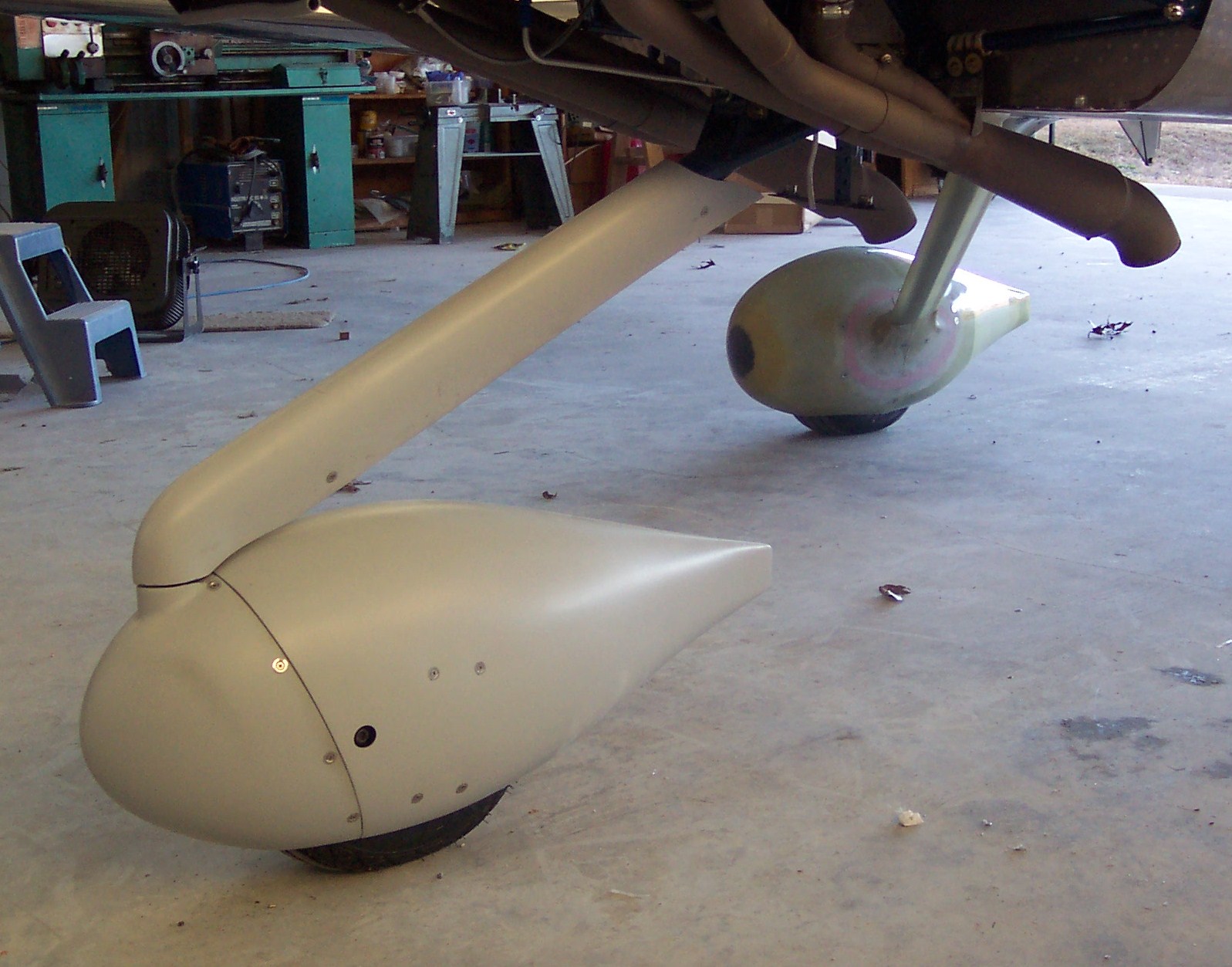

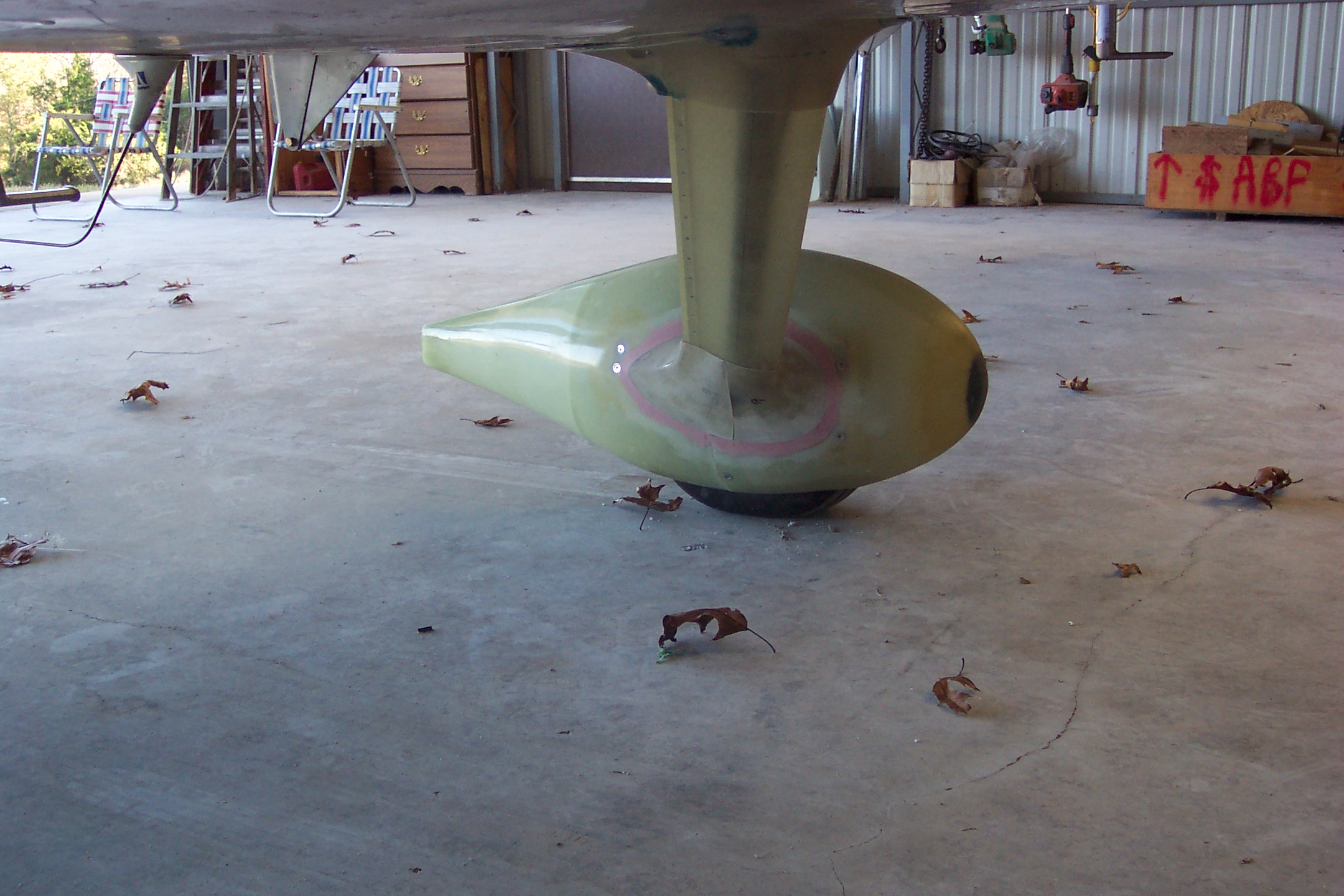

We balanced all three wheel pants before flying (photos attached).
