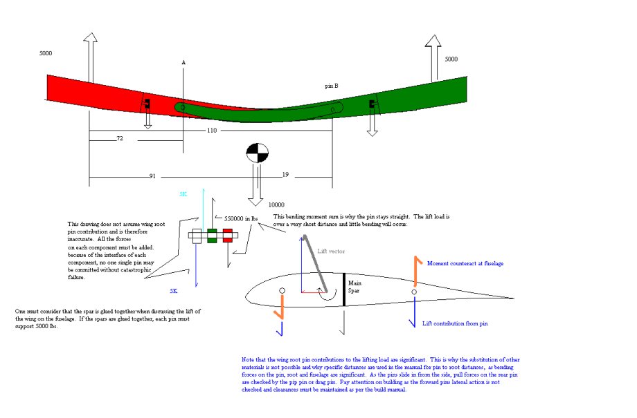

PostPosted: Thu Jan 20, 2011 7:31 pm    Post subject: Main wing bushings Reply with quote
<?xml:namespace prefix="v" /><?xml:namespace prefix="o" /><![endif]--> Sorry guys if I don't understand the actual question about the bushes and bearing loads! I had to go back and try to picture the question, in the mean time, Grahams analysis is spot on as usual.
To visualize the loads read on to my miscellaneous drivel.
The two spars are basically a set of scissors.. The pins lock the spars together like a pair of scissors trying to cut a steel bar. The pins of course must go through the fuselage and each spar to hold the fuselage gravity forces and translate the lift forces of the wings to the fuselage.
The bushes distribute the load and the hardened pins take the lifting loads as shear load.
Essentially the fuselage (about 1100 lbs. loaded with down tail forces added under G and acceleration as well as the radial Gs) hangs from the pins.
The spars bend under the vertical load. Like a pair of scissors, that is trying to cut through that solid steel bar stock, so picture the force of your hands causing the thin blades to bend, as you would expect a thin long pair of scissors to twist, bending vertical and laterally.
Mod 52s rear socket and tube takes the forward element of the lift vector (the lift of the wing near maximum is forward and up, really pulling on the aft socket) and translates the load through root rib, to the rear attach to the steel tube in fuselage which is under tension but does not significantly contribute to the vertical lift load.
Because the aircraft is fiberglass and it does move a bit under load, the spars twist some under load. The Mod 52s, 1/2 inch spar pip pin, keeps the tip of the starboard spar in check and from slipping into the control linkage under bending and twisting. The spar strap deters twist and spar separation under load from their at rest positions. The pins hardened strength allows it to not be sheared by the huge shearing action of the two spars against the fuselage and each other.
So why doesn't the spar pin bend at the bush? Picture the fuselage weight is pulling down at the left cockpit bush, the left spar (forward) is pulling up, but the right spar (aft) is pushing down, and the sum of the actions basically keeps the pin horizontal. All that force though is on only one 1/2 inch in diameter pin, and that is one heck of a lot of shearing force. Because it is over a short distance (and our spars are tight together), we don't have to have microns of tolerance in the pin to bushing fit.....The action of the spars against one another brilliantly keeps the pin horizontal and not from bending upward at the fuselage bush and slipping off the pins as one would expect at first glance thinking of only one spar.
It is a clean neat simple design. Could it be better, you bet, but can it be built by us simple beings easily and cost effective? Probably not, so do I want to change it? No way, it isn't worth it. Like you all say, it ain't broke, so don't fix it.
For you new builders, keep your bushes and spars at a reasonable tightness and you will be fine. If you must ream the bush a bit because the port pin is too tight, you only need to ream a couple of thousandths normally. A heated pin through the bushes works best, as Graham said before, to take a slightly out of align bush and right it. Don't panic at the fuselage bush slop as the spars keep the pin horizontal. Always use the spar strap and the pip pin adjusted as per the manual with the washer to distribute the load on the poor spar cup. Don't substitute bolts for the wing pins provided unless properly hardened. If you own a classic, do a Mod 52/74 as it is great insurance.
Regards to all and I hope to see you at Sun "n Fun.
Bud Yerly

PostPosted: Fri Jan 21, 2011 4:49 am    Post subject: Main wing bushings Reply with quote
Not to be argumentative or picky....but....
My original mental analysis was just as Bud has described - but Graham's
description contradicted the assumption that under positive high-G loads,
the main spar pins are indeed providing an upward force vector to the
cockpit module as originally (and intuitively) thought.
The reason being that both the forward and rear (your rear pin under tension
analysis is accurate tho) lift pins are indeed taking *all* of the downward
G-loading from the cockpit module, pushing upwards on the fuse, and the two
spar pins are actually pushing *downward* on the cockpit module
(disregarding the twisting vector on the main spar pins imparted by the
scissor action of the spars). Why? because the spars are actually bending in
a curve (think a smile) just as the entire wing is, and the root ends of the
spars are actually (relative to the fuse) higher as a result than the spar
pin positions. The spar is trying to impart it's smile shape onto the
vertical cockpit module surface - which is not going to comply.
I believe this analysis (Graham's) is correct. So the fuse is not hanging
on the spar pins during high-G loading as one would intuitively assume.
Cheers,
Pete

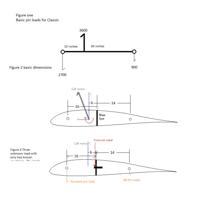

PostPosted: Sun Jan 23, 2011 9:15 pm    Post subject: Main wing bushings Reply with quote
 <?xml:namespace prefix="v" /><?xml:namespace prefix="o" /><![endif]--> [img]cid:001601cbbb85$27b74dc0$9678D4DA(at)adminPC[/img][img]cid:001701cbbb85$27b74dc0$9678D4DA(at)adminPC[/img] Photo E-mail [url=http://photos.msn.com/Viewing/Album.aspx?PST=8nK2AN1B!1LEiKSdooxx9v4CFFiF2tnPWP2mfc7Vl*sFUj2!vUzirO5TouaOzaO*BEOC0mA51!eASMb0hNQHNQ%24%24]Play slideshow[/url] | [url=http://photos.msn.com/viewing/Photos.aspx?pi_Type=SlideshowTask&Task=Download&stppData=&pi_ImagesOnly=1&Folder=nBuRgwTGIGjZPMtNhxCyPhYLUBR*bYP2KBLX6a88C1s%24&User=23IQaj7Z2BRqNO1wUECSpX*P0Ju9hSGI&pi_NoLogin=1]Download images [/url] Pete,
I really enjoyed our discussions, as you and Graham have excellent insight and the Lord knows I need a break from wiring.
Just as you and others found it interesting that the side pins on the fuselage were designed to take all the load in lift and moments, I ran some basic calcs one Sun n Fun and it hit me why.
If you consider the wing sockets only it is a determinant structure and easy to calculate.
When the Europa was only 1300 lbs, like my Classic, I figured quick and dirty the following:
The GW is 1300 less wing weight is 1200, times ultimate of 6 Gs gives 7200 lbs load and 3600 pounds load born by the pins on each side.
Figure one below shows the balance beam idea. Of course we have to add pitching moment and the drag component doesn't go exactly through the pins and the dimensions were rough as shown in figure two. Considering 304 stainless pins are good for about 15Ksi in shear and at 1/2 inch diameter they can take a load of roughly 3000 lbs. The front pin holds about 2700 pounds and the rear pin about 900. So it was a slam dunk why it was calculated that way.
My instructors in college had a saying which was "the spar takes the lift and the root takes the moments" and that is something we, and I am sure the PFA, all remember. So the Europa design calculations indicate the main spar only translates the wing bending and the wing spar pins carry no lift load in the calculations. But who would buy an aircraft where the wing pins are not attached to anything but the spar themselves. After all if the wing sockets at the root carried all the load, we would only have an inspection plate in the fuselage back and we would rig the wings to the spar cup and side sockets only, then stick the other wing in, pin it and go fly. What do we need all that extra ply, aluminum and bushings for in the cockpit bulkhead? That is a lot of beef for just the spar bending loads and lateral shifting to be checked. That is unless it is redundant structure?
Further, if we increase the loading of the plane to 1450 lbs and then take the gust loading into consideration as well as temperature, the actual loading jumps up by a huge factor. We only had a reserve on that front pin of a few hundred pounds, now that pin/socket is going to be compromised.
If we consider the wing is supported at the main pins as a fulcrum say, we have the sum of forces and the sum of moments but three unknowns and we have an in-determinant structure as in figure three. If you assume the wing pin takes all the load as a see saw, then the spar bushes only have the moment load which is much less. Add in the point you made about the spar bending actually unloads the load its all gravy. So it seems without extensive strain gauge testing you can't get the design approved on the statement "well the pin is really not overstressed". We can't calculate the forces actually born by the pins unless we assume (ass out of u and me) some loadings.
It is my feeling that the main wing pin does in fact take some of the lift load, greatly relieving that front pin. Any assigned loading on the bulkhead wing spar pins would significantly relieve the front socket. I believe this is born out by the fact that so many aircraft are flying well over gross weight and have flown uneventfully with no signs of stress on the forward pin and socket. Looking at the forward and rear socket, we also note that if a careless builder did not get the clearances as per the manual, bending on the pin would compromise the rib attachment as the glass could not stand the peel forces from the pin threads and disaster would ensue. A loss of any one pin would be catastrophic. If the front pin was removed, the rear pin may be able to take the load, but the root rib shear web may not be quite strong enough and the main spar cannot take any twisting so structural integrity will be lost. So to recap, the root rib, socket attaches, and pins are all critical.
Anyway, that is all I was commenting on. I'll leave the gross weight increase to Dave Goddard as he is a whole lot smarter than me. Other drawings and comments are provided below the three figures.
Regards to all,
Good night,
Bud

PostPosted: Mon Jan 24, 2011 4:38 am    Post subject: Main wing bushings Reply with quote
In support of Bud and Pete’s notes I can confirm that flexing of the fuselage is important.  The LAA had considerable concerns that the tail dragger conversion would stiffen the structure in such a way that it could lead to overloading of the forward lift pin.
Ian Rickard G-IANI XS Trigear, 300hours

PostPosted: Mon Jan 24, 2011 3:23 pm    Post subject: Main wing bushings Reply with quote
Not convinced Duncan. The spar resists bending and the leverage is enormous, from the centre of lift of the wing 30% span? The load on the root ribs is shear and some bending of the pins. Don't forget the lift load is a spread load whereas the spar bending of the tangs is a point load applied by the spar pins.
You are right about the stiffening of the fuselage side. We really should have flexible sockets at the LE as well as the TE.
I still believe the lift pins (in the root rib) should carry all the lift loads and the spar pins all the bending loads. That's why the tangs needed to be strengthened on the glider.
Graham
