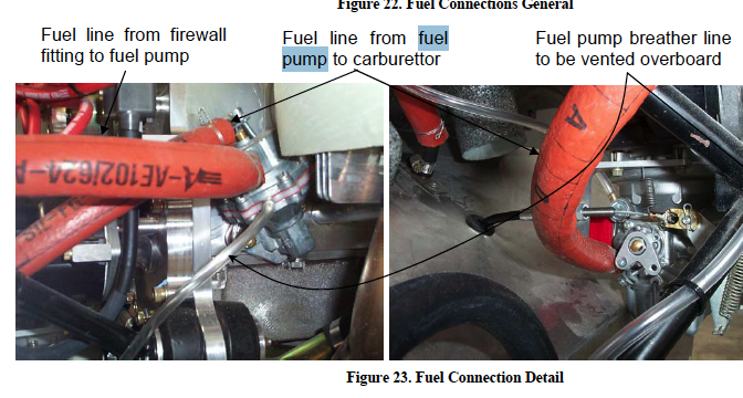

Attached is a photo of the Jabiru 2200 fuel pump from the Installation Manual.
 Filesize:  296.45 KB
 Viewed:  11426 Time(s)

PostPosted: Thu Jan 13, 2011 9:29 am    Post subject: Kolb/Jabiru carb overflow Reply with quote
Manual. You can't see it in this photo but the fuel line FROM the pump to
the carb is behind the supply line with the fire sleeve to the pump.
Thom Riddle
Thom R/Folks:
The way the pump is mounted, inverted and canted, seems to be a built in
situation to trap condensation.
The 912 eng driven fuel pump is a "run of the mill" Pierburg pump, about the
same as used on the old Opels. It is a throwaway pump that can not be
disassembled. It is mounted on the gearbox and driven off a lobe on the
prop shaft. Maybe this location reduces the amount of condensation it is
exposed to, maybe not. Wink

My Jabiru engine has its fuel pump located as shown in the photo I posted. I have an oil breather "catch can" that I empty after each flight by opening the petcock in the catch can drain line. It always drains out several drops of muddy/wet looking oil/water muck. This air/oil separator must be catching most, if not all, of the moisture in the oil system because the oil dip stick never shows any signs of this excrement or condensation, nor is there any when I change the oil.
On my pusher configuration, with the engine hanging out in the breeze, and me living in the north with mild summers, it does not need an oil cooler and therefore does not have one installed. I rarely if ever fly in winter so the oil temps always manage to get up to the 170F minimum (at return line to engine) specified by Jabiru, as long as I don't baby the engine during climb. I doubt seriously, that the oil temp would get up to minimum in this weather without closing down some of the air scoop, but I could be wrong, since the CHTs get up to normal in cold weather.
18F currently (Thursday 1PM) and still snowing... almost continuously since Tuesday around noon. Beautiful to behold, if you are dressed properly.
