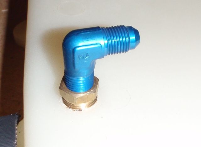

PostPosted: Sun Mar 20, 2011 6:17 pm    Post subject: Re: Gascolator Reply with quote
I have been working on the new header tank, among other things, and I have a couple more questions about it.
First it seems that all components used for my fuel system is 1/4" so I am going to replace the two in barbs with 1/4". Is there something wrong with this? Hope not.
I am also looking at the blue elbow which leads to the engine from the header. I am familiar with compression fittings but I can not figure this one out. What size tubing goes into this nipple? None of the tubing I have seems to fit and it is 1/4" aluminum. Also, I can not for the life of me find the 'nut' needed to complete the compression fitting. I have searched on Aircraft Spruce for over an hour and gone through the builders manual and can not find the name of this part.
Someone please help.

PostPosted: Sun Mar 20, 2011 8:20 pm    Post subject: Gascolator Reply with quote
I used 3/8 for my feed lines to minimize losses.
I hope someone else can figure out what you're asking, because without
pictures I can't. If nobody else replies shoot some pictures or
reference some manual pages / pictures and I'll try to help.

PostPosted: Sun Mar 20, 2011 8:48 pm    Post subject: Gascolator Reply with quote
James,
If you are looking at the typical factory fitting, it is for 5/16 tubing and
the parts you are looking for are as follows:
AN818-5D "Nut"
An819-5D "Sleeve
You will need one of each for each connection. don't forget that you will
need them at the fuel valve as well as the termination of the aluminum line
at the firewall. My system includes the compression fitting at the header
tank, two at the fuel pump, two at the fuel valve and one that runs to a
hose barb just forward of the firewall. I just finished my new project
system and am well aware of the frustration finding parts - lots of bushings
to change pipe thread diameters etc. Also keep in mind that aircraft
compression fittings use a different angle of the flair than the typical
hardware type - as I understand it, the typical AN fitting we use has a 45°
flair and the hardware store fitting flair is 37°.
If your fitting happens to be for 1/4" tubing, then the suffix would be 4D
on both. On the Model IVs the wing tank to header tank tubing was typically
5/16", however I know of guys that have changed to 1/4" throughout the
system and have flown hard with no fuel flow issues. If you are running the
582, you might think about 5/16 as the fuel consumption is a bit higher than
the 912.
Lowell

WurlyBird
Joined: 16 May 2008
Posts: 207
Location: North Pole, Alaska
PostPosted: Mon Mar 21, 2011 3:03 am    Post subject: Re: Gascolator Reply with quote
Unfortunately the builders manual for the 3 does not go into great detail with the fuel system, which is probably why the guy that built mine had it so oddly set up. I am running a 582 and the current fuel set up runs strictly 1/4" and I have had no issues. It is not until I got this header tank that it was brought to my attention that this wasn't normal. The way my fuel system is now it is 1/4" aluminum tubing under the seat and into the fire wall, but any where there needs to be flex or a fitting there is a section of rubber fuel tubing. Hopefully I can get this sorted out with out too much trouble. thanks for the help, and here is a picture of the fitting I am talking about.
 Filesize:  36.85 KB
 Viewed:  14113 Time(s)
James
Kitfox 3 / 582 / 70" IVO 2 blade GA
50 hrs on the 582 swapping for HKS 700E and Avid Cowl.
helili(at)chahtatushka.ne

Pat Reilly
Joined: 06 Aug 2009
Posts: 345
PostPosted: Mon Mar 21, 2011 7:22 am    Post subject: Gascolator Reply with quote
Wurleybird, I have a mod 3 582 with 1/4" plastic lines to plastic header tank behind seat and aluminum line from header to valve under the panel, and hose connecting aluminum tube to valve and from valve through firewall. The only problem I encountered was getting fittings in that plastic header to seal up. I tried everything with no success until someone on this site recommended Dow 730 sold by Aircraft Spruce. It sealed up on 1st try with no sign of a leak. The only draw back and reason why I tried everything else 1st is the damn stuff is $100 for a 3 oz tube. I used about $2 worth on the fittings and still have the tube in the refrigerator a year latter. Wife hasn't complained about that use of the refrigerator once. She was much more upset the day she called me after she found a skunk in the freezer compartment that I was intending to skin out for a hat for the grandkids. Since I do all the cooking why would she be in the freezer anyway? She asked, "Is there a dead animal in our freezer?" I replied, "Sure there are alot of dead animals, pigs, cows, chickens and fish too. Why do you ask?" "No, I mean with black hair still on it". The conversation went downhill from there. But, alls well that ends well. We are still married. Although come to think of it she is my 2nd wife. Had to divorce the 1st one. It was all her fault. She absolutely refused to get along with my girl friend.

PostPosted: Mon Mar 21, 2011 7:34 am    Post subject: Gascolator Reply with quote
Lynn,
I stand corrected. The point I was trying to make is that the Ace Hardware
flairing tool, is not the one to use for AN Fittings.
My bad.
Lowell

Pat Reilly
Joined: 06 Aug 2009
Posts: 345
PostPosted: Mon Mar 21, 2011 7:36 am    Post subject: Gascolator Reply with quote
Wurlybird, I saw that fitting in your other post. I believe it was a flare fitting. I don't kow what size aluminum tubing you need. And, off the top of my head, I don't know what size mine uses. I have a similar fitting out of my header tank with aluminum tubing.  1/4" rubber fuel hose is a very tight fit over the aluminum tubing. Guess that would be 1/4" aluminum tubing.

Pat Reilly
Joined: 06 Aug 2009
Posts: 345
Wurleybird, Those AN flare fittings are available from most streetrod or race car parts suppliers also, Summit Racing, Jegs, etc.

Tom Jones
Joined: 12 Mar 2006
Posts: 752
Location: Ellensburg, WA
PostPosted: Mon Mar 21, 2011 7:58 am    Post subject: Re: Gascolator Reply with quote
I sense a little confusion on the aluminum fuel line size. Hard line tubing is measured as Outside Diameter (OD). I suspect the aluminum tubing here is 5/16" OD so fittings would be sized as such. The early kitfox kits I am familiar with came with 5/16 OD aluminum tubing fuel line.
James, if you change any fittings be sure to check their inside diameter. Some have a tiny...about 1/8"...ID, especially 1/4 inch fittings.
The only way to be sure if fuel flow is sufficient is to do a flow rate test at the fuel pump level. Do two. One in level attitude and one with nose high.

Pat Reilly
Joined: 06 Aug 2009
Posts: 345
PostPosted: Mon Mar 21, 2011 8:35 am    Post subject: Gascolator Reply with quote
Tom, Thanks for the clarification. I can force 1/4" rubber fuel line on the aluminum tubing from the header. It is definitely a "force fit" though, 5/16" OD tubing would make sense.
