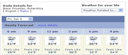

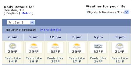

Cold in Maine??
Check out tomorrow’s Houston forecast compared to Base Orcadas C Antarctica.  J

Last night decided that Houston is the best “coat city” in the country. People don’t spend money on coats here, so there’s not a whole lot of fashion when it gets cold.
You see coats coming out of the closet that haven’t seen daylight since 1973. Butterfly collars, sheep skins on the outside and wool on the inside. You name it. One guy reached into his pocket the other day and found a receipt from 1981. (Okay not really, but you get the idea.) J
There are other folks who are wearing coats that fit perfectly when they were 18 years old in Nebraska, but not so well at 42 in south Texas. It’s funnier around here than you can ever imagine.
Just this afternoon, I shut off water to two houses on our street who busted water pipes. I’m sure their owners will be upset when they get home, but hopefully I saved them a little cleanup work and a smaller water bill too.
I might make another drive down the street to see if I can pick up a few more broken pipes.

Cold in Maine??
Check out tomorrow’s Houston forecast compared to Base Orcadas, Antarctica. J

Having served in Antarctica, I can say you are comparing Apples and Oranges. Houston is in the middle of their Winter and Orcadas is in the middle of a Summer Heat wave. Just wait a month and watch the change.
