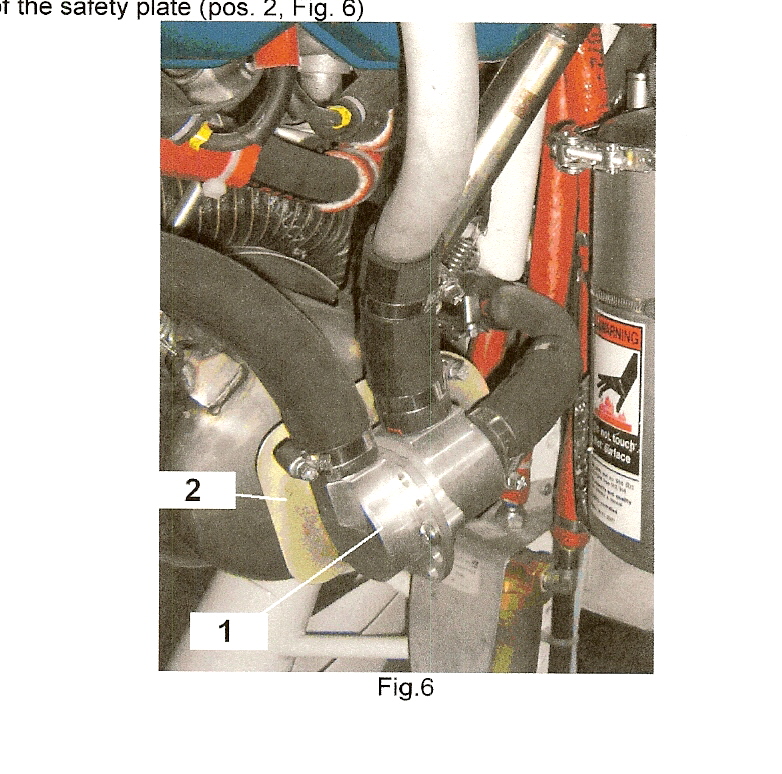

>> Here is a link to see one on a 912. You mount it on the left side before the radiator. No pressure problems. You can also use a Perma Cool oil thermostat for the oil.
>> http://www.flightdesignusa.com/dbimages/big_thermo.jpg
>> Here are two pictures out of a manual.
>> Roger Lee

I don't believe you need any different coolant tank. It is only a
difference in plumbing. If there is anyone around you with a Flight Design
CTLS you could stop by and take a look at theirs.
Roger Lee

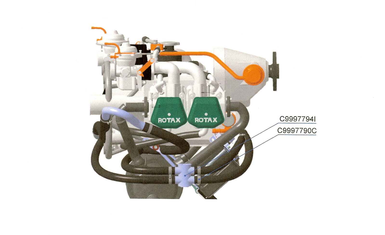

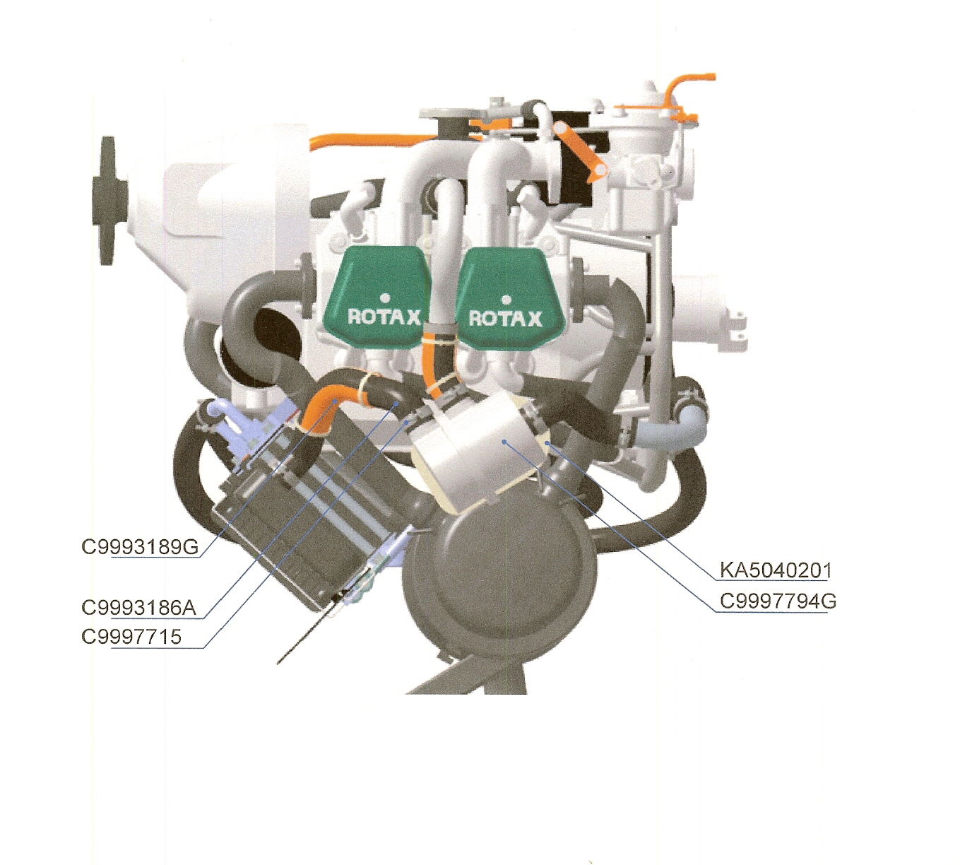

PostPosted: Wed Dec 16, 2009 4:57 pm    Post subject: Re: Rotax 912 Question Reply with quote
John,
Here are a couple of pictures. Two of the coolant thermostat and one with an oil thermostat. These only go to 180F and won't take an engine to 200F. 180F is about the highest on the market. The tape is less expensive and you can tape until you get your desired temp. These are not cheap either.

PostPosted: Wed Dec 16, 2009 7:00 pm    Post subject: Rotax 912 Question Reply with quote
Roger Lee
Thanks, Roger:
I got the photos that time. Still didn't show where they are bringing the
bypass water from.
I'm going to stick with what I have. Looks like this 912ULS is going to run
about 20F cooler with the Titan Exhaust System. May be able to get away
with bypassing the oil cooler like I used to do on my 912UL. If not, I'll
go to the tape.
