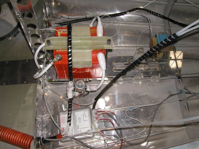

PostPosted: Thu Sep 24, 2009 6:17 pm    Post subject: Re: Chargers Reply with quote
This is going to be the way I secure my charger to my battery. Only the best for my RV-10.
 Filesize:  79.45 KB
 Viewed:  14042 Time(s)
40936
RV-10 SB N801VR Flying
780 Hours
SuperSTOL 60 hours
jump2(at)sbcglobal.net

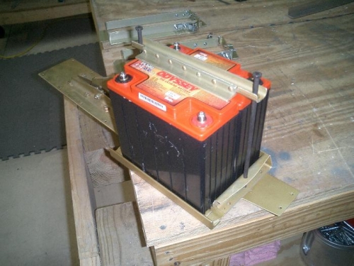

PostPosted: Fri Sep 25, 2009 7:08 am    Post subject: Chargers Reply with quote
It's a pretty easy mod to use a pair of 680's in the stock location. Several of us have done it and you can still use a single contactor if you want.
Michael

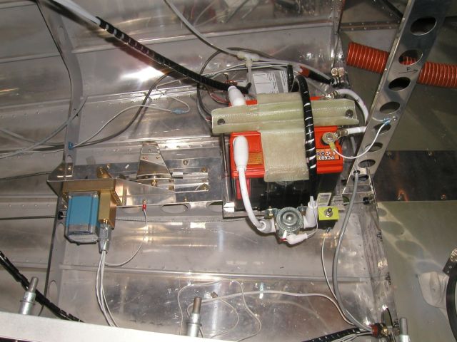

PostPosted: Fri Sep 25, 2009 7:59 am    Post subject: Chargers Reply with quote
here's another alternative
From: owner-rv10-list-server(at)matronics.com [mailto:owner-rv10-list-server(at)matronics.com] On Behalf Of RV Builder (Michael Sausen)
Sent: Friday, September 25, 2009 7:18 AM
Subject: RE: RV10-List: Chargers
Michael
[img]cid:604375515(at)25092009-2283[/img]
 Filesize:  140.3 KB
 Viewed:  14009 Time(s)
 Filesize:  61.28 KB
 Filesize:  57.78 KB
Subject: RE: Chargers
Michael
