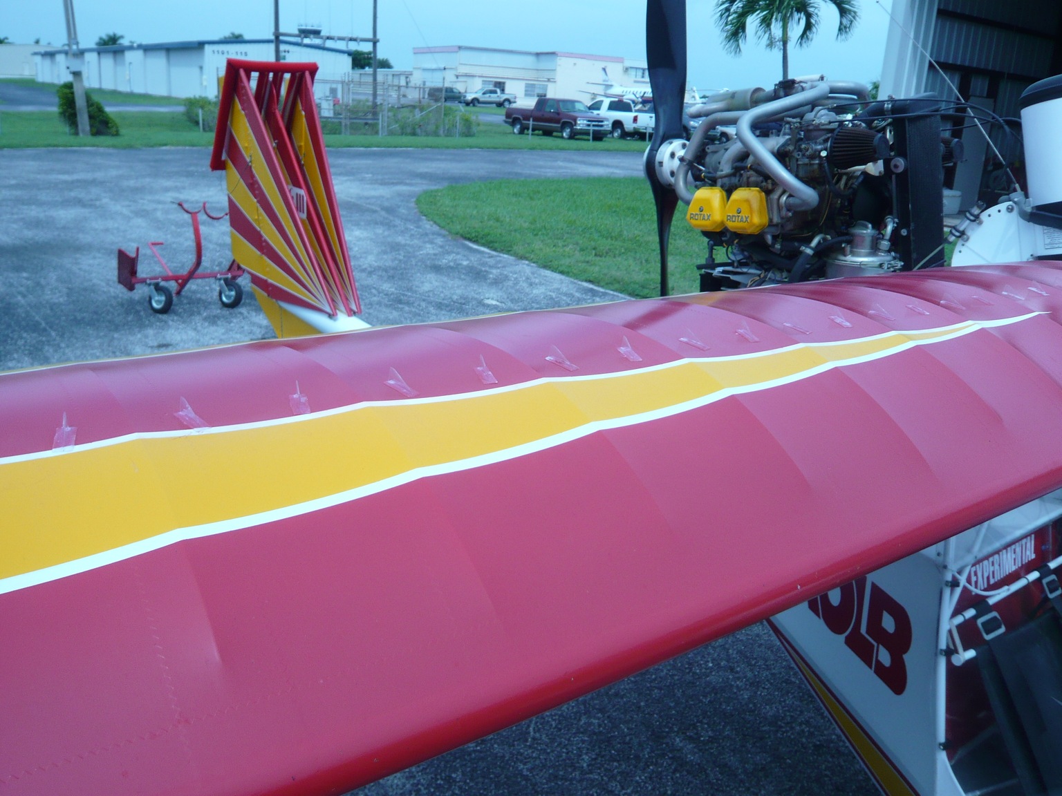

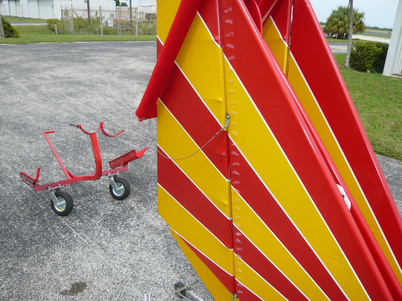

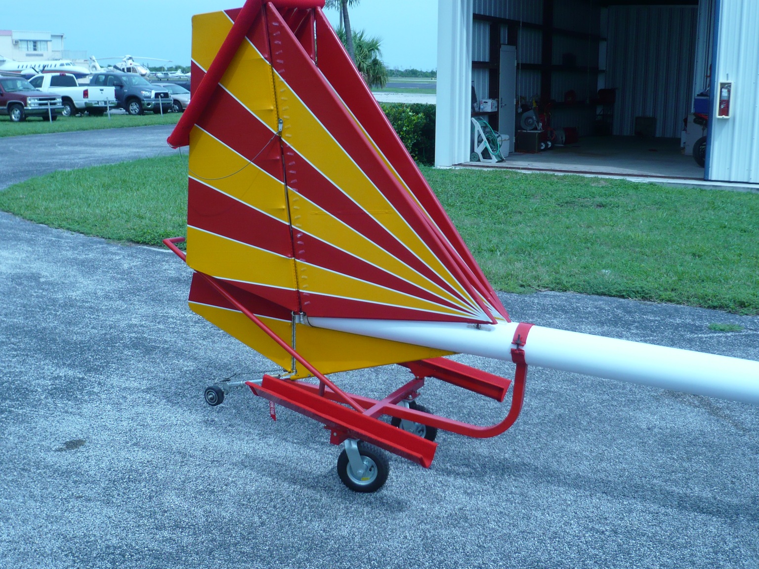

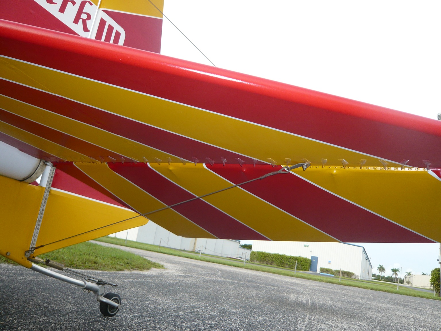

Greetings, Folks,
For what it is worth, here is our experience with Harrison Designs VG’s (Landshorter.com).
Keep in mind that while Jeff and I are licensed pilots, we’re new to the Kolb world, and as non-builders, still ascending the technical learning curve.
Joa Harrison recommends that the VG’s be set in a line in the upper side of the wing back about 10% of the chord from the leading edge. For us, this meant striking a chalk line at 6.5� from the leading edge. We used a carpenter’s square set against the bottom surface of the wing, and measured from the leading edge back 6.5� to where the tape met the curve of the wing. We set the front of the VG’s on this line. We put 50 on each wing, as recommended. Using the paper templates that come with the kit, we made our own set using thin Formica, since it’s inevitable that you get the glue on the template, and paper would last about a minute.
We centered each opposing pair of VG’s between two ribs at the angle prescribed by the template. The VG’s should each be 15 degrees off the airflow over the wing (30 degrees between each pair). They recommend that the spacing be 1% of the wingspan. We spaced the outside front corners of each pair 2.75� apart. We used the Loctite 401 adhesive that comes in the kit. Here’s an interesting point. The bottle came about 2/3 full. I assumed we’d lost a little in shipping, and indeed there seemed to be a little residue inside the plastic bag. I was worried that it would not be enough for the job, especially since we bought an extra set of VG’s for our horizontal stabilizer. I ordered an extra bottle, but never had to crack the seal. We didn’t finish the first bottle.
The recommendation for the horizontal stabilizer is of course, to install them on the underside, just forward of the elevator hinge. I can’t remember how many we used, probably about 30 per side. They’re much closer together, about 1.5 inches as opposed to the spacing on the wing. The kit provides templates for various spacing choices and we made a Formica replica for that, too.
Our 912ULS-powered Mk IIIC has a two-blade, 72� IVO prop.
At 1050lbs, we used to stall at 38kts IAS, no flaps.
Now at the same weight, we stall at about 32kts w/ no flaps.
One notch of flaps decreases it to 25kts.
Departure stalls were impossible, (no surprise) as we ran out of elevator at 35 kts. at 5400rpms, and the Kolb kept climbing.
These speeds are all IAS, so at higher angles of attack, we certainly are getting an increase in error. We didn’t confirm with GPS. However, despite the instrument error, the comparison is favorable.
The stall characteristics are gentle, with a tendency to lower the left wing. I’m not sure if that reflects design tendency or my heavy left foot.
Slow flight (MCA) is comfortable with 38kts. At 3800rpm, w/ good control in shallow bank turns.
Hope that helps to add data to the discussion pool,
Dave and Jeff

Dave Watkins sent me his VG installed photos for me to reduce. I have attached the reduced size files herein.
 Filesize:  714.77 KB
 Viewed:  16715 Time(s)
 Filesize:  415.5 KB
 Filesize:  669.23 KB
 Filesize:  410.58 KB
 Viewed:  16716 Time(s)

I had a chance to fly this morning with the VGs installed as stated in my previous post. Partial results follow:
Before VGs
Clean stall break at 45 mph indicated.
Cruise speed (TAS) 80 mph at 3,000' Density Altitude at 2,640 rpm which is about 62-63% power.
After VGs on wings only, as described previously.
I ran out of nose up elevator at 42 mph IAS with plenty of roll control available. I'll have to install VGs under horizontal stabilizer to hopefully get more elevator function at high AOA so I can find out the new actual stall speed.
I did my normal cruise speed upwind/downwind average at 2,640 rpm today and got 61.4 mph upwind and 98.4 mph downwind for an average of 79.9 mph with VGs. Before I was getting 80 mph at that rpm. BUT today's test was at 1,800' DA (overcast would not let me climb higher) and earlier test was at 3,000' DA. Because of the difference in DA the two cruise speeds are not directly comparable but they are close, probably within 1 mph of the same at the same DA. I will test again, hopefully at 3,000' DA after I get the HS VGs installed.
Conclusions so far:
My home-made VGs located about 3/8" further back than the recommended 10% of chord, definitely reduces the stall speed and apparently results in only a relatively minor reduction in cruise speed at a given engine rpm. I will add the horizontal stabilizer VGs with hopes of gaining a bit more nose up pitch to get an actual stall break at some speed slower than 42 mph.
Subjective results:
Excellent roll control at slowest attainable speed of 42 mph IAS. Softer, slower landing speed with tendency for tail to touchdown first at this slower speed with higher AOA. That will require slight modification of my landing technique to avoid tail first touch-downs. The electrical tape held the VGs on without a problem at 80 mph cruise speed.
My home-made VGs are staying on this airplane! The SS is a fine handling airplane without VGs but better still, in my opinion, with them.
Stay tuned for further updates when the VG installation is complete.

PostPosted: Wed Sep 16, 2009 1:03 pm    Post subject: Re: Vortex Generators Reply with quote
Glad they're working out for you, Thom!
Enjoy,
Dave

PostPosted: Thu Sep 17, 2009 7:57 am    Post subject: Re: Vortex Generators Reply with quote
Dave Watkins, thanks for posting your set up and findings.
I would like to know if you put any VG's in the area past the last outboard rib (in between the last rib and wingtip bow).
Jason
