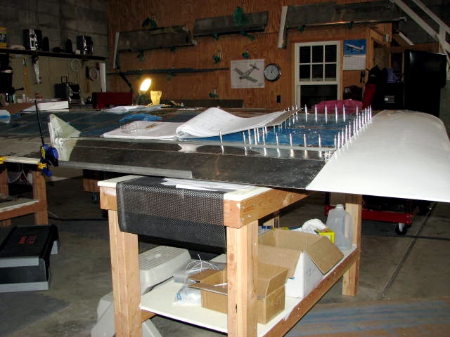

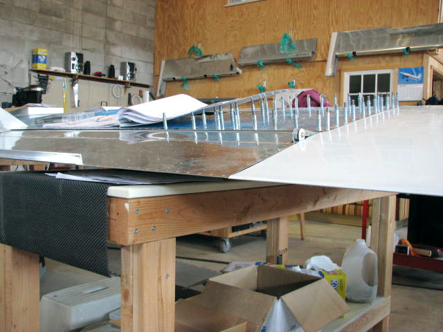

I think maybe some people, early on, match drilled the holes in the wingtip without insuring that the wingtip was solidly in position, as you describe. It would be a bit difficult to hold the wingtip perfectly in position to drill without an extra set of hands. I looked back at some construction photo's and realized that we drilled the wingtips on a table instead of in the cradle. We used a piece of 3/4 aluminum angle to clamp the aileron to the flap. Here are a couple of photo's.
[img]cid:B455C6D0-CFC7-4CE0-B73F-6DAB7009BEB5(at)local[/img][img]cid:9AB06093-2083-4FA9-AF4E-177F247E4C90(at)local[/img]
David Maib
40559
On Jul 2, 2009, at 5:39 PM, Rob Kochman wrote:
I still don't understand how the wingtips can be "aligned."  When I pushed mine all the way forward, it wasn't possible to twist them up or down--they fit in snugly.
-Rob
