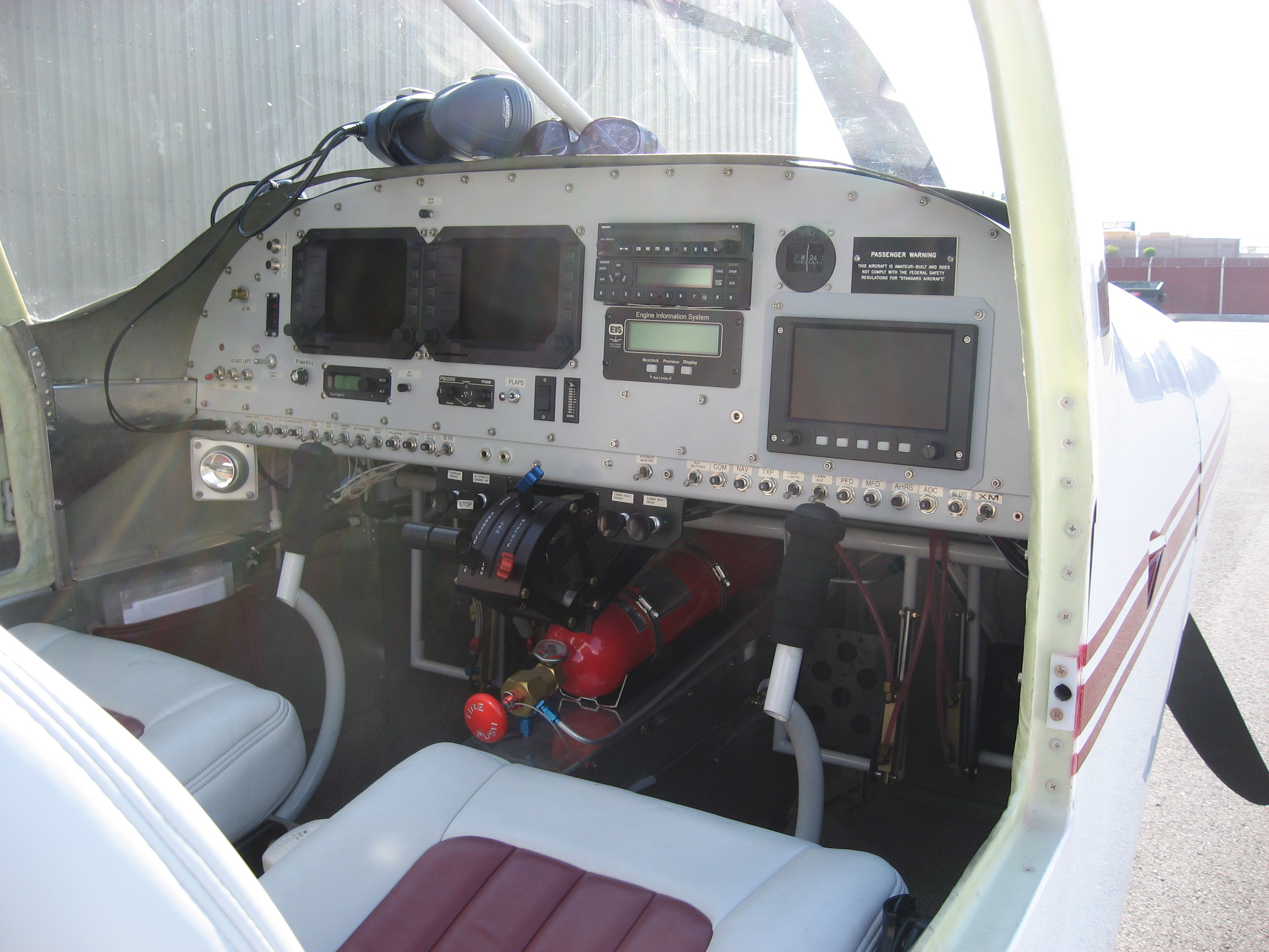

PostPosted: Fri Jun 12, 2009 4:22 pm    Post subject: rear seat crotch strap attachment Reply with quote
Check just below the throttle quad. Note the red handle.

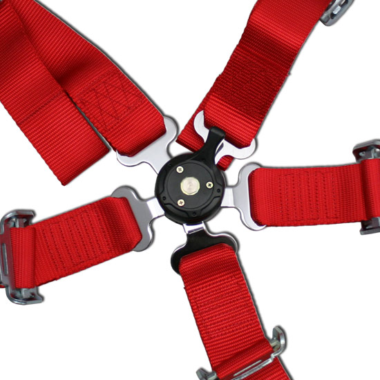

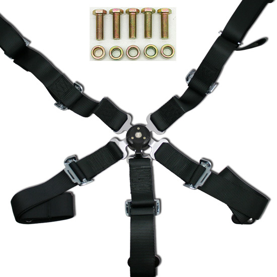

robin1(at)mrmoisture.com
PostPosted: Sat Jun 13, 2009 12:10 pm    Post subject: rear seat crotch strap attachment Reply with quote
John,
I have access to an industrial sewing machine but I initially hand sewed them to tack in place. The webbing is rather course and could be sewn easily. Once tacked in place I dry fit them in the plane and then used a regular sewing machine. it was a snap. If you want a pro to sew it try tacking like I did and take it to an upholstery shop to have them do it while you wait for $20.00.
For the DIYer’s out there one can get a 2” or 3” wide Rotary Cam Release 4 or 5 point seatbelt for under $40.00 delivered from ebay. I think I paid under $30.00 delivered for each of mine. Look up “Cam Seat belt” on ebay. Please note you can make a perfectly good and safe seatbelt set but these are obviously not the quality of a $400-600 Hooker Harness belt.
Other observations. I suggest you but one or two sets to start rather than all 4 sets before one is sure you want to go that way. Additionally there are other belt companies out there that offer “Y” sewn belts already:
http://ep.yimg.com/ip/I/wescoperformance_2053_292106
http://wescoperformance.stores.yahoo.net/racingbelts.html#cam-lock-harness
Good luck,
Robin
