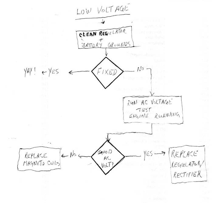

I'd still start with the grounding. All regulators require grounding whether through a wire or through the case.
Assuming your grounding is good put an AC volt tester across the two yellow or yellow and red tracer wires coming from the magneto end of the engine and run the engine. You should see some AC voltage on your meter. In fact you should see a decent voltage ??? 12 - 15VAC.??? If you don't see any voltage there with the engine running you definitely have a problem with the lighting coil in the magneto.
Assuming you have good AC voltage in the two yellow wires then the problem has to be in the regulator. Actuallyu it's a regulator/ rectifier bridge.

I mentioned disconnecting one of the yellow leads so there would be no chance of the regulator loading the lighting coil and giving you a false low voltage. If you are worried about arcing simply use a bit of electrical tape around the connections to the AC voltmeter.
The fact you have continuity between the two yellow wires is good. You can also check for continuity between either yellow wire and the ground...There shouldn't be any.
