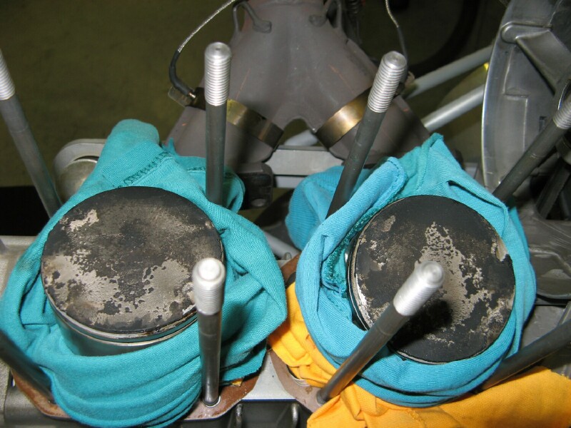

AkFlyer wrote:
My brother was running the pennziol air cooled in his for about 50 hrs. We pulled it down for a decarbon and the rings were close to stuck, with carbon on the heads and piston domes. I talked him into switching to the sea and snow and when we pulled it down after 250 hrs, there was nothing to clean.
Okay, you may have convinced me to switch oil. I am using penzoil now. At the first 50 hrs I had lots of carbon to scrape off the rings and piston tops. I do not have injection on my 503 so premix 50 to 1. I have to taxi about a mile to and from the runway here so was thinking the carbon buildup was from all that low speed taxing with the 50 to 1 ratio.

dave
Joined: 22 Sep 2006
Posts: 1382
PostPosted: Fri Apr 03, 2009 5:39 pm    Post subject: Re: Oil injection conversion Reply with quote
Tom Jones wrote:
Pre mix is a huge contributer to carbon build up as you are running 50 to 1 all the time. on Injection 50 to 1 is only at wide open throttle
Idle could just be close to 100 to 1 with the cruise around 60 to 70 :1 ratio. So, you almost 20 to 35% richer at cruise and almost double what an injected engine is at 2500 rpm
Yeah , you will get more carbon thinking that way.

PostPosted: Fri Apr 03, 2009 6:38 pm    Post subject: Re: Oil injection conversion Reply with quote
Here's a picture of the pistons on my 503 at the first 50 hours. Penzoil premix 50 to 1.
