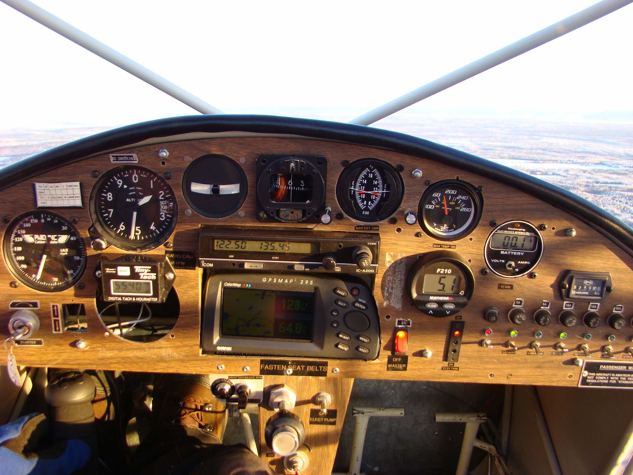

Speaking of fuel flow, I was flying today, and even into a 10 mph
wind at about 90 mph, I was able to twist the throttle back to see
2.9 gph on my Northstar Fuel Flow meter. It's surprising how just a
little less throttle will gain so much in fuel economy.

Lynn Matteson
Posts: 2778
PostPosted: Sat Mar 14, 2009 11:13 am    Post subject: Fuel Flow Display Reply with quote
Saturday morning pedantrics are fine, but I was flying this am. : )
I never thought of flying down-hill to get a better reading....if I
had, I'm sure the "hurry up and dump some fuel overboard...you're
making fuel" light would have come on. : )
I don't think my airspeed is exactly accurate, but I was showing
about 90 on it and on the GPS groundspeed...and at about 2000 ft AGL,
how do I know what the exact wind was? I didn't, but the ground wind
was 10 mph, 30 miles further back when I departed. At the point where
I saw 90 by 90, I was showing about 3.1 to 3.2 gph usage. I twisted
(vernier throttle) the throttle back and saw 2.9 gph usage, and speed
dropped to about 85 by 85. I was trying to slow enough to just stay
ahead of my friend's 150 Cessna, and by slowing this small amount,
the speed dropped, but the gph use really dropped. The tach was
showing about 2700 at 90 mph, and about 2540 when throttled back..(.I
think I have too much prop, as the Jab's cruise speed should be
2750-2950 rpm). I was straight and level at the time. I've read some
accounts of people getting 2-point something with their Kitfox's, and
seriously doubted them, but it just shows what throttling back can
do. I'm happy if I get about 3.8-4.1gph, but if I'm in a hurry to
get somewhere, I'll open it up more but seeing 4.8-5.0 makes me
realize how much of a rush I SHOULDN'T be in. Incidentally, on
takeoff, I'll see 5.8-6.0 gph use, and that's enough to point the
nose down a bit and twist the throttle back some. : )

Flying my brothers model II and a buddies model I and my Avid C I have not seen anything CLOSE to those numbers. at 85 it is closer to 5.5- 5.8 GPH. To get into the low 4s or high 3s I have to pull it back to about 55-60 mph. I checked this over about 300 hrs on the model II and 30 hrs on the Avid.
The attached pic shows the fuel flow at ~80 IAS and a fuel flow of 5.1

negative ghost rider... little thingy below and to the right of the fuel flow is the electric elevator trim indicator lol.
I think part of my issue is that I am towards the forward CG. I am moving it back to 18" and gonna try that. Dean Wilson said it will make a huge difference in the flight performance, for the better... now I wonder what would happen if I clipped the wings to 26' and moved the CG to the aft edge of the wing......... sorry, had to put that in there.. I have been good lately and that just aint right for a snake oil salesman
