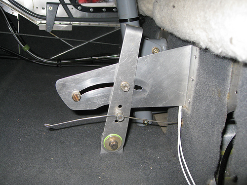

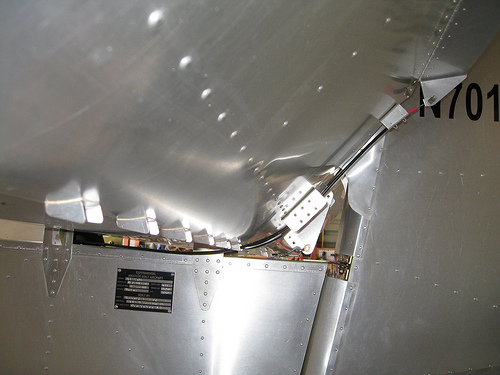

Here are pictures of my manual elevator trim on my 701. Sorry it took so long to get them posted. I couldn't get the photos on here so just go to this link. http://www.flickr.com/photos/mlee08/

PostPosted: Thu Mar 12, 2009 3:25 pm    Post subject: Re: 701 elevator trim option Reply with quote
Ron,
I really like it!
Looks like you have electric flaps?
Kevin

PostPosted: Thu Mar 12, 2009 6:33 pm    Post subject: Re: 701 elevator trim option Reply with quote
with apologies to Ron,, her is what the link shows.
