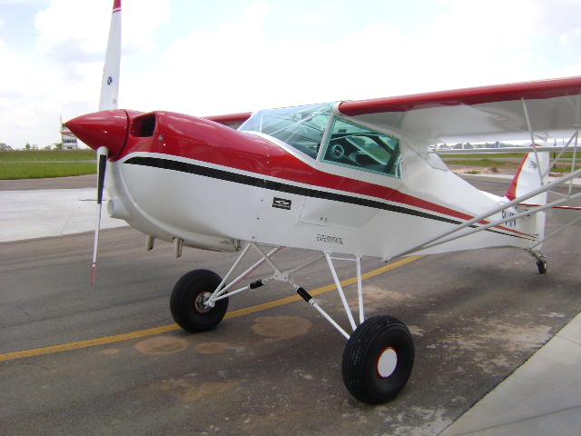

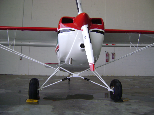

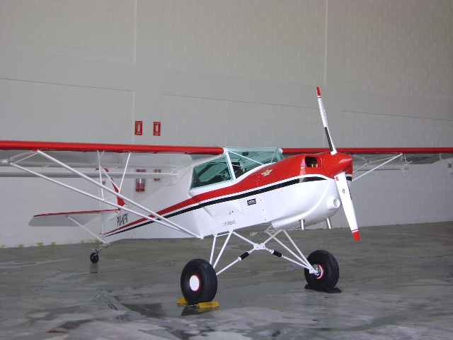

As I see it, the 11 lbs he added to the previous 15 = 26, so the 18
lb difference had to come from the wheels now being a bit further
forward.
Lynn Matteson
Jabiru 2200, #2062, 605 hrs
Sensenich 62x46
New skis off last week...5 minutes, and probably back on this week...
10 minutes, as it's snowing right now.
On Feb 21, 2009, at 2:49 PM, Noel Loveys wrote:
I checked the last W&B Francisco sent and the new gear is actually
2 Lb per
main leg lighter. The weight on the tail wheel has increased from
15 lb. to
44 lb. tare. I have asked him to send his weight and the arm of
his seat
and the arm of his wing tanks so we can figure out an operation
envelope for
him. I expect if he is anything over 150 lb. the lightest load
will be with
a CG of around 12 - 12.5 in. Gross should be around 14-15 in.
that's a lot
better than it was. I'll bet he'll find it a lot better plane
landing. Can
you imagine trying to recover from a stall in a plane with such a
light
tail?
Noel
Lynn
Kitfox IV-Jabiru 2200
N369LM
dcubj3(at)terra.com.br
PostPosted: Sat Feb 21, 2009 1:08 pm    Post subject: new bush gear Reply with quote
Lynn, this is correct!!!
Original tailwheel weight: 15 lbs
With new "bush landing gear"
( Main wheel axle is 4" closer than datum )
New tailwheel weight: 33 lbs
MORE 11 lbs = 44 lbs
44 lbs is 5% of total weight (883 lbs), as your instruction " very useful
information"
Tks very much!!!
FD
www.dcubj3.com.br

PostPosted: Sat Feb 21, 2009 3:09 pm    Post subject: new bush gear Reply with quote
Mr. Noel:
With pilot e co-pilot I can use 80% fuel tank. equiv 80 litres only (not
total)
In this case, with 40 lbs of bagagge, total weight is almost 1.300 lbs
FD
www.dcubj3.com.br
Lynn
flight level from bottom door, yes!!
I add 11 lbs in tailwheel
With this, 5% of weight in tail, as I read in msg
Tks

PostPosted: Sat Feb 21, 2009 5:19 pm    Post subject: new bush gear Reply with quote
Dick,
Can you send me a photo of your door latching mechanism. Thanks. Jeff Classic IV KTZR
PostPosted: Sat Feb 21, 2009 5:47 pm    Post subject: new bush gear Reply with quote
Noel:
With this gear landing is perfect, like J3 (better)
Before change, landing was dangerous, now is great!!
Less weight, axle more closer than before (4 inches), 5% weight on tail
Landing become perfect!!!!
FD
www.dcubj3.com
