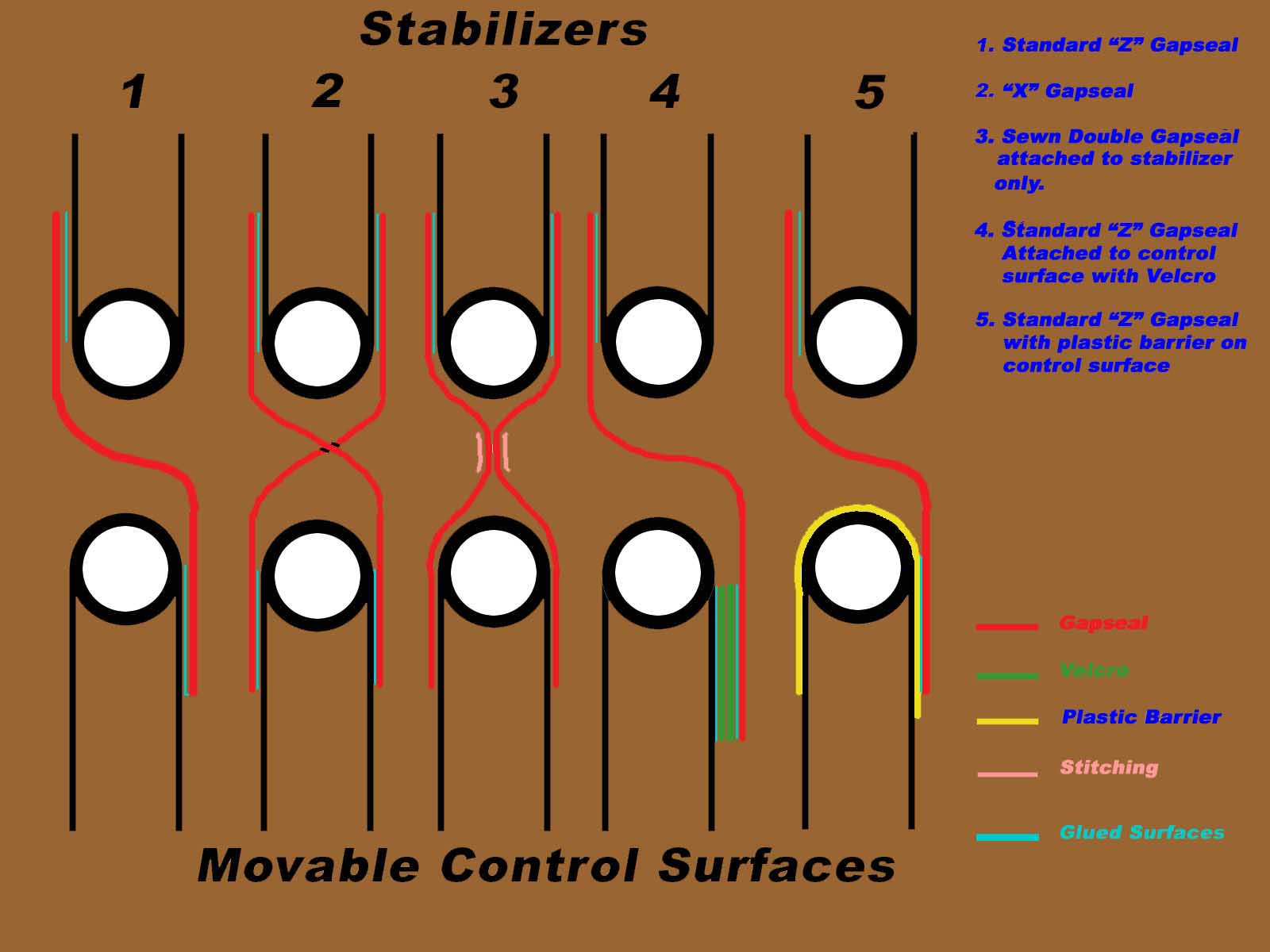

do you have a picture or drawing of the X system?
Second inbibation is starting to cut in and I'm having a problem visualizing your X setup.
Noel

If you really want to drive yourself nuts over this gap sealing issue, try the
"X" method instead of the "Z" method. We used the
"X" method on our model planes.
The "Z" method has been explained....from under (or over) the
trailing portion of the hort. stab, to over (or under) the leading portion of
the elevator, forming a "Z" when view from the side. The "X"
method is just alternating the placement of lengths of 2" wide tape, over
and under, then under and over, etc., until the gap is sealed. In the
"X" method, you make strips of tape that go, say, 2" wide and
from front to back, instead of the "Z" method where you run the tape
from side of elevator to hinge, then hinge to hinge, and so on.
The jury is still out on whether this is a good method or not...how 'bout
some thoughts?
As an aside, when this method is used in model planes, no hinge is needed, as
the plastic covering material itself is used for the "gap seals" and
in using the "X" method, the elevator operates freely without the use
of hinges...not recommended for "live-in" airplanes.

Nope, no picture or drawing. Just visualize...after the inbibation
wears off....the flat surface of the stab and elevator, as viewed
from the side/edge, with the tape starting on the top left, and
crossing to the bottom right. (This of course assumes that you have
properly made the tape with an inch of the sticky surfaces against
each other so that the tape can be stuck down on the top left and
the bottom right) Now another tape from the bottom left crossing to
the top right. Where they pass by each other, they form an "X". Then
imagine a piece of tape 2" wide being placed from top of stab to
bottom of elev. (top left to bottom right), and next to it another
tape placed from bottom left to top right. Continue alternating tapes
until gap is sealed. I can imagine how this would look on a full-size
plane, and I don't like what I imagine. It worked fine on the models
and looked ok, and made an especially lightweight hinge. I personally
don't like the idea of this "over and under" tape application, as it
always leaves a place where junk can collect, no matter which way you
do it. I much prefer to let the elevator hang down, apply the tape
across the gap, and leave it at that. I use "racer's tape" that I
ordered in orange, which is the color of my plane in that area...the
color is not a perfect match...however, I can't see that mismatch
when I'm flying and neither can anybody else. The owners of "hangar
queens" would not like my reasoning, I'm sure.

So has anyone thought of applying tape top and bottom with the adhesive
fully contacting each other in the gap? Something like this: >-<
It would be very difficult to do well unless you could design and
fabricate a special tool, but I think it could be done. I'm imagining
careful measurement of your gap and tape width then positioning the tape
on one side correctly such that it would allow the other side to be
applied and close all of the gap with no significant spaces or air bubbles.
I think a perfect tool might be a stiff rubber block shaped to follow
the half cross section of the intended gap seal. After the 1st side of
tape has been applied (bottom?) then the block could be clamped on that
side to hold the applied tape in the proper shape it would retain for
the gap if the other side was already installed. Then it should be
possible to lay the upper tape like positioning a large pre-cut decal.
Here's an attempt of a drawing of the cross section with the tape red,
block shape in black and a clamping bar in green.
Gap seal image
Anybody following my attempt to describe this concept?
Rex Hefferan
Colorado M2/582
> issue, try the
> portion of
> over
> 'bout
> some thoughts?
> needed, as

I'm following you, Rex...I just don't see the drawing, just the >-<
that you typed in...and that's basically what I tried to describe
with the top left-to-bottom right explanation that was confusing me,
let alone others. But why any tape at all, if a rubber/neoprene/
whatever block could be made that would fill the gap and be wedged
into place, loose enough to allow movement, but not blow out?
Something shaped like two "C's" in cross section, back-to-back with
an "O" between them, more or less. The tops of the "C's" could be
tangent to one another if that wouldn't make the device too stiff and
want to pop out of the gap. It could be made of extruded rubber and
sold by the foot.

Here's an attempt of a drawing of the cross section with the tape red, block shape in black and a clamping bar in green.
Gap seal image

Sunday afternoon and I can visualize the X system easy now... Friday nights
not the best night of the week for me;-).
I agree the X system allows for a light hinge on a model but a place for
grass and leaves etc. To catch in the "Real thing".
What I was thinking at first was a couple of pieces of say 2 1/2 inch tape
sewn right down the middle and then one half of each tape doped to the
stabilizers with the other halves just finished to match the plane. They
should be stiff enough to seal the gaps in flight. I'll attach a couple of
rough diagrams... emphasis on the term rough!
