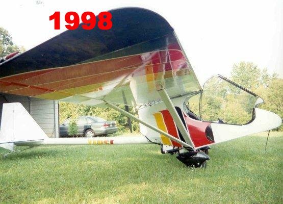

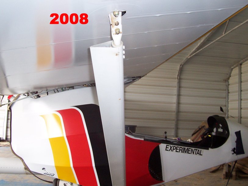

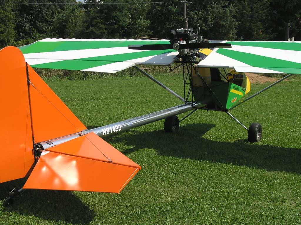

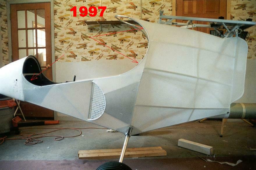

PostPosted: Fri Jan 23, 2009 8:26 pm    Post subject: Fabric rubbing on cage tubes Reply with quote
At 08:07 PM 1/23/2009, you wrote:
Cristal- I happened to look at my cage tubes today, and noticed a
flat spot worn on one of the aluminum tubes.
I don't think you should have had a problem if it was done right to begin with.
You glue the fabric, shrink/iron the fabric.
When you dope or seal the fabric, put on the reinforcement tapes,
spray the silver & paint,
it pretty much goes thru the fabric & cements it to those tubes.
Least that's what I thought.
Mines 11 years old.
 Filesize:  82.55 KB
 Viewed:  474 Time(s)
 Filesize:  48.94 KB
 Viewed:  446 Time(s)
 Filesize:  66.84 KB
 Viewed:  494 Time(s)

PostPosted: Thu Feb 19, 2009 7:10 pm    Post subject: Re: fabric rubbing on cage tubes Reply with quote
As an alternative, brushing polybrush and polytone with a paint brush instead of using a sprayer works pretty well. I painted everything on my Firestar wings with a roller and paint brush. It's not messy and there's no concern about over-spray. It makes adding patches and repairs easy.
Ralph B
