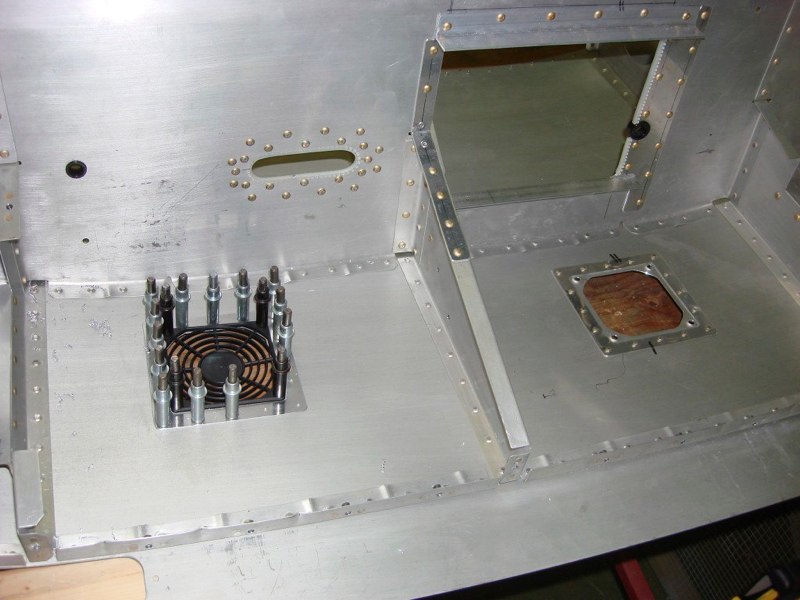

PostPosted: Wed Apr 22, 2009 6:39 pm    Post subject: Defrost fans Reply with quote
Before you permanently mount the front glare shield, you might consider
several large 5" by 7" access panels on it. They can be covered using
plates, nut plates and cap screws (for easy removal). A defrost fan can be
mount to the back of an access panel. The plate can be flat for fan
installation purposes. You will need these access panels unless you like
lying on your back with the seats removed to service avionics. I can't find
my current pictures of same but they are located one on each side in front
of pilot/copilot.

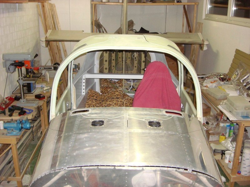

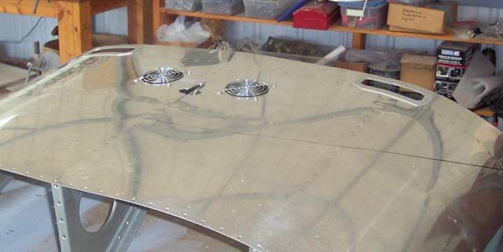

PostPosted: Wed Apr 22, 2009 11:09 pm    Post subject: Re: Defrost fans Reply with quote
Here is what I did. you'll find more on my new webpage under panel-work.
Cheers
Michael
 Filesize:  114.51 KB
 Viewed:  11717 Time(s)
 Filesize:  83.72 KB

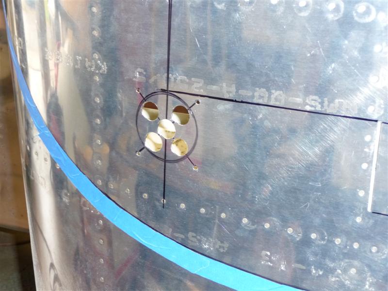

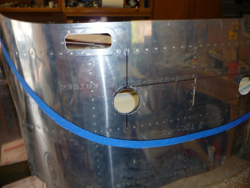

PostPosted: Thu Apr 23, 2009 4:15 pm    Post subject: Defrost fans Reply with quote
I used a fan as a drill guide and drilled the four mounting holes. Then I
traced a circle pattern with a sharpie, drilled a pilot hole or four inside
the pattern, used the cheapy harbor freight body saw to rough cut up to the
line then cleaned up to the rest of the way with the dremel tool and/or
jewelers file. It went pretty quick and looks great sitting in the garage
buried in fiberglass dust.
-Ben Westfall

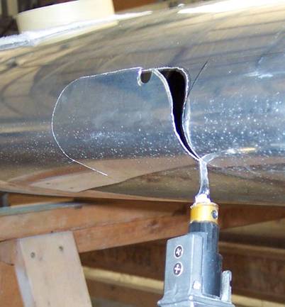

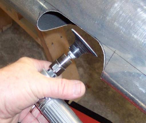

PostPosted: Thu Apr 23, 2009 4:50 pm    Post subject: Defrost fans Reply with quote
Agreed. Should not be any different than leading edge HID landing light openings with the exception of greater curvature.
Robin

MauleDriver(at)nc.rr.com
PostPosted: Thu Apr 23, 2009 6:06 pm    Post subject: Defrost fans Reply with quote
Great pics! I just want to add that I did the same cut for the HID per
Tim, using the same HF tool. That was the hairiest procedure I've done
on the plane to date... and that was 2+ years ago. WooHoo! I mean that
curve seemed to me to be the minimum possible with that saw and that
blade. It's a crude, noisy, vibrating, non-featherable tool. So the
greater curvature for the fan is a good thing.
In retrospect I should have done the same for the fans. But if you are
doing the cut for the HIDs, eat your Wheaties first. I'm still a bit
shaken by how close to disaster the whole process was. But it turned
out well. I'd probably use my die grinder and some files now. I've
learned to love files.
Really great pics. I would have used a drum type sander on my die
grinder. I don't use the flat face sander as much as I should. Both
sanders are handy tools.

PostPosted: Thu Apr 23, 2009 8:07 pm    Post subject: Defrost fans Reply with quote
Here are the pics of the work in progress. I didn't seem to take any
pictures of the finished product. For those that plan to use the body saw
and are worried about that tight corners use your step drill to open it up
so all you have to do is cut straight lines. I know I did that but damned
if I can find a picture.
I do remember thinking "am I really going to cut into this perfectly formed
leading edge?" I think I backed off with the drill about 3 times before I
could work up the nerve.
Ben Westfall

PostPosted: Mon Apr 27, 2009 6:09 am    Post subject: Defrost fans Reply with quote
Any computer supply place. They are 80mm computer fans.

Where are you guys finding these fan motors? I've looked in Aircraft Spruce and another spot and can't find them

PostPosted: Mon Apr 27, 2009 6:22 am    Post subject: Defrost fans Reply with quote
Any computer supply company should carry some. I got low noise ones, but can not remember where.

PostPosted: Mon Apr 27, 2009 6:37 am    Post subject: Defrost fans Reply with quote
Danny;
Computer fans. Can get them all over the internet or computer warehouse
if you live near one.
Dr Fred.

PostPosted: Tue Apr 28, 2009 7:55 am    Post subject: Re: Defrost fans Reply with quote
or here: http://www.parts-express.com/pe/showdetl.cfm?Partnumber=259-125%20%20%20%20%20%20%20%20&FTR=computer%20fan&CFID=9010675&CFTOKEN=83489149
Lots of fans + cool looking metal grill cover...
http://www.directron.com/fangrill80bb.html
