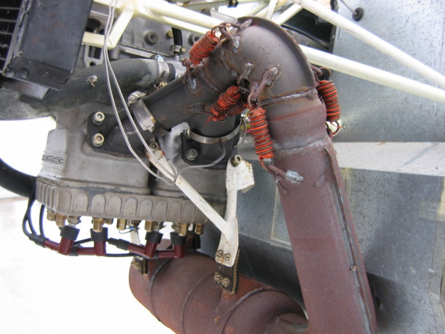

I use the flapperons (about 10 degrees or less) for nose down trim at cruise speeds (60-70 mph). As power is reduced, flapperons return to neutral. With no flaps and cruise power, airplane will climb. My CG is dead-center of the range.
You must get egt gauges Bob. With a 2 stroke, it is probably the most important engine instrument on your panel. It will tell you immediately if mixture is too lean (High egt) and prevent melting holes in your pistons. Checking the color of your plugs frequently will also tell you alot about fuel burn (lean-rich). You're shooting for a light brown color. No black soot (too rich) or gray ash (too lean). Mike Stratmann wrote a good article ("Part 9") on reading plugs. Check it out at:  http://www.800-airwolf.com/articles.htm

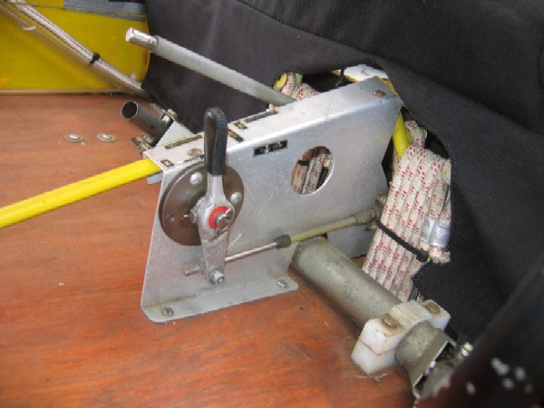

I have no "notches" on my flapperon lever. It's a continuous range from 0 to a stop at about 15 degrees which, I think, is where the "flaps" begin to interfere with operation of the ailerons.
I'd like to see your tab set-up. Is it like the one on the Euro-Fox?

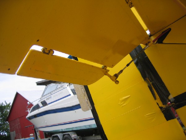

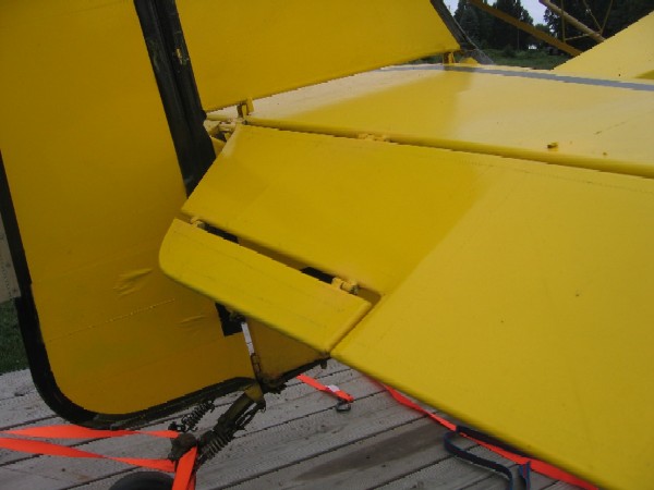

PostPosted: Tue Sep 30, 2008 3:10 pm    Post subject: 582 Oil Reservoir Reply with quote
Lucky for you I already have some pix I had sent to another poster off-list 'cause it's pissin it down out there at the moment Wink
I haven't seen the one on the Euro-Fox but I do know the UK Fox has a lot of mods to the original kit. I seem to remember the normal (US) flaperons are meant to be limited to around 23 degrees but I might be wrong.
The picture of the "console" shows the continuous horiz tab setting nearest and the flap handle (with the release button on top) is on the far side, set for zero flaps in the picture. I never use full flaps until I am lined up on final, at that setting it is easy to run out of roll correction if a turn is too steep on base to final. Had it happen a few times early on!

EGT gauges - I looked on AircraftSpruce.com and there is a wide range of types and prices. Can you (or anyone on the list) give recommendations for my gray head 582 please. Also - what sensors and where do they mount?
I use the Grand Rapids Technologies EIS system for engine data. I love it as it has an alarm system that whacks me in the head (visually) when my EGT's go over red-line; (or anything else for that matter.)
The easiest EGT probe to install would be the P-110 hose clamp mount. Mine are P-111 mounted via a 1/8" NPT to 1/8" compression fitting screwed into the exhaust manifold. Check your exhaust manifold. It should have two bosses welded on the top or bottom about 2" from the engine flange. These are for the EGT probes.

thesupe(at)hotmail.com
PostPosted: Sun Oct 05, 2008 8:04 pm    Post subject: 582 Oil Reservoir Reply with quote
Sorry if someone beat me to the answer C but picture a Y  The holes are in the two upper arms of the Y.   The probe goes through a hole in the hoseclamp C into the hole in the Y and the clamp is tightened arould that arm of the Y.  Same thing on the other upper arm of the Y pipe.  Hope that makes sence.  If you saw it it would be obvious immediatly.  Jim Chuk  4 building MN

PostPosted: Mon Oct 06, 2008 4:47 am    Post subject: 582 Oil Reservoir Reply with quote
I can picture the clamp (attached)

matronics(at)bob.brennan.
PostPosted: Mon Oct 06, 2008 4:58 am    Post subject: 582 Oil Reservoir Reply with quote

PostPosted: Mon Oct 06, 2008 5:20 am    Post subject: 582 Oil Reservoir Reply with quote
I should have thaought about haveing pictures that show this last night C but better late than never they say.  This was a picture of my Avid  MK IV with 582 before I changed it to the Jabiru engine.   Also C look at the probes in a catalog C they come installed in the hose clamp from the factory.  Jim Chuk  Kitfox 4 building  Avid MK IV flying  Mn
PostPosted: Mon Oct 06, 2008 6:08 am    Post subject: 582 Oil Reservoir Reply with quote
That is how I pictured it Jim, although maybe a bit closer to the cylinders, not that it probably matters.
It looks like there is some discoloration at the probe holes, probably from exhaust escaping? That's why I was thinking a bit of manifold goop-sealer-stuff might be a good idea(?)
Also - is the picture upside down or the engine?
