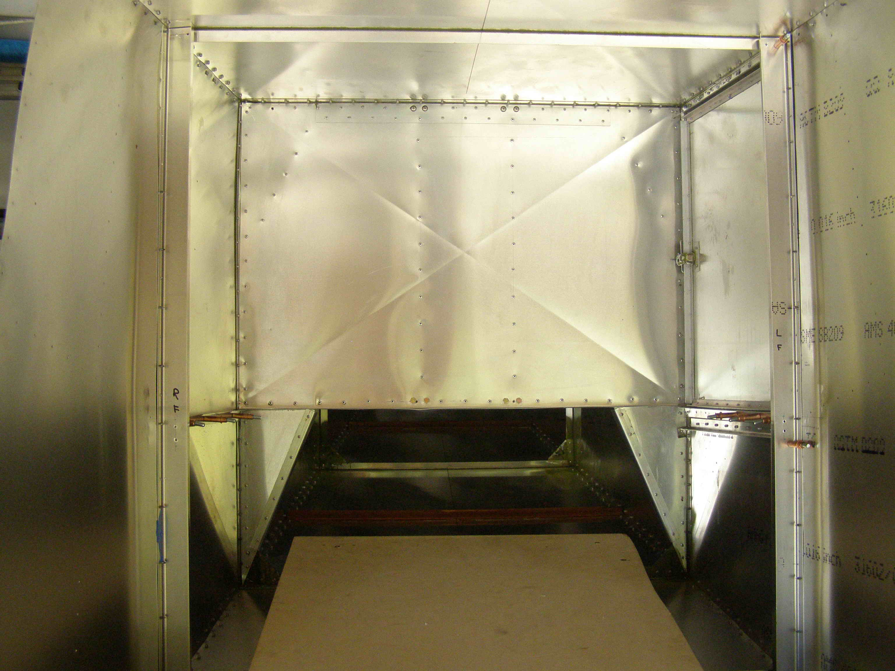

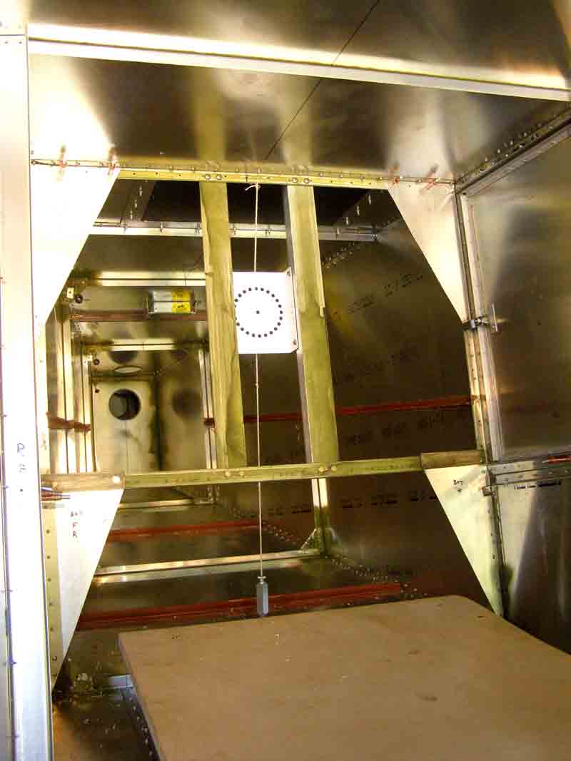

PostPosted: Mon Sep 22, 2008 6:11 pm    Post subject: After 5 hours flight time, questions Reply with quote
Thanks guys for the advice regarding sending pics through matronics.
I have attached two pictures taken during the construction of N67MG that show the reinforcement to the baggage compartment back wall used to support my BRS chute. The reinforcement consists of some big gussets with Ls on their sides, and horizontal Ls top and bottom. The heavy vertical Ls close to the center hold the chute.
Also, see the full-height cargo door on the pilot side of the compartment in the pictures. I can get my 20# folding bike through this door and have cargo nets forward of the door so nothing heavy falls to the back.

PostPosted: Thu Sep 25, 2008 4:55 pm    Post subject: After 5 hours flight time, questions Reply with quote
I had my BRS mounted similarly to where your is, only on the front side of the firewall. The DAR warned me that the CG would be too far back, and although the plane was well built and perfectly safe in every other way, he insisted that the BRS be taken out and weight added forward before the first flight! Being stupid and stubborn, I thought I knew better and flew it like that, and though I hate to admit it, I almost paid a heavy price for doing so! The plane was almost uncontrolable at low speed, and I finally got it on the ground, but when it slowed during the flare the nose took off like a homesick angel and then slammed down on the turf, flattening the front fork. I made several passes at the runway, using every bit of skill I had gleaned from 3,000+ hours of flying everything from ultralights on up. When it slowed down the nose raised, the tail dropped and it became so sluggish it was virtually uncontrollable! Very unsafe, at least in my airplane!
I now have it mounted immediately behind the pilot/copilot seats, so that one can use it as a head rest. I also moved the battery forward to the front of the firewall to try to move the seriously aft CG forward. Now it flies OK, but I'd be really concerned about the placement of your BRS!
The only thing I had changed in the tail to move the CG backward was X braces made of L angle aluminum as an anti-oil-canning thing, but this probably wasn't of too much consequence. Basically the placement of my "safety" chute almost became a "killer" chute.
I hate to admit how stupid and arrogant I was regarding the CG, but if it saves someone else from making the same mistake, what the heck........

My 701 with a Rotax 100HP and a BRS behind the baggage compartment weights 650# and has an empty CG of 374cm behind the front of the slats. (500cm is max.)
