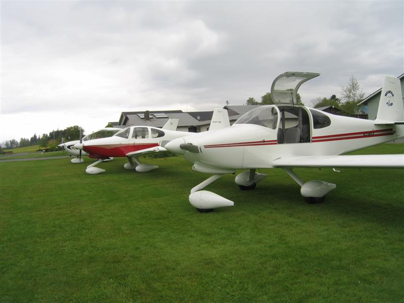

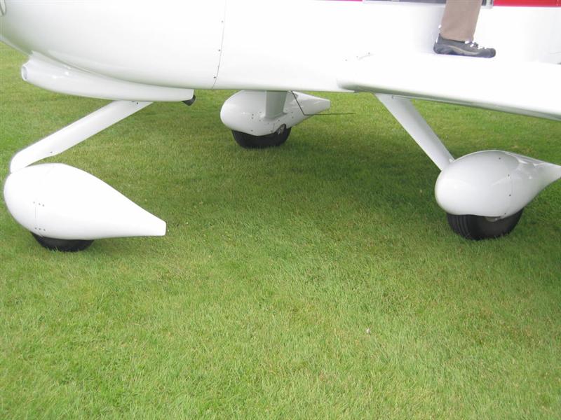

William,
No need for delicacy. Yes, some of the observations are from discussions
with John C, but not all and certainly not ominously. John's perspective is
widespread and quite well informed. What he does so often is point to
something that needs more thought and thus more input and research by us
all. His observations are something that you can accept or discount, as you
will, but at least they are there.
The point of the original post by Dave was to start a thread of enquiry,
mine was to expand it a little. There are others out there who know vastly
more than I do about such things and who might even have some data, but none
of this is noise. These are questions and points of observation which worry
me. If you have evidence that can allay my worries, as you presented below,
I thank you, otherwise your response lacks as much substantives data as my
questions.
Tim James, did not add bush tires to an RV-10, period, nor did I say such.
His use of the C206 gear and larger tires, as well as GlaStar type winglets,
VG's, etc. was to purposefully enhance the -10 for short, rough field use.
Those mods are for Tim something that makes the already good plane more
useful for his needs. Not dumb at all; in fact, just the opposite. The
roll cage goes along with his needs, and, according to Dave Saylor and you,
probably not that necessary. An interesting addition, however, and one
worth some consideration. What unintended consequences did you have in your
mind's eye?
Improvements to a good design are what makes the experimental community so
valuable. Dialog, that which raises a question and the subsequent answers,
negative and positive, are what's needed to hash out good or not so good
ideas, to move forward, to innovate. Many, besides John C, have taken issue
with the window install and tried different alternatives. The innovative
new rudder pedals from Paul are the type of product that makes the plane
that much more refined. The original door design must have come about due
to some compromise or another, otherwise why would any aeronautical engineer
purposefully put a flexing door on a flexing cabin top, all conducive to
unwanted opening, without the addition of a double security point and the
ability of the relative wind to hold the door closed? I do not reject the
RV-10 because of this, it is just a flag for me to watch and pay attention
for other compromises. There should be no need to worry about a door coming
open in flight, no need to have to double check if the passenger door pin is
engaged. We can certainly do so and move on, but the original design will
continue to remain unsound until others come along with better door latches
and other mods to help alleviate the potential and very real problem.
But enough. No wonder there is a tendency towards the center.
Anyway, all those at OSH, have fun! Keep the pictures coming!
William, thanks for your input.
John J
