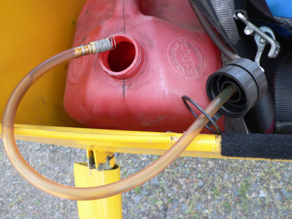

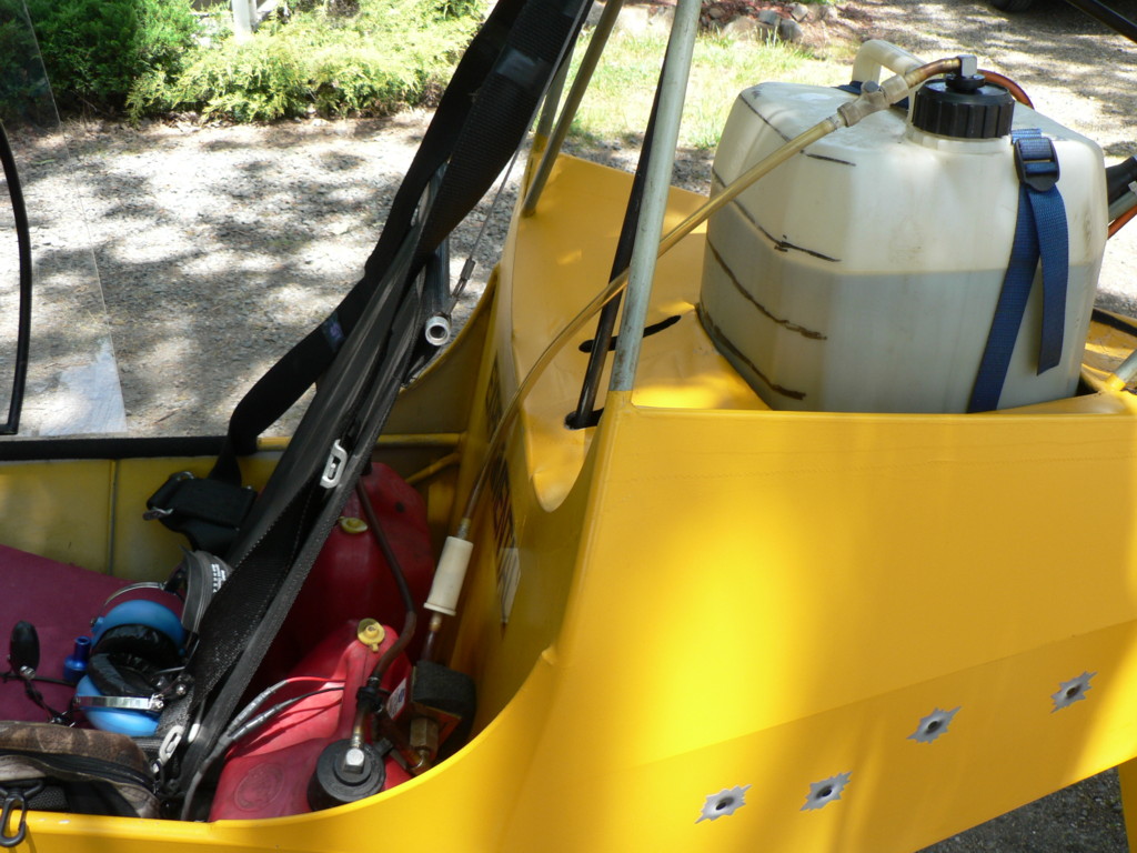

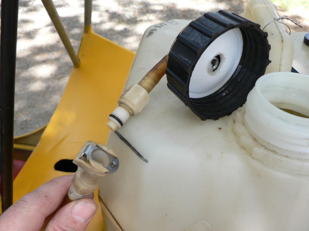

George:
Here are some quick shots of my setup. I'll be using it to fly 356 air miles to the Rock House this Wednesday to meet up with John H, John W, and Larry and Karen Cottrell.

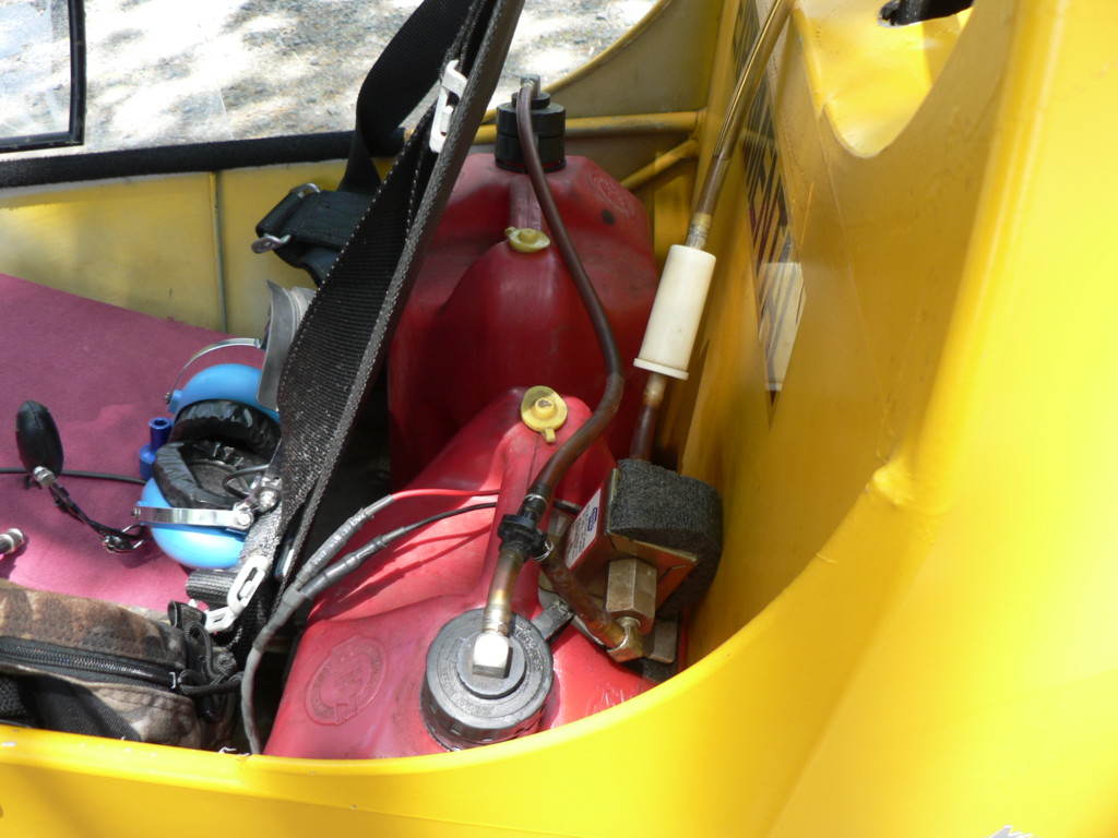

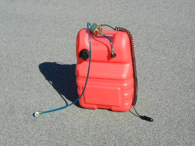

| Quote: | Before I built the 20 gal. aluminum tank for my Mark 3, this is what I used. It is a boat tank with the clunk/filter hose extended to reach the bottom of the tank when standing on end. The fuel pump is a faucet. I used it to transfer fuel in flight. It strapped into the passenger seat. I made a fitting that screwed into the 3/4" pipe thread in the cap of the plastic 5 gallon tanks. This fitting also provided a vent for the tank that I was pumping into.

Hi Steve...
VERY NICE ! Thats exactly what I want to make..
BTW I like the way Rodger Velcros his pump to his can...
Did you install a in line switch to power the pump or
is it just plug and play?
How long did it take the faucet pump to transfer the 5 Gallons ??

Mark,
I never timed the transfer but the pump is rated at 30 GPH so 5 gallons should take about 10 minutes. If you're close to East Tennessee, $35 will get this one. I no longer need it. If I remember correctly I used Adel clamps to mount the pump to the handle of the tank.

Thanks, great pics of good ideas.

The tank is from Walmart, the fuel pump I bought from Aircraft Spruce.

| knowvne(at)aol.com wrote: | Rodger NICE idea...
And Its a good thing your Main tank is elevated
Them bullet holes up the side could have messed up Christmas hahahaha
Thanks for the pix..
mark
Mark,
The main tank is sitting on the boom tube. It is an 8 gallon tank out of a Sky Ranger kit. They are under $30 and VERY sturdy. They are 1/2" fatter on the square than the standard tank and quite a bit taller. I had to move the 1/4" crossmember that holds the forward side of the tank to fit it in, but it was worth it for the extra few gallons. As for the bullet holes... You should have seen the other guy .
I'm all packed up, fueled up and headed to the Rock House in the morning. Even with twelve gallons usable, the last leg is a little iffy if the wind kicks up. Maybe I'll hang some bullet shaped tanks off of the struts for next year.
