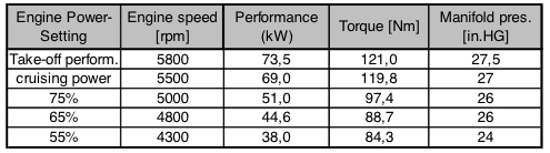

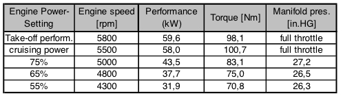

Giles,
You are correct in that there are many combinations of mp/rpm that will produce equivalent power, which is as you stated, limited by atmospheric conditions in a normally aspirated engine. That is why Rotax provides tables for the operators that show the most efficient combination of mp/rpm to achieve standard power outputs of 55%, 65% and 75% of max.
What is interesting to me is that the combinations Rotax recommends are markedly different for the 912 and 912S (80 vs 100 hp) engines. See attachments for these tables. Your statement that higher MP vs rpm combinations are more effecient is evident most of all in the 80 hp engine table.
Without looking at the Katana manual, I don't recall if the particular mp/rpm combinations shown in their table are the same as recommended by Rotax. If not, then perhaps there is room for improvement in fuel flow by conforming to the Rotax recommended settings.
