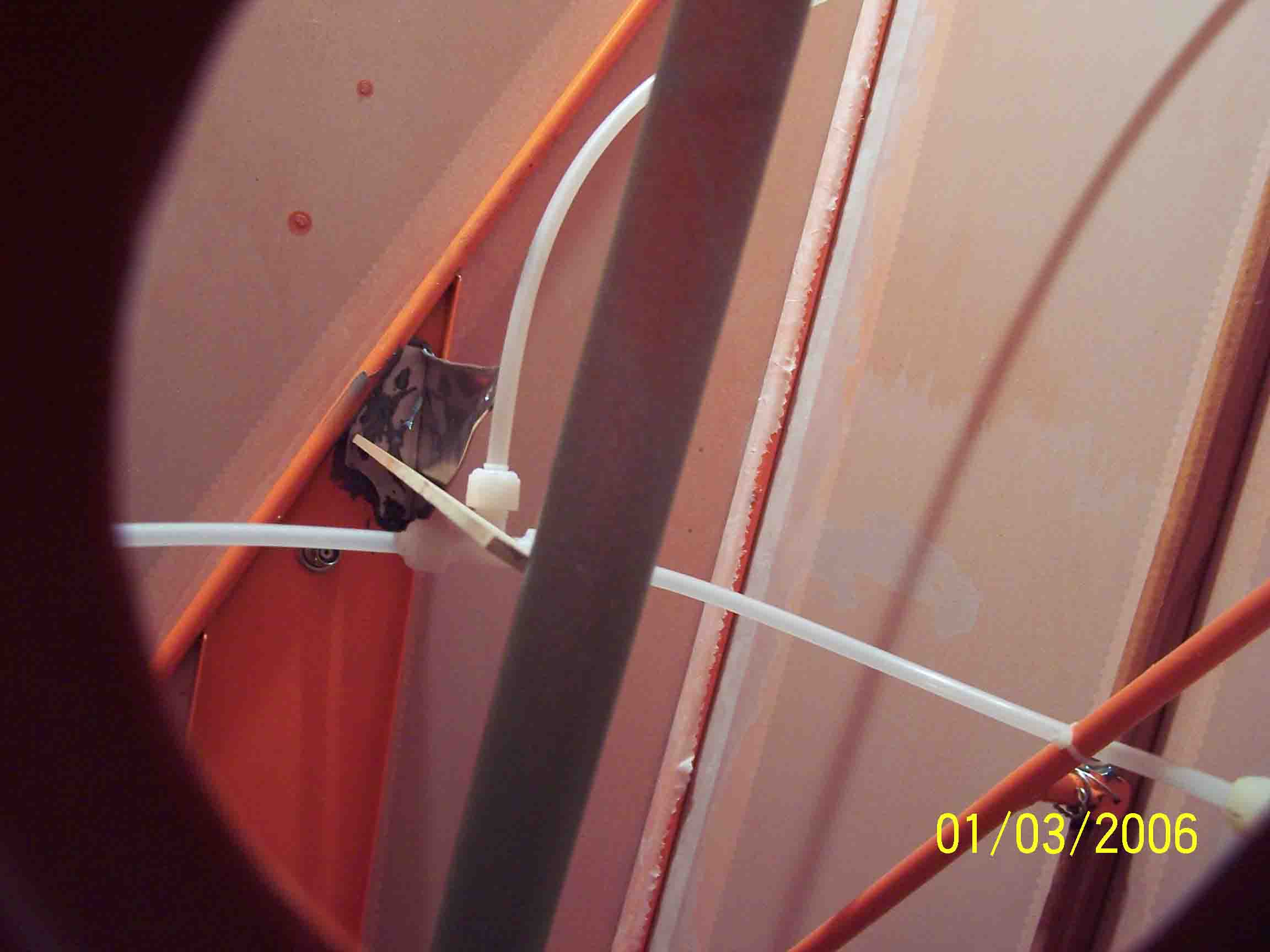

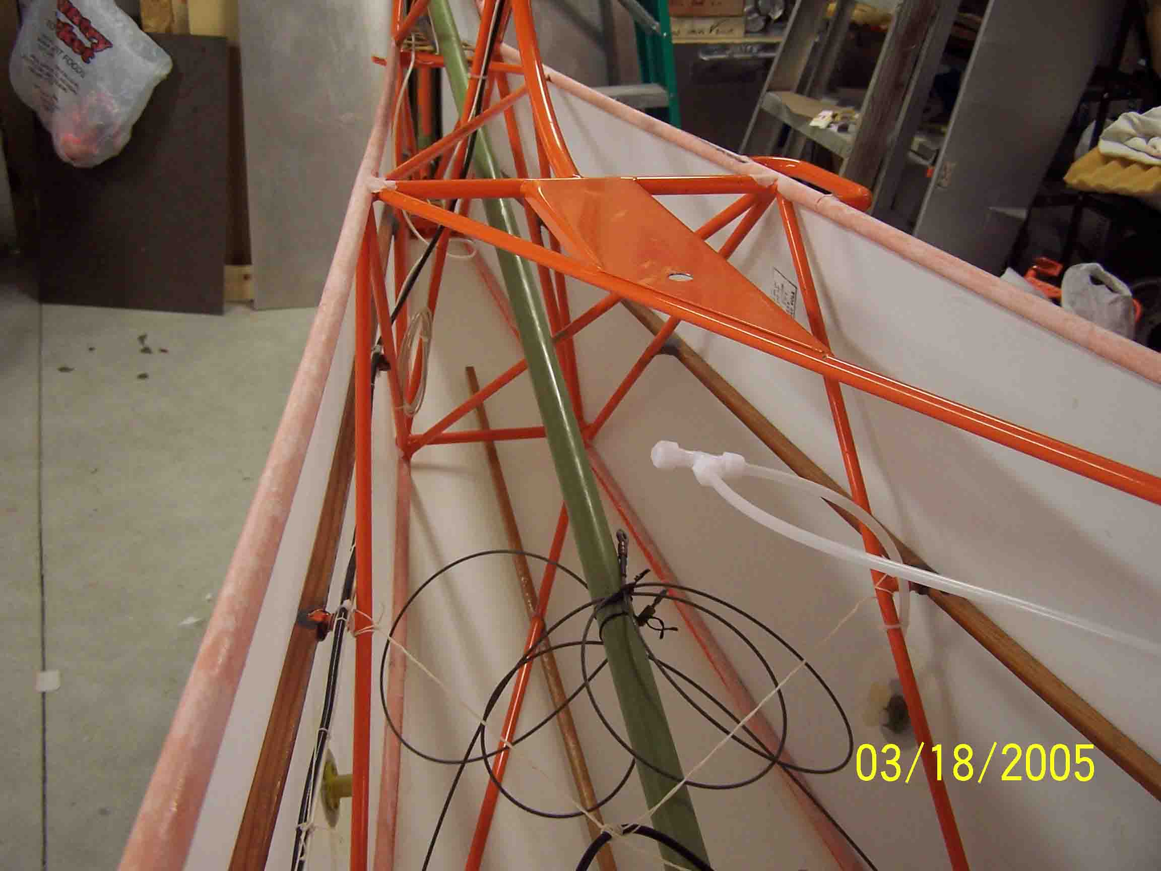

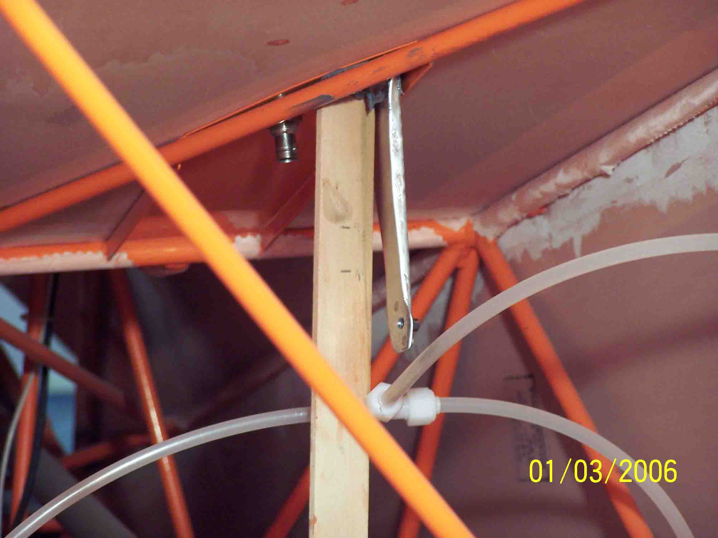

Lynn Matteson
Posts: 2778
PostPosted: Tue Jan 15, 2008 1:58 pm    Post subject: Battery Location Reply with quote
Yes I did, Pat. That was one of the few things that my tech advisor
caught me on...I didn't have a support for the "teed" junction, and I
had to get in there from an inspection hole in the bottom of the
fuse, and install one...what a bear! The tubing is so stiff that it
would likely hold itself in place, but he insisted on it. Perhaps
vibration over time could break the tubes, what do I know?
I couldn't find the drawing of the exact placement in my manual, but
I measured my plane and the dimensions are: 5 and 1/8 inches from

I'll try to attach the pics that I had in my files, but even though I
reduce then as Matronics asks, I always get a "rejection
letter"...and then they show up anyway. If they don't show up, I'll
send the three pics to you, Noel.
On Jan 16, 2008, at 9:02 AM, Noel Loveys wrote:
Any chance the next time you are poking around in your fuse that
you could take some pictures of your static installation. I have
been considering installing a better installation.
This is before I had installed the right-hand side tubing.
This is up through the inspection hole opening, with temporary stick
holding support in place while adhesive hardens. It's hard to not
make a mess with the adhesive when you're working through the hole.
Another shot of temporary stick. I had to install this support brace
with one hand through insp. hole. The support has many holes drilled
through it to allow the adhesive to ooze through and form a "rivet"
of sorts. It also jams between the fuse tubing and the antenna plate,
so there is mechanical, as well as adhesive attachment. Getting a
machine screw into the (eventual) adel clamp was a joy, too!
