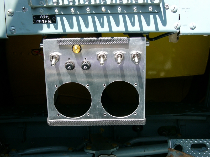

Thanks for the warnings, Mark. I did complete the circuit with a crowbar and a 2 amp breaker. I’ve checked the whole thoroughly before installing. But I also left in all the Russian circuits  so that I always can go back easily to the Russian system. In attachment you can see the small console with the circuit breakers (2 amp for overvoltage and 15 amp for the whole circuitry). The circular openings  are for a Becker radio and a Garrecht Mode S transponder. I’ve chosen to build a separate console, so that I always can restore to the original system.
Seasons greetings, and many happy landings in 2008 !
Jan
