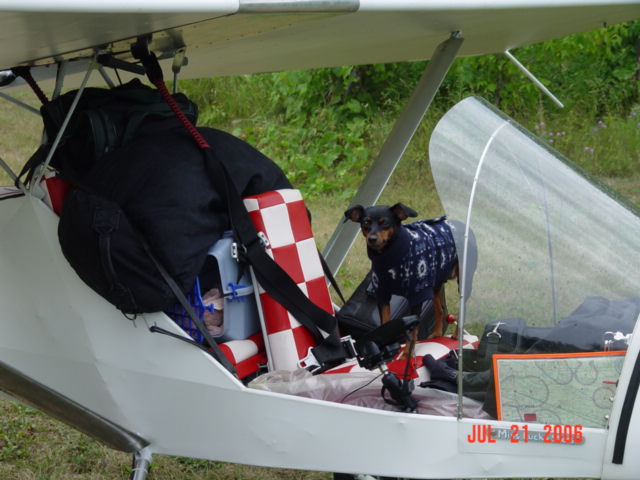

Even in a Firestar ....With only the windscreen it's still windy....
That's why I fold the chart to fit a clear plastic sleeve....
You can pull it from under yer leg and see where yer goin....

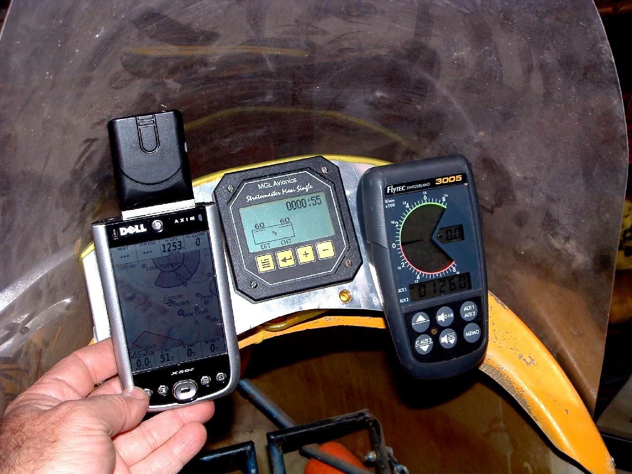

Here is a picture of my UltraStar Panel.
Here is what is in the picture:
On the left a Dell Axim x50v PDA with GPS, I bought from ebay last week ($125) Still need a mouning bracket for it.
It has the free XC Soar moving map software with the terrain, roads, waypoints and airspace turned on.
Displays GPS Altitude, distance/course to next waypoint, ETE, ETA, Ground speed, bearing etc etc and is configurable.
In the middle a Stratomaster E1 engine monitor I bought last week($199) that comes to life when the engine is on and displays RPM, Hobbs Time(00:55), EGT, CHT and I am planning to adapt some of the other inputs to display fuel level as well.
It has settable alarms for all the temp and fuel readings and will flash the display and the little dummy light below the instrument on the panel if an alarm point is reached.
Its powered by a 9.6v 2400mah rechargable NiCad battery that should run it for at least 24 hours of on time.
On the right I have a Flytec 3005 Dual Altimeter and Variometer(Rate of climb) with audio, powered by internal AA bateries. ($225 on ebay)
Off picture is a Hall Bros. airspeed tube with disc.
More than enough info to keep track of things while enjoying the scenery.
All that light stuff has kept my Ultrastar a part 103 UL at only 246lbs.
Next I need to add some light wheel brakes, and found some small drum brakes online that should do the trick...probably 4 pounds worth.
Almost ready to go flying.
On the left a Dell Axim x50v PDA with GPS...
Such variety! Mine is very different: http://tinyurl.com/2bpv8o
or
http://smg.photobucket.com/albums/v486/flyparafan/Kolb/?action=view&current=Dsc01382.jpg
The pod with the ASI, altimeter, and engine instruments was on the plane
when I got it... I added the Garmin Geko 301 GPS (which I also use for
hiking and PPGing), compass (salvaged from a wrecked Cessna, no, I didn't
wreck it!), and Icom A24 radio (the antenna is mounted inverted underneath
the fuel tanks). You can't see the pitot/static tube but it sticks out
from the front of the pod. I'll probably add a Tiny Tach (just for the
hour meter and only because I have an extra laying around), but I'll
probably mount that near the engine since I don't need to see it in flight.
