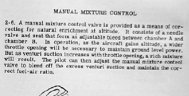

The following is a reprint from "Light Plane Maintenance"
Discussing aircraft mixture control systems. It is lengthy but a good read, especially the section on pressure carbs and leaning method by type of fuel distribution system.
As you can see from the article pressure carbs require manual mixture adjustment to get the most out of your engine.
JB I think you are a bit premature with the use of the word "wrong"
I do not doubt that you and many Commander pilots and many older pilots were taught that the mixture control on PS5 pressure carbs is simply an on off switch. That concept is just plain wrong and needs to be questioned rather than just passed on as gospel.
In the old days fuel was a cheap coolant and leaving a pressure carb at full rich was acceptable practice. It even made its way into some manuals although I do not recall seeing it in a commander manual.
Mr Bendix did not attach the mixture control to a "METERING NEEDLE VALVE" for the purpose of on and off. If on/off were his intent he would have put a ball valve on the carb inlet.
This concept is just as dated as
Don't run oversquare MP>RPM/1000
Rapid throttle reduction causes shock cooling.. Data clearly shows flight into precipitation causes greater mor rapid cooling.
Do not run LOP.. Once again date clearly refutes this.
Any way the article follows.

PostPosted: Sat Sep 29, 2007 6:27 pm    Post subject: Re: Pressure Carburetor? Reply with quote
Glad you mde it home OK JB, Wish I could have been there,
it is possible to do it, but why??
If you go to this link
http://www.navioneer.org/riprelay/The%20Navion%20Files/Bendix_Carb.pdf
(Link courtesy of Craig C.
you will find an entire installation and operation manual for the PS series pressure carbs. It is a 12 MB download.
The why is because Mr Bendix says to as evidenced in the page copied from the manual and attached below. The entire download has description of operation as well as drawings of the carb and its internal components.
You have frequently mentioned to many of us about cramped budget sell your commander and "Commander ownership isn't for everybody" That is not a good reason to continue to operate a plane incorrectly.
Its not a matter of cramped budget. Its a matter of dispelling bad practices that have been passed on by word of mouth for generations in the face of overwhelming evidence that refutes them.
It is a matter of changing your ways when they are replaced by something better.
I fly 300 hrs a year that would save me 1200 gallons of fuel or at todays price $4800. Thats a years tuition for my Sons college, A downpayment on a new car. A trip to Hawaii. Or it would fund one heckuva Twin Commander flyin.
Those good enough reasons. How about running an engine correctly will make it last longer. Not an insignificant thing considering how hard parts are to come by for these old engines.
not recomended by the manufacture of the carb
But it is as you can see in the attachment below.
