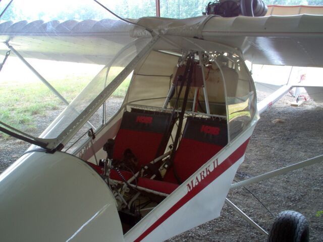

New Kolb Mark II owner here. Can you guys take a look at the picture I've attached and tell me if you've seen a gap seal like the one I have? It is some kind of cloth (I don't know what). It is velcroed onto the wings. Is that safe?
Cristal

beauford173(at)verizon.ne
PostPosted: Sun Sep 23, 2007 6:28 am    Post subject: Gap Seal Reply with quote
Brother (Brothette?) Cristal:
Per your question... I don't believe safety is necessarily the issue with
the nylon seal. However, I had unsatisfactory results with the Kolb
factory-provided rip-stop nylon gap seal which came in the Firefly kit... It
never actually came off, but despite my re-velcroing efforts on the aft end,
the trailing edges gradually feathered out and shredded in the slipstream
until it eventually became an unsightly mess after about 50 hours. The last
time I flew with it installed, I learned a bonus lesson about nylon and
various hot Rotax Brothers components, particularly, the exhaust... The tiny
nylon fuzz instantly melts and bakes onto every hot surface with which it
comes into contact... and the low-pressure turbulent areas behind the BRS
cannister did a superb job of sucking that little cloud of nylon thread
particles back forward enough to give a really nice spattering effect on
parts well forward of the shredding areas further aft....
Once baked on there, it took a delightful scotchbrite and sandpaper weekend
before I finally got all of that crap off the engine.
I would use asphalt roofing shingles for a gap seal before I would put
another one of those nylon thingys
on my airplane... It now has an aluminum seal, heavy velcro at the front,
bungees at the rear... 90 or so hours on the thing... no problems.... yet...
Worth what ye paid fer it...
Beauford
FF-076 / N173BW
Brandon, FL

Thanks for sharing your input and experiences. Just curious if there are factors that contribute to the deterioration of the Velcro such as...are they hangered right after flying vs. left out in the weather...do you fold the wings every time you're done flying, thus needing to continually remove and replace the cloth gap seal...do you live in extreme climates?
Beauford, I've never heard the term "Brothette", but if that's what you'd call a "Mrs.", then yep, that's me.
Aviatress Cristal Very Happy

HShack(at)aol.com
PostPosted: Sun Sep 23, 2007 6:32 pm    Post subject: Gap Seal Reply with quote
In a message dated 9/23/2007 10:07:34 PM Eastern Daylight Time, cristalclearwaters(at)juno.com writes:
The sun deteriorates the glue on Velcro fairly fast. Most people get rid of the cloth gap seal pretty quick.
My plane is a FS II.
Mine is made of .060 Lexan with an aluminum leading edge & some lateral aluminum angles & is held on with screws into the wing leading edge, industrial Velcro along the edges, & bunjii's. It only covers the top of the wing as I like a lot of clearance for my big head.
The best mod. I have made to my FSII is to replace the short windshield with one that starts out the same as the shorty at the bottom [where it bolts on], but extends all the way up to the wing. Also, because of bad knees, I trimmed the right side of the windshield so that only one screw holds that side, gives me about 8" more room to get my foot in. Yes, my windshield shape is assymetrical, the plane doesn't care.The new Lexan was increased in thickness to .090". I don't fold.
I no longer feel the wind is pushing my head back & it makes winter flying more bearable. By the way, I live in SC.
Howard Shackleford
FS II
SC
Make AOL Your Homepage.
PostPosted: Sun Sep 23, 2007 7:21 pm    Post subject: Gap Seal Reply with quote
Madam Aviatress Cristal...
Per your questions; My machine lives in an enclosed trailer and is folded
after each flight.
My take on the deterioration of the nylon cloth was that it was not so much
the velcro, or any sort of UV induced ageing, as it was the fluttering of
the trailing edge of the center portion of the cover... I think it
mechanically beat itself to death. As I mentioned, I reinforced the velcro
on the sides toward the rear with heavier stuff... and I took particular
care to stretch it as tightly as possible after noticing that it was
shredding a little over toward the center... From the time I first noticed
the beginning of the problem until it turned into a fuzzy nylon party favor
was not more than five flight hours. That last hour did almost all of the
serious damage.
As for living in an extreme climate... I have been married over 42
years....
Good Luck, and enjoy your Mark II.
Beauford
p.s. Aluminum and lexan are our friends....

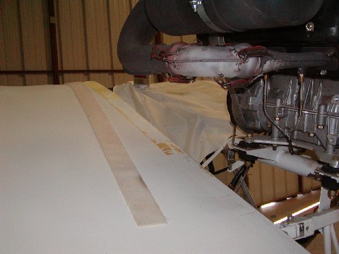

Cristal,
History of my center wing gap seal.
I painted the original white gap seal to match the color of the FireFly.
The thread on the original Kolb supplied trailing edge started to fail from
flapping after three hours of fight. I re-sewed the seam and inserted a
small diameter aluminum tube inside the seam to stiffen the trailing edge.
This stopped the fluttering and I had no further problems with the trailing
edge.
After 41 hours, about one year, I replaced the gap seal. I purchased light
red Dacron cloth that closely matched the color of the FireFly. I cut the
thread on the original gap seal so that I could use it as a pattern. I
re-used the original Velcro. It has been in place for the last 190 hours and
seven years. To save weight, I did not paint or seal the cloth. I keep the
back edge from fluttering by using a small piece of Velcro in the center to
attach it to the engine support tube. I did install a tube in the foremost
seam to prevent it from buzzing.
I rarely fold. The FireFly is hangared in and enclosed building out of
direct sun light. All but two years of this time the FireFly was hangared
in the Mississippi River bottoms where it was hot and humid in the summer.
I have not had any trouble with the adhesive backing on the wings. At this
time, the color shows some fading, but otherwise the gap seal in in good
shape.
I hope this helps you out.
Jack B. Hart FF004
Winchester, IN
