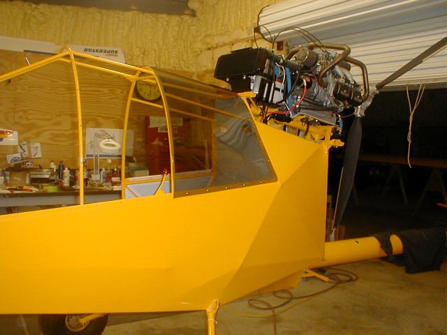

After two band-aids on two fingers the Lexan is cut and fitted. Have to postpone the move to the airport another week. But we are geting there.

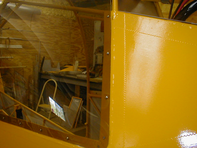

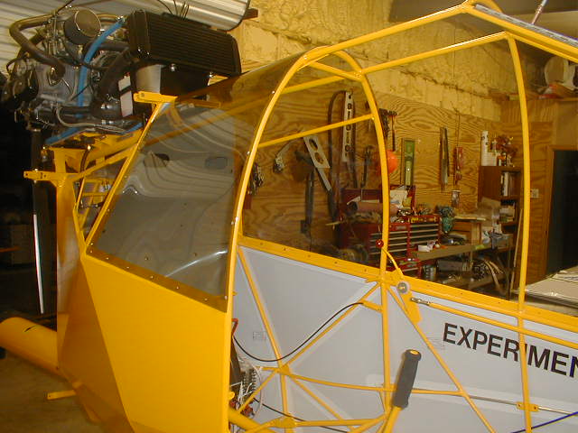

Few pics of the final instal of the first panel of lexan. Had to do alot of fine tuning and sanding of the edges but it's coming together.

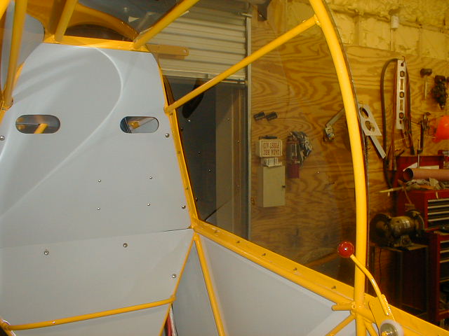

HA HA Scott! I have 4 of the vents that go in the lexan. I havent cut the holes yet. My buddy Scott Swear says he made the perfect tool to cut the holes so Im waiting on him.

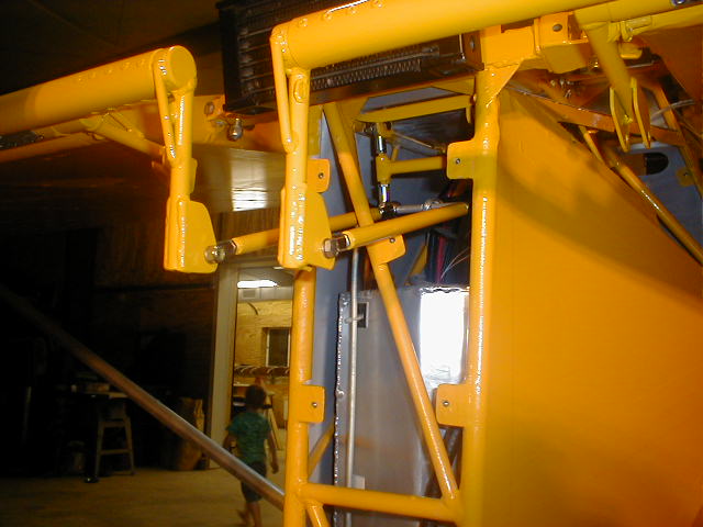

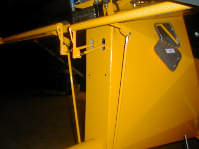

I hit a snag last night. Hooked up the flaps and they work great, hooked up the ailerons and my push/pull tubes appear to be about 2" to long. Cant for the life of me figure this one out but will let ya know.
Paul Petty
Kolbra #12
Ms Dixie
912 UL 70" warp
Paul Petty
Joined: 11 Jan 2006
Posts: 226
Location: Mississippi
PostPosted: Thu May 10, 2007 10:57 am    Post subject: Re: Ms Dixie update Reply with quote
Ok Gang,

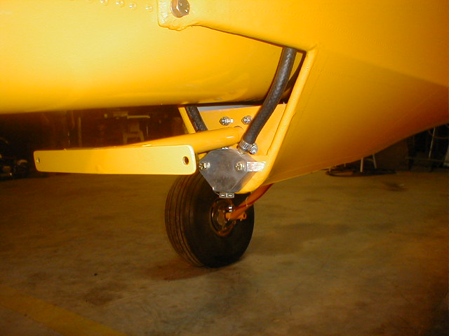

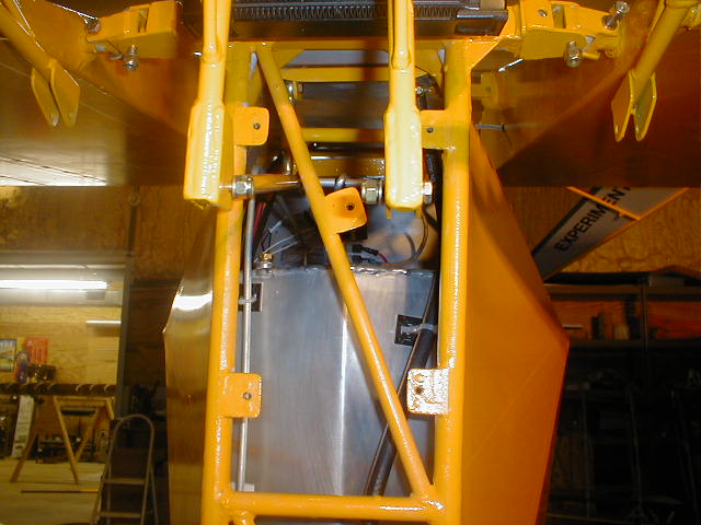

Solved the aileron push/pull caper. When i rigged the wings and ailerons, I used the "slider" for the flaperons and the factory push/pull tubes. After I removed the wings and moved the fuselage back into the "cool" side of my shop I did away with the sliding set up and went with the control tube through a nilyon bushing. This raised the tube about 2" and allowed me to install my home made sump for the fuel tank. I just plain forgot to shorten the push/pull tubes before painting. Rolling Eyes
Threaded rod ends should be here tomorrow and will make changes this weekend. I still need to paint the lift strut fairings so will do that when i repaint the tubes.

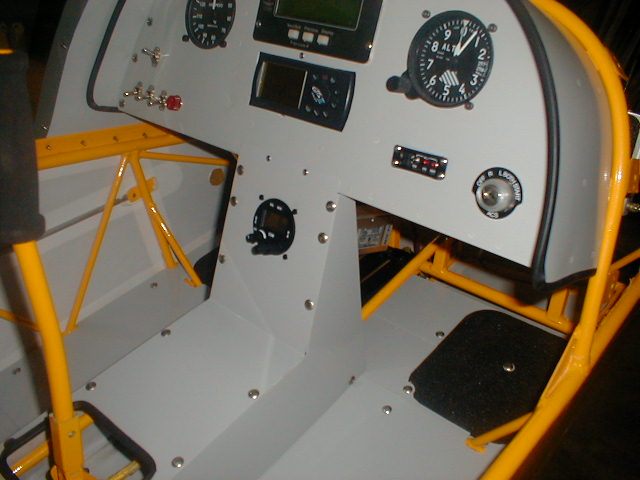

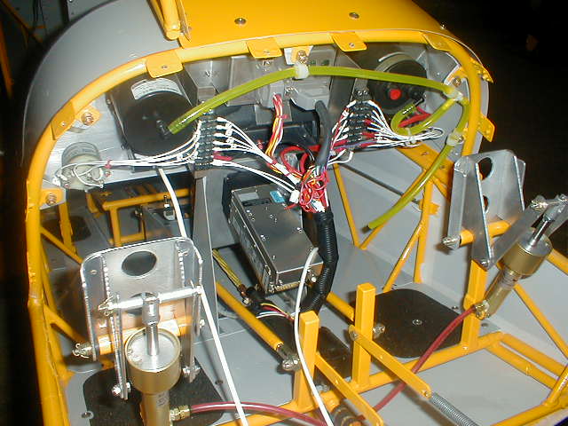

Well gang after a week off Im back to work on Ms. Dixie. Radio came in yesterday and we mounted it in the console last night. Also cut holes for flap push/pull tubes and checked for clearance. Looks like my guess work was pretty close!
We bought a Becker 2 1/4" radio/intercom. Looked over the wireing diagrams but the symbols appear to be in German. Anyone had any experiance with this?
back panel
 Filesize:  50.92 KB
 Viewed:  555 Time(s)
radio face in console
 Filesize:  56.22 KB
 Viewed:  582 Time(s)
back of radio
 Filesize:  62.19 KB
 Viewed:  594 Time(s)
