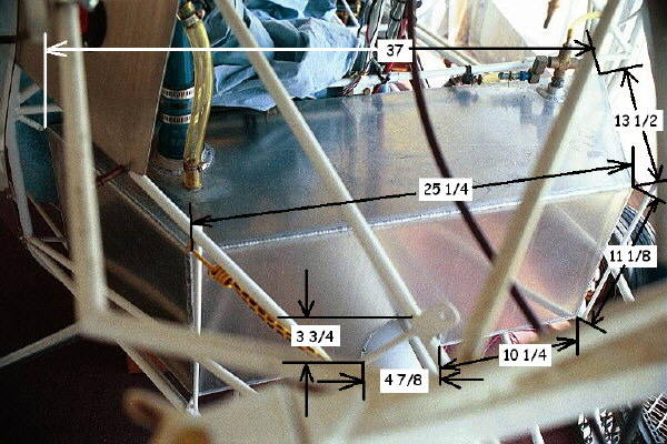

I would be interested in pictures, dimensions, plans, drawings, ect. of the 16 gallon tank from Kolb. Feel free to send what you have back channel if you don't think it all belongs on the list.

Here's dimensions of the stock Kolb (TOK) 16 gal tank.

Thanks for the picture with dimensions added. Seems like they went to a lot of trouble just to drop the tank floor a few inches below the boom tube. Did this tank fit thru the cage or did you have to cut and replace a tube or two?

The cage came from the factory with 2 removable tubes behind the seats, and
the tank - just - slid right in. Lar.

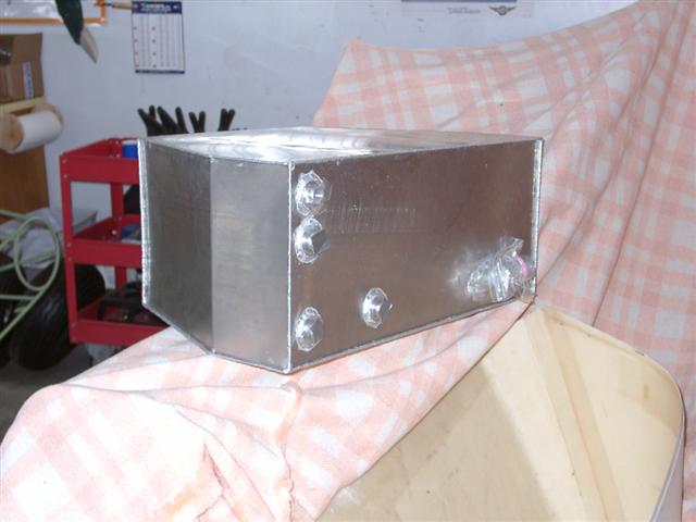

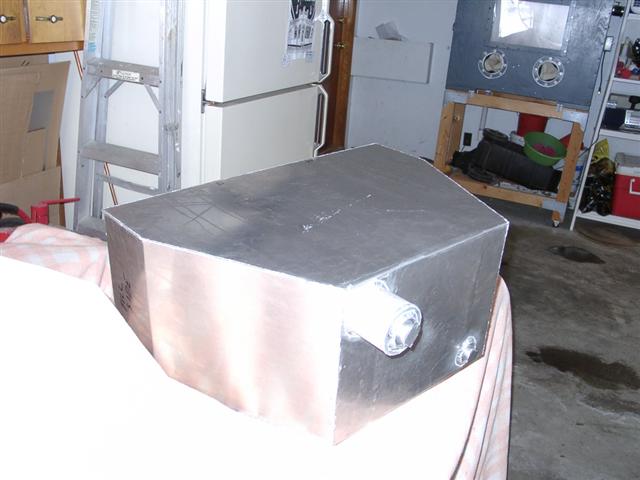

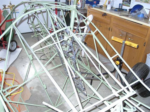

I will be ordering a 912S this Summer. I hadn't really thought about the fabric / torque tubes but John's suggestion seems good. I'll figure out the cooler, etc. later.
I attached some extra pictures of the tank and mounts. The cage is on its side for the final welding. I used 5052-H32 .06" thick for the tank.
