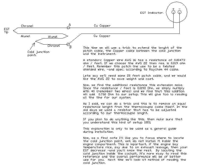

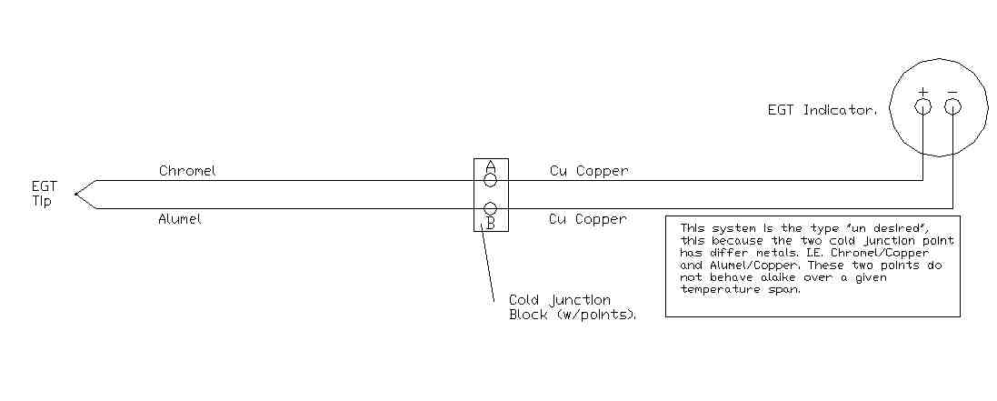

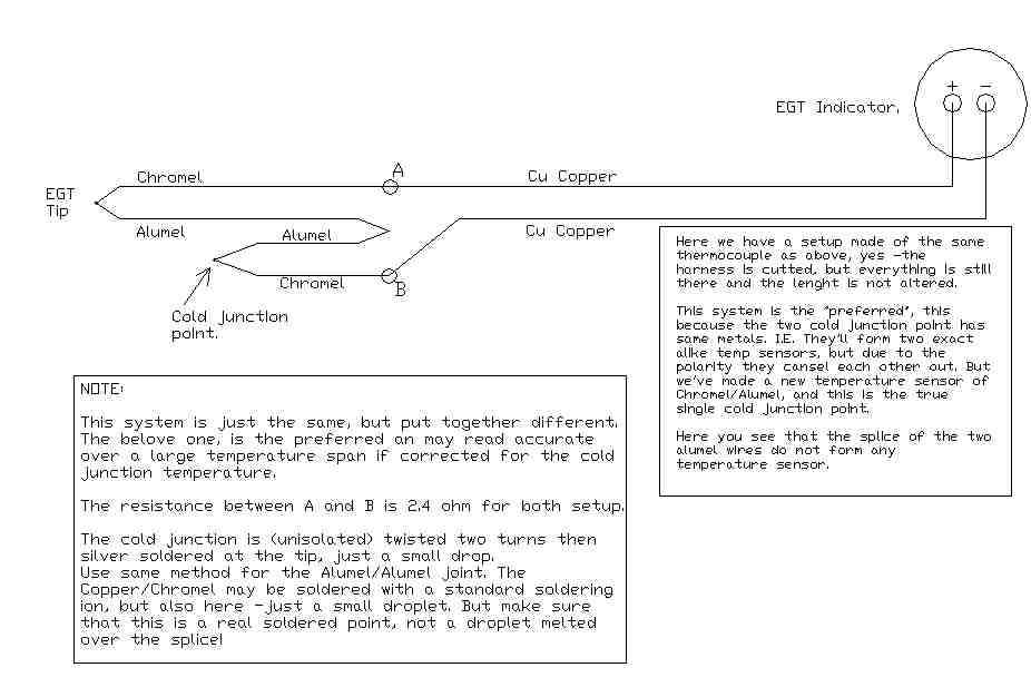

PostPosted: Sat Dec 30, 2006 2:01 pm    Post subject: Possible overheating and EGT question Reply with quote
Lowell and All,
here's the next one about the EGT; this time about the thermocouple
connection methods, just the three of them.
In the end of this you'll find the visual wives of cold junction, the way
I often use to explain it.
This first one, is our standard Westach setup, a straight through setup
accepting some error.
The second one is the preferred connection setup of a thermocouple, this
one has no error if it is correctly corrected for cold junction
temperature and the instrument has no error!
The last one is a combination of the above, but also manipulating the
thermocouple resistance in order to extend the distance between probe and
indicator.
All of these drawings is made (yesterday night) with AutoCAD, the files is
converted to jpg for the ease of presentation. (They might look a little
“gray”, but this is due to the high compression.)
Next time we'll see how "cheap devices" can be used to measure cold
junction temperature and OAT.
(Prob. Next year.)
Torgeir.

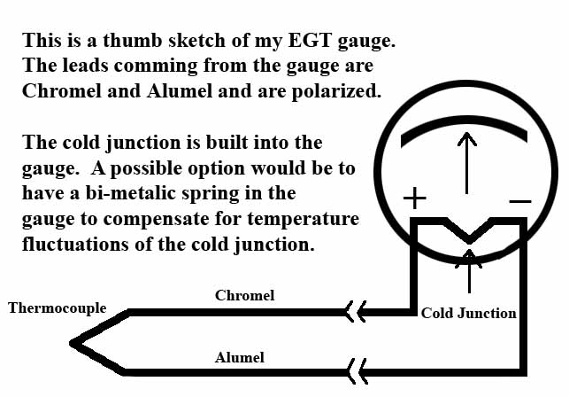

PostPosted: Sat Dec 30, 2006 4:05 pm    Post subject: Possible overheating and EGT question Reply with quote
I don't have CAD on this computer. My copy is 2000 and won't load onto the
XP. S I did this up on Photoshop.
It is a Rough, and I mean rough, diagram of my EGT schematic as came with my
EGT documentation... I don't intend to open the Instrument to check on the
location of the cold junction
Just one more configuration.
Still prefer the EIS set up Lynn has... Just need one for 2 cyc.
Cheers and Happy New Year
Noel
