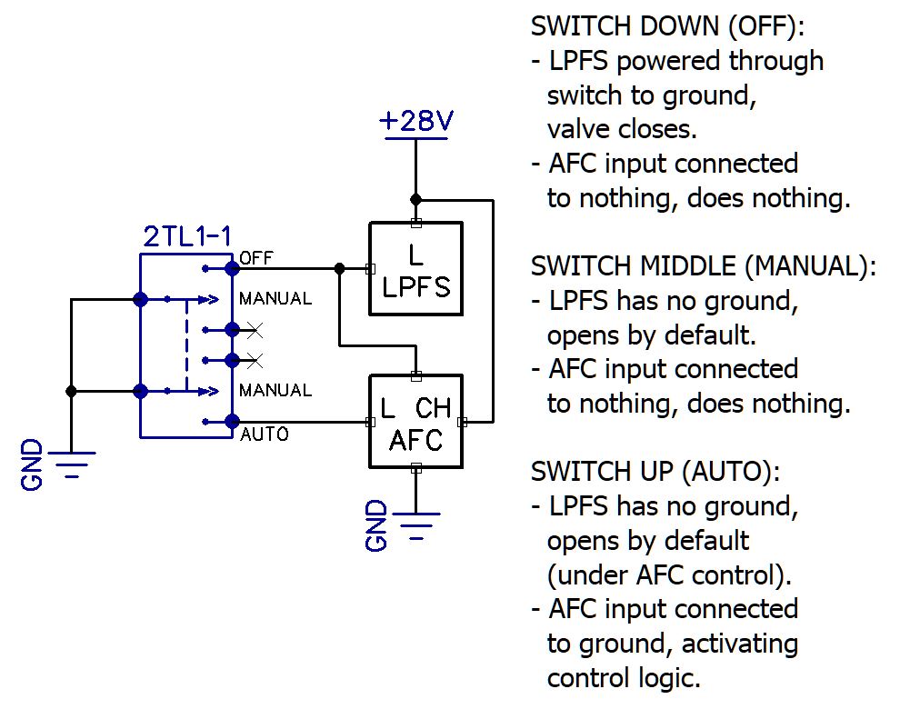

Here's a quick conceptual doodle showing how the switch wiring might be done to handle OFF-MANUAL-AUTO switching, using a 2TL1-1 (or, for a much cheaper alternative, the B&C S700-2-1).
Switched LPFS ground connection to be shared with HPFS using diode steering.
AFC logic remains the hurdle...

Pete, do you have a datasheet link for your LPFS and HPFS? I'd like to see their electrical requirements and what position feedback, if any, they offer.
Yes, latching relays could definitely be part of the solution, but they can't be driven directly by the fuel level sensors. This type of relay requires a brief pulse (a few tens of milliseconds) to set or reset its coil(s) (some have two), not a continuous current like a normal relay. This would require some electronics to turn the long-duration on/off cycles of the level sensors into these short pulses.
Also, we want the absence of fuel at the Low Level Sensor to open the solenoids, but we don't want them to close when that sensor sees fuel again; they have to wait until the High Level Sensor also sees fuel. That's going to require some electronics too.

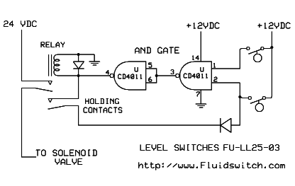

Eric,
What do you think of the attached circuit? It uses discrete components. No computer necessary. Integrate it with your switch circuit.

PostPosted: Sun Feb 22, 2026 9:29 am    Post subject: Re: Fuel System Manager Reply with quote

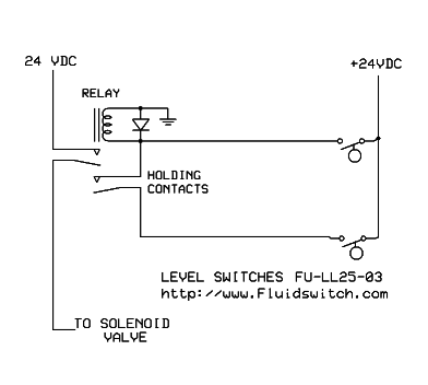

After thinking about it, why use an AND Gate?
The upper liquid level switch could energize the relay.
The relay can hold through the lower liquid level switch.
Joe Gores

PostPosted: Sun Feb 22, 2026 9:48 am    Post subject: Re: Fuel System Manager Reply with quote
Simple relay circuit attached.

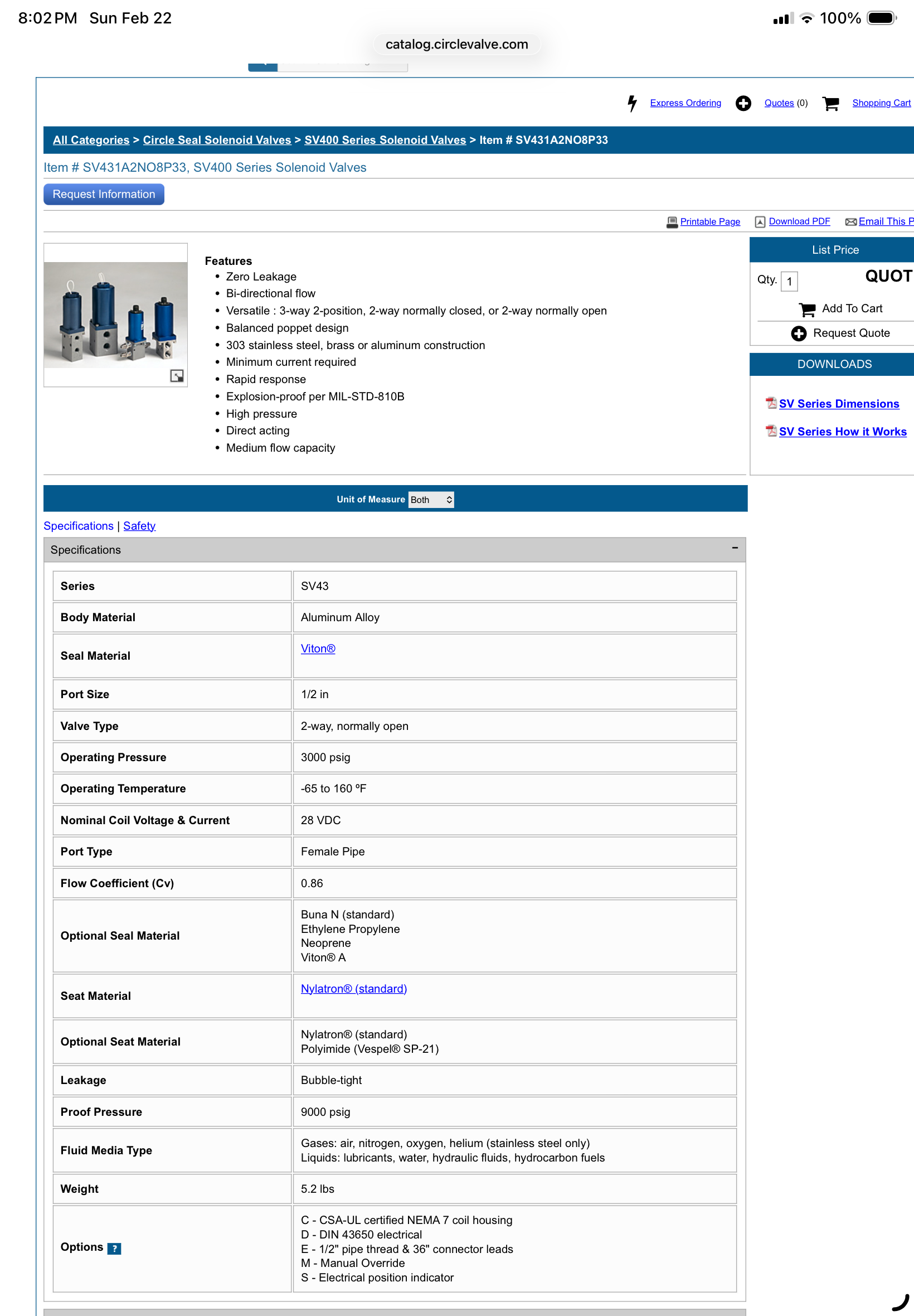

Here is a copy of the specifications for what I will use for the low pressure solenoid. The original spec’d solenoid is not available. The high pressure one is a Duke’s aerospace part, they are the original supplier of the low pressure one as well, but they are no longer in business as well. All the solenoids just have 2 wires so I assume they are simple on open or closed.
As far as the logic I started investigating Arduino controllers and that might be the path of least resistance for this whole project.

Joe: Yep, I was over-thinking it. Well done. Your second diagram does exactly what's needed with nothing but one relay per side. You have to wonder why they used a PLC in the first place.
Pete: An Arduino isn't necessary. In fact, the original PLC wasn't necessary. The diagram in Joe's last post does exactly what you want with just a relay.

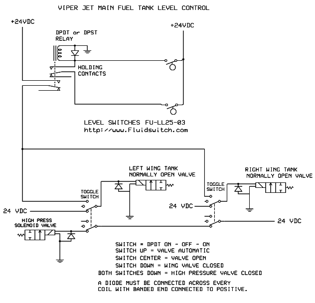

Below is a schematic of the Viper Jet mail fuel tank level control.
It was confusing to draw because the valves are normally open.
Power is applied to close the valves.
The low fuel bingo light feature can be added with a delay-off relay.
Suggestions welcome.

PostPosted: Thu Feb 26, 2026 9:09 am    Post subject: Re: Fuel System Manager Reply with quote
Billski, Thanks for your input.
I like your idea of venting the main tank back to the wing tanks.
And I agree that Failure Modes and Effects Analysis is a good idea.
It is my understanding that the original designer of the Viper Jet also
designed the fuel system, not the current builder, Pete. Originally the main
fuel tank level was controlled by a computer. Since that computer is no
longer available, Pete asked for my assistance. I substituted a relay for the
computer. If that relay fails, no big deal, the main tank level can be
controlled manually with the toggle switches. As for float switches, there are
none. I drew float switches on my schematic to make it easy to understand.
But the level switches are actually industrial solid state switches. Pete
posted the switch manufacturer's description in a previous post.
I agree that the operational risk in this bird is higher than I am comfortable
with. However, Pete flies Jets for a living.
Each of the 3 fuel tanks also has independent capacitor type fuel level
sensors. Assuming that those sensors are connected to an EFIS, the EFIS
can be configured to alarm whenever a fuel tank level is either too high or too low.
If something goes wrong with the fuel transfer system, the main tank holds
more than 30 minutes of fuel. Hopefully that is enough to fly to an airport
with a long runway.
Joe Gores

As Joe said I’m a builder, not a designer. Even though there aren’t many of these planes flying there are some and the fuel system has been proven to work with respect to the ability of the jet pump having enough capacity to keep the main tank full
I read through your thread on HBA. As someone else noted in your thread this isn’t really a fuel system but a transfer system meant to keep the main tank full. In the event of total electrical failure all three valves open and supply the main tank. Yes there will be fuel venting overboard. If it happens with anything in the wing tanks you will get a full main tank plus some of the wing tank fuel until they are dry. Should give you no less than 30 minutes until fuel exhaustion. Thats 30 minutes at 300+ knots.
You mention the 3000psi solenoid valve. The original design used a 150 psi max valve from Dukes aerospace. They are no longer in business and I’m having a hard time trying to contact the follow on company. The valve I’m contemplating is good up to 3000psi, but there will be nowhere near that in actual use

I haven't gotten back to working on this but I wanted to check progress here. It looks like Joe has the basic switching schematic pretty much licked. Except...
As drawn, the HPFS is only under manual control by the switches, and the relay can't control it in AUTO mode. The HPFS will be open any time either switch is in any position other than OFF, even if both LPFS are closed by AUTO mode. Maybe that's not a problem. Pete, what say you?
A relay with 3 or more normally open poles may be able to control the HPFS in parallel with each LPFS, but I haven't thought through the switchology...
I have the bones of a low fuel light delay and flasher circuit, so I'll press ahead with that part. Pete, do you want an output to trigger an EFIS alarm or do your other fuel level senders have that covered? If so, does your planned EFIS system accept 24V inputs for alarm triggers, or would 12V be preferred?

Eric
The HPFS can stay open in Auto. It just needs to be closed in the off position. That is what is used during engine start.
I’m using the Garmin G3X with a GAD27. The documentation says it’s for 12 volt systems, but the garmin engineers I spoke with say it will handle 24 volts. I can also use the GEA24 which is part of the system as well for the warning input. It is rated for 24 volts. Either of these units can be configured for the warning to be active high or low.
