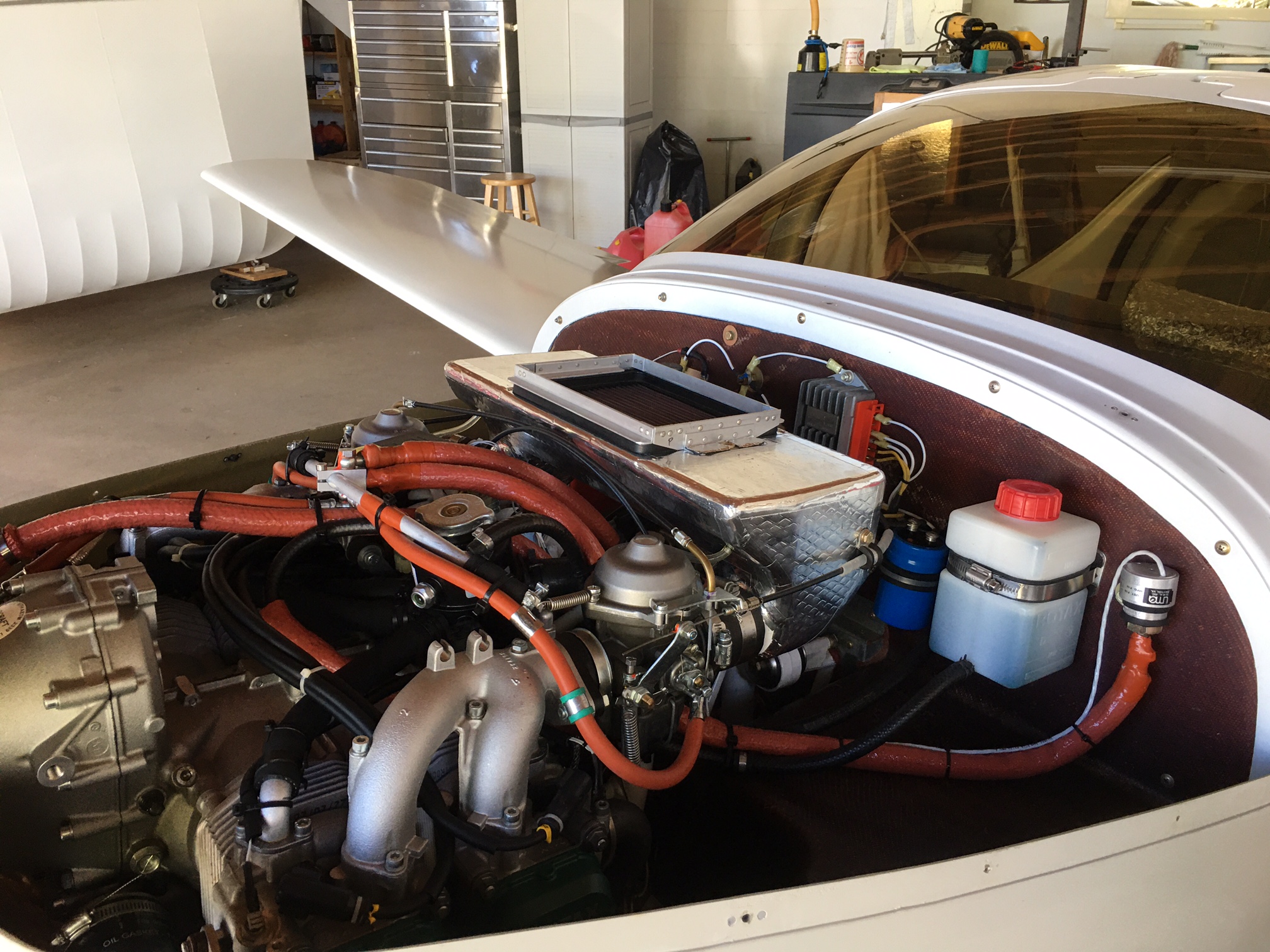

I used the Noico material since I already had it (purchased a while back but never used due to the weight). And now it is installed. Unfortunately we have a few days of bad weather and wind coming so may not be able to test but will try just before sunset today if the wind dies down a little.
Regarding the material to use on the firewall, flammability of the material needs to be considered. I did a vertical flame test on the material I used in the airbox and the flame did not propagate. After the starting flame is removed it will burn for a short time but not support it (quits). I don't think it is any worse than the resin the airbox is made of but not 100% sure of course. And even wonder if it was the adhesive that was burning. But if there is a fuel or oil fire in the engine compartment this stuff will certainly not help. And the fumes may be another problem. So I would not consider this material unless more info on this becomes available.
I will do a more aggressive test later this weekend using a torch. Want to make sure the material will not support s flame a I saw earlier today.
BTW, I still think this stuff is way too heavy. But heck, if I can be as impressed as A51 is, I'll go on a diet to compensate Smile
Here are some pictures of the install. Looking forward to testing!

Nice job; you don't muck around!

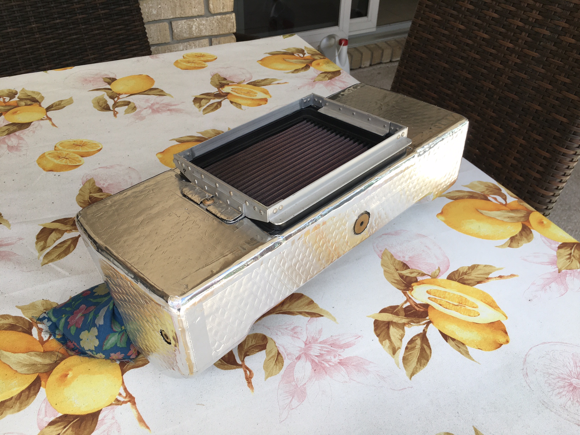

Your airbox is slightly different and looks like your engine is possibly set forward?? πŸ€·πŸΌβ€β™‚οΈ
Technical data on the butyl is provided on the DCI website in support pdf document; or via emailing them. Be mindful though it is shielded by the foil so this prevents air supporting flammability, but at the right temperature butyl will liquify into a tar type goo. If the situation is getting that hot you will likely be having bigger issues to worry about than the butyl igniting.
Looking forward to hearing the results...

A51,
I didn't muck around on this one because I am so desperate to see if this work and make my airplane quieter that this morning I woke up before the sun came up and couldn't sleep anymore so went to the hangar and got to work Smile Your excitement was certainly contagious and I am very curious to see if it works on mine as well as it did on yours.
Regarding the different airbox, my kit was a mix of bits and pieces scattered all over the country (and world). The airbox was missing but a kind soul in England send me an old one which is what you see here. However, when I tried to install it the thing's size was so off that the top cowling would not fit by a lot! I had to Frankenstein the airbox and chop about an inch of the top and glass it all up again. So yes, it is certainly custom.

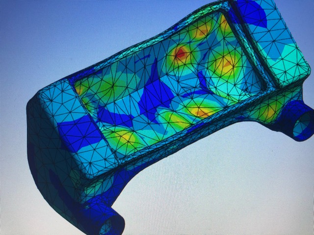

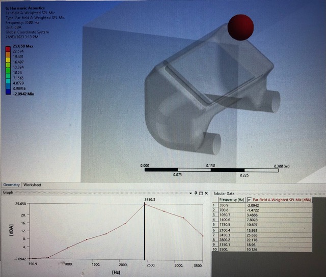

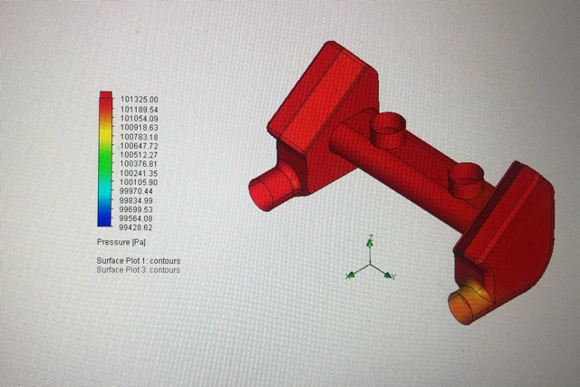

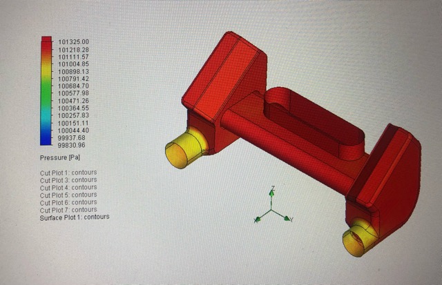

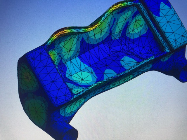

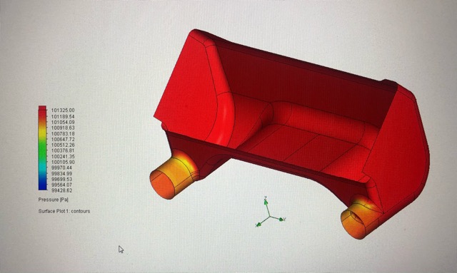

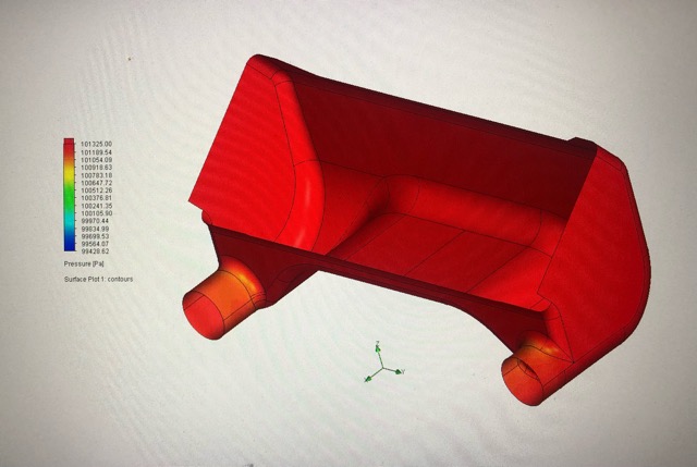

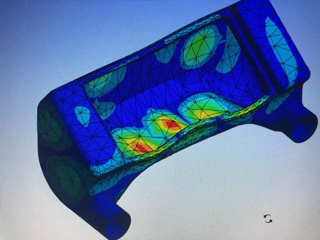

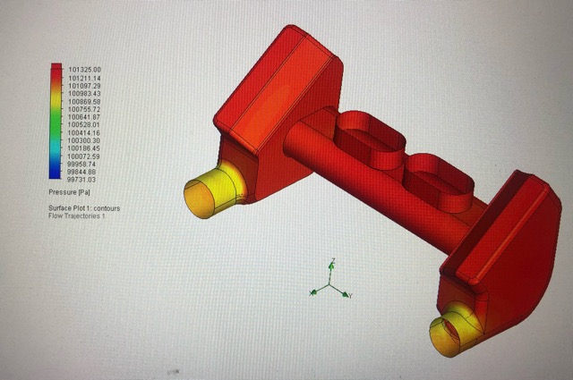

Experiments and discoveries are moving forward over the past few days with some entertaining results.
A rudimentary study of some baffle concepts were drafted and run through the simulator; the variations happened by accident due to forgetting to half the density consumption to rpm speed; so the elongated porting was developed and employed on these over calculated equations of x2 actual rpm; once recalibrated the results were pleasing on all the variations.
Volumetric mass flow analysis through the alternate air boxes was applied at 6000, 5500, 5000, 4000 rpm at 1013.25 atmosphere at 20.05C. Filtering for Static Pressure primarily, and Acoustic Energy and Flow Path as added features.
Red represents Ambient Atmospheric Pressure which indicates zero restriction to air flow within the air box at the test engine rpm.
Testing revealed the carburettor porting tubes are slightly undersized causing a pressure drop in these regions at engine speeds above 4000rpm on normally aspirated setups. At 6000rpm the pressure drop equates to approx 600' altitude increase, and at 5500 rpm approx 300' altitude increase, and at 5000rpm around 80' altitude increase. I would not be overly critical of this restriction as there will be many other factors left unconsidered such as inlet manifold pressure pulses, additional pressure flow from the naca vent on the engine cowling, and others...

Today is Sunday and the conditions are useless again for flying.
So its back into "Shut That Noise Up" project...
In this post 181's air box is getting analysed for harmonic resonance. The test passes frequencies from 1hz to 20,000hz through the 1.5mm fibreglass component to see where points of dynamic distortion will be at specific frequencies; blue is zero red is maximum.
Four frequencies were isolated from the pack to review what is going on at 5600 / 5200 / 4000 / 3600 rpm. The data provided correlates to where the air box body is "resonating" at specific rpm. The purpose of this is to identify focused points of resonance that can be individually attenuated for specific rpm ranges if desired as opposed to wrapping the entire box.... image order correlates to rpm list above.
The tests reveal that all areas of the air box resonate at one or more of the applied engine rpm frequencies; so complete attenuation of the air box is acceptable.
Further acoustic analysis shows the stock air box is generating 67db of sound at about 4900rpm; image attached below. this volume gradient is fairly linear as rpm increases and diminishes with distance from the source; volume gradient falls off from 5000-7000rpm. Placing a microphone probe 200mm above the air filter port reads 25db, while placing the mic probe off the rear wall reads 21db with volume on most everything below 4000rpm dropping off sharply.
This test is only the response of the air box itself to a frequency. It is not yet being subjected to induction generated acoustic pressure waves.
From these tests we can ascertain how to manipulate the stock air box to absorb induction noise frequencies from the carburettors.
Each version of modified air box will require the same analysis procedure to determine which design is performing the best.
