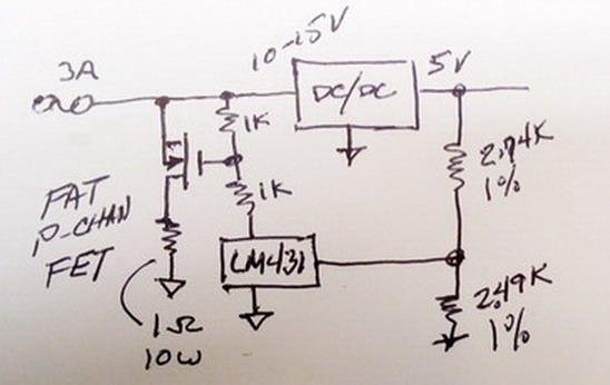

Bob, I'd be interested to see your OV protection circuit. I don't have an immediate need for it, but it sounds like something useful to add to my toolbox. Thanks.
Eric
[img]cid:7.1.0.9.0.20181004174841.0605cab0(at)aeroelectric.com.0[/img]
It's a variation on the crowbar protection
system . . . but instead of breaking the
DC/DC converter's output feeder, you break
the power input feeder. The trip point is
precisely set at 5.2V

At 07:15 PM 10/5/2018, you wrote:
You can’t charge a battery at the same time as it is “in use”.
A battery is a two terminal device: either you are pushing current into it, in which case you’re charging it, or you’re withdrawing current, in which case you’re “using” it.
If the terminal voltage is higher than the sum of the series cell voltages then current will flow into the battery. If the terminal voltage is lower than the sum of the cell voltages then current is being withdrawn. It can’t be both at the same time.
Correct. We're never simultaneously 'charging'
and 'discharging' the battery.
If you start you car with a heavily depleted
battery, a substantial portion of the alternator's
output will be dedicated to replacing the
battery's lost energy. AT THE SAME TIME,
the alternator picks up system loads in
the vehicle. So yes, the battery isn't
both charging and supplying energy to the
system loads.
In fact, during normal operations for
the configuration I proposed, the battery
would only be used to power the 5v system
loads while the engine is still off in
preflight. But as soon your chartger circuit
is supplied with power from as the ship's
the battery gets replenished and the 5v
system continues to function.
If the ship's main power is not available,
then the battery steps in to supply system
power

Hi Rick:
I am the original poster and also the same guy that wants to have the battery connected and charging (as required) with the RPi & Stratux.  The other thing I  wish to do is NOT use a standard 5 VDC battery pack but use a 12 VDC (at) 12 AH battery.
Thanks to WERNER, and his idea of using a DC to DC Converter the project now has a Solution.
The project will:
1 - Run off the plane's power.
2 - Have a separate Power Source - 12 VDC battery
3 - Have an output of 5.2 VDC (at) 3 Amps to run the RPi.
Oh!  Side note:  Remember "Strike Finders"?
Well, RPi now has a version of Strike Finder which is told to  be more accurate and more sensitive.
SO...  My project will have more than enough power to run a second RPi.
Barry

Hi Rick:
The project will:
