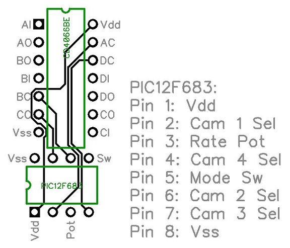

A CD4066 advertises itself as a quad gate analog switch, and it’s only $0.60. Alternatively since nobody here (I presume) is an experienced analog video design engineer, maybe the $8 part is worth it for ease of implementation.

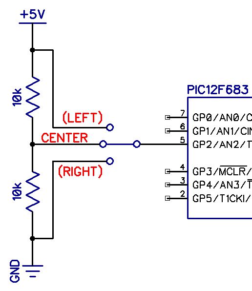

I’ve never seen a rotary encoder with a push-button functionality as well. Could we compromise on a single (on)-off-(on) toggle switch mounted left-right. Click left or right to go to next or previous camera; Hold left or right for a second or two to resume scan; Hold left or right for ten seconds to enter/exit speed change ‘mode’.
The PIC programmer in me wants to run and hide from resistor ladder networks for setting parameters: A 16 pin PIC should have lots of spare pins for jumpers. If you don’t want a speed programming mode there would even be enough pins left for a speed selector.

3. Some good discussion between Alec and Charlie WRT user interface: buttons, knobs, switches, etc. My $0.02 is this: if we stay with discrete ICs, the interface remains a single toggle switch, and either a trimmer or knob/pot for scan rate. If we use a PIC, I would advocate for a rotary encoder with a dead simple interface: pushing the encoder switch toggles between scan and hold; when in scan mode, each click of rotation increments/decrements the pause time on each camera by 1 sec; when in hold mode, each click of rotation selects the next/previous camera feed. No user programming, just immediate response to user input. It would be nice if the PIC could write the selected scan rate to non-volatile memory each time it's changed, and recall it on power-up.
Wow, good find. It sure looks to me like it would work, but I think we'd be short of PIC outputs to drive it. Vcc, Gnd, rate pot, scan/hold, step, and 4 outputs to the CD4066 comes to 9 pins. We could put a 2-to-4 line decoder (CD4555) between them, but that's another 16-DIP package.
Can the scan/hold and step functions be handled on one pin? I'm thinking LOW = hold (switch at center "ON" position, tied to Gnd), HIGH for >300mS = scan (switch at upper "ON" position, tied to 5V), HIGH for <300mS = step (switch toggled to momentary "(ON)" position, also at 5V). This would free a pin and eliminate the need for a decoder.
See: http://preview.tinyurl.com/ycllutuw
Turning the knob provides encoder output, pushing the knob closes a pair of switch contacts.
This could work too, but I'd like to avoid a "programming mode" and just use a pot to pre-set scan rate. It looks like we should have enough pins on an 8-pin PIC. I do like the idea of having the switch momentary in both directions. It would allow you to step in either direction, or start scanning in either direction. Good idea!
I've never used a ladder and never written PIC code, but I can imagine it's a pain without a very stable ADC reference voltage and low tempco resistors.

Actually we can combine both a set-at-install with a programmable cycle period. Fans of jumpers/resistors and buttonologists can both be happy.
And a two-way toggle is the same as two push buttons, and if you only want one push button simply don’t install the second, and be happy with only scanning forward.
Don’t worry about the number of pins on a micro controller - buy the micro controller with enough pins to do what you want. In the face of an $8 part, extra pins are free.

Well, I'm trying to keep the interface as simple as possible. I don't want a situation where the user installs one switch/button and has to learn and remember multiple button-presses, or X number of presses in Y seconds to access a programming mode. I would prefer to just have a pot that the installer can twiddle to set the desired scan rate once and leave it at that.
I wouldn't, except that to fit this device into a D-25 or D-37 backshell, I need to keep pin count low. In any case, I think an 8-pin device will be fine. See my next post.

I'm convinced that using a PIC is the way to go. I'd also like to give the CD4066 a try as the switch.
Once we hear from Wade that his EFIS and video adapter handle the camera feed switching OK, I'll edit the schematic and work on a board layout. Then Alec/Paul can write some code. Here's what I'd like to accomplish with the software:
    1. At power-up, wait a bit for the regulator to settle, then read voltage on AN3/Pin3 and correlate to scan rate (0-5V = 2-10 sec per camera).
    2. Start scanning at camera 1, then 2, 3, 4, 1, etc.

    - Short press R or L: During scan mode, stop scan. During hold mode, advance one camera forward (R) or back (L).
    - Long press R or L: During scan mode, reverse scan direction if switch is moved opposite to current scan direction. During hold mode, begin scan forward (R) or back (L).
Installation with an (ON)-ON-(ON) toggle switch would work as above. Installation with a single pushbutton would have the switch connected as the RIGHT position of the toggle, and would function as follows:
    - Short press: In scan mode, stop scan. In hold mode, increment by one camera.
    - Long press: In scan mode, no change. In hold mode, begin scan from current camera.
I've done a quick demo layout with the PIC and CD4066, so I could figure out the best GPIO assignments. See "Demo_Layout.jpg" below.
"Mode_Sw_AN2.jpg" below shows my best guess at how to attach the (ON)-ON-(ON) toggle switch to AN2/Pin5. Please let me know if there's a better way to do it.
Eric
Eric
