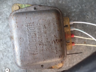

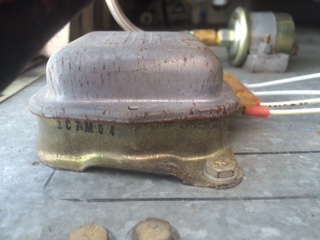

On one occasion, I was able to up-adjust an automotive
3 wire regulator by putting a diode in series with the
field-supply/bus-sense lead. Of course, this raised
the bus by about 0.6 volts . . . which in this case
was appropriate. Had a reader try to up-adjust a
3-terminal regulator with a resistor but he ended up
duplicating the galloping-ammeter syndrome.
Waayyyy back when, I opened up one of the 4-terminal
'ford' regulators and researched the voltage-set
divider. I brought a 'steering' lead out on the
unused "I" terminal for an external voltage adjust
pot. One could repeat that exercise . . . as long
as the bus-to-regulator resistance is low (usually
no problem except in old Cessnas and Pipers), these
automotive regulators are good value. Incorporating the
pot would add a quantum jump to their suitability
to task.
[img]cid:.0[/img]

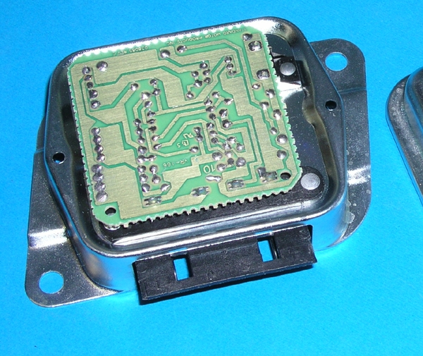

Here's one version of the VR166 after market regulators
but not the one I "jeeped". As soon as I've got
about 4 other projects off the bench, I'll see
I can repeat the exercise on a newer device.

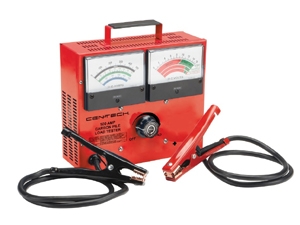

We measure 'cranking current' by placing as nearly
constant a load on the battery high enough to pull it
down to 9 volts. It takes a critter like one of these:
[img]cid:.0[/img]
AT THE END OF 15 SECONDS, read the load current
at 9v.
A new 18a.h. SVLA will produce readings in the
500-700 amp range.

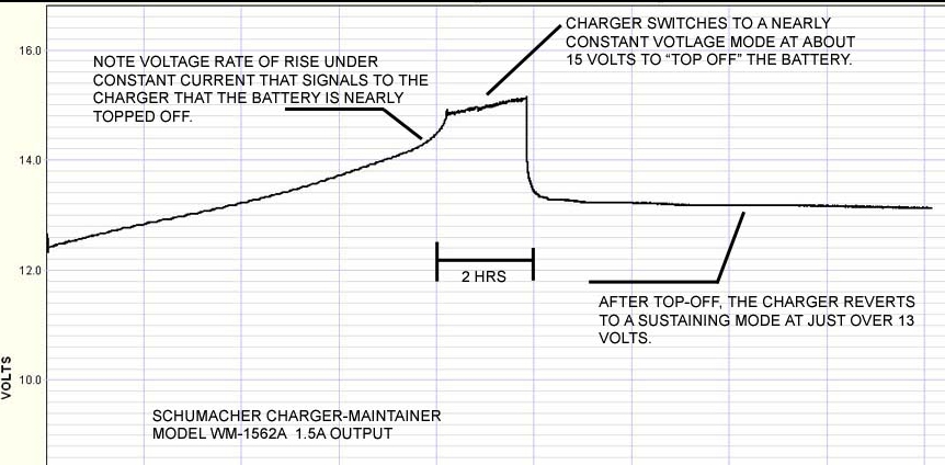

I've owned several of these critters:
http://tinyurl.com/ybkvfa26
They do a charge profile like this following
by a maintenance mode that lets you leave the
charger connected indefinitely.
[img]cid:.1[/img]

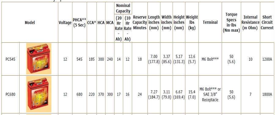

The Odyssey manual also states max operating temperature with a metal jacket is 80°C. My installation is very similar to Van's Aircraft with Odyssey batteries mounted on the firewall but I'm wondering if perhaps I should look into this as well. Perhaps figure out some way to measure the battery temperature or the engine compartment temperature during flight. In the last week I've put 8 hours flying in the hottest weather we get around here and can't help but wonder if this has anything to do with this problem. Has anyone ever done this experiment?
Maybe a problem . . . 80C is 160F . . . pretty hot for
cruising flight. If you stuck a thermocouple on the
battery box I doubt you'd see temperatures that
high . . . if you're willing to do the experiment,
recording and publishing the data would be a really
useful thing to do.

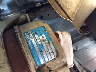

I did manage to get a picture of the alternator data plate though I can't quite make out the model number. I'm going to try attaching a picture of it and the regulator in another email.
Any data I should collect on the flight home? At some future date I will do the thermocouple thing and collect some firewall forward temperature data.

I think your battery may be a bit light for your
a/c. The SkyTec starters are permanent magnet with
especially high inrush currents. There's a reason
B&C stayed with the wound-field starter configuration
as being kinder and gentler to the ship's battery without
sacrificing cranking performance.
[img]cid:7.1.0.9.0.20170810103154.05b499c8(at)aeroelectric.com.0[/img]
The PC680 is by far the Odyssey favorite for your
size engine in OBAM aircraft. Half again better internal
resistance hence more tolerant of SkyTec inrush
currents.

Bob, when deciding on a battery last year the 680 looked like a better choice but the 545 was within the requirements that I could find. I cannot remember exactly where I looked but I think it was from generic lycoming manuals and I figured if it's within spec with a legacy starter it could only be better with a modern lightweight one. The smaller and lighter size was much easier to install so that's what I went with. It sounds like you may think that this failure could have something to do with how hard the battery is working. Do you think I have chosen too small a battery and a new one will have a similar life span?
