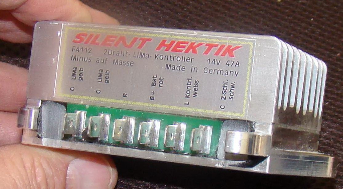

PostPosted: Mon Jul 04, 2016 1:16 pm    Post subject: Z-13/8 Questions Reply with quote
If the regulator fails - not a rare occurence
The failure driver for the Rotax/Ducatti R/R
has root cause in thermal considerations . . .
where the ship attempts to use full rated output
from the power source.
What kind of fuel pump are we talking about?
How much current does it draw? Certainly nothing
approaching the 18A capability of the power
source.
It seems that the rather strange recommendation
for dedicating the stock Alternator-R/R to simple
powering of the fuel pump is a hedge . . . with
loads limited to a fraction of the system's
advertised output capabilities, the regulator
should last a very long time.

Mike Miller has done autopsies on several failed Ducati regulators and he attributes the failures to poor manufacturing and vibration, not from heat. Some RV-12 owners have reported a gradual failure where they get low voltage alarms at RPMs where they used to have normal voltage. Each regulator could fail differently.
Some builders are reluctant to mount the regulator inside of the passenger compartment because they do not want to breath smoke if the regulator does fail in that location.

PostPosted: Tue Jul 05, 2016 9:05 am    Post subject: Z-13/8 Questions Reply with quote
vibration in a potted assembly?
not from heat.
Has he published a teardown report?
Color me skeptical . . . these regulators have
been in production for decades. There must have
been thousands sold. Over that period of time
and numbers of examples, I find it curious that
a constellation of failure modes would emerge.
At the debut of the 912/914 series engines on
this side of the pond . . . a SINGLE phase
PM dynamo in the 18-20A class was really pushing
the state of the art. The control devices
capable of handling that much current would
normally have been mounted directly to metallic
heatsinks with fins.
To my knowledge, production examples still
expect the potting compound to bring BTUs to
the outside world. Why Rotax continues to
sell/recommend this device is curious considering
the fact that there are much more robust/modern
devices available.
The OBAM aviation community has been slicing/dicing
this sad piece of technology for too long. It
has been thermally challenged since day-one.
I cannot argue against 'constellations' of
other failure modes . . . but debating a broader
spectrum of issues seems a waste of $time$.
It's like worrying about whether or not the
a/c and stereo are working in a car with
3 flat tires.
Has one EVER 'smoked'? Has a 'smoked' R/R
every been preserved for examination? Our ranks are
rife with anecdotal information on a product
with a very long service history . . . and
and continues to be offered by a company with
a lot of 'skin in the game'. Why jepoardize
consumer relations on a product costing
$thousands$ by sticking with a demonstrably
marginal accessory that probably costs them
less than $50?
I've observed some pretty strange marketing
decisions by big-name manufacturers.
To be sure, there are really powerful cultural
forces in company behaviors. I could tell you
some interesting stories about the intractability
of several supposed European 'project partners.'
So just maybe, the Rotax decision to stay with
Ducatti has nothing to do with science and
economics.
[img]cid:.0[/img]
My advice to Rotax customers. Pitch the Ducatti
R/R right out of the box . . . or put it up on
eBay. There's a bunch of ultralights flying the
912 that can probably make good use of an R/R that
should probably be rated at 10A.
The Silent-Hektick electronics cavity volume
is a fraction of that in the Ducatti. Square-
inches of fin area for heat dissipation is much
greater. Further, the thing is RATED at 47A . . .
so de-rating to run it on an 18A Rotax dynamo
seems a rational decision that goes toward
longevity and serviceability.
There are probably other devices out there
with equal or better performance than the Ducatti.
There will come a time when incandescent landing
lights will be a thing of the past along with carburetors,
VOR receivers and E6B computers. It's time for the
Ducatti R/R to be retired as the best Rotax could
offer at introduction . . . but long since
surpassed by better ideas.
