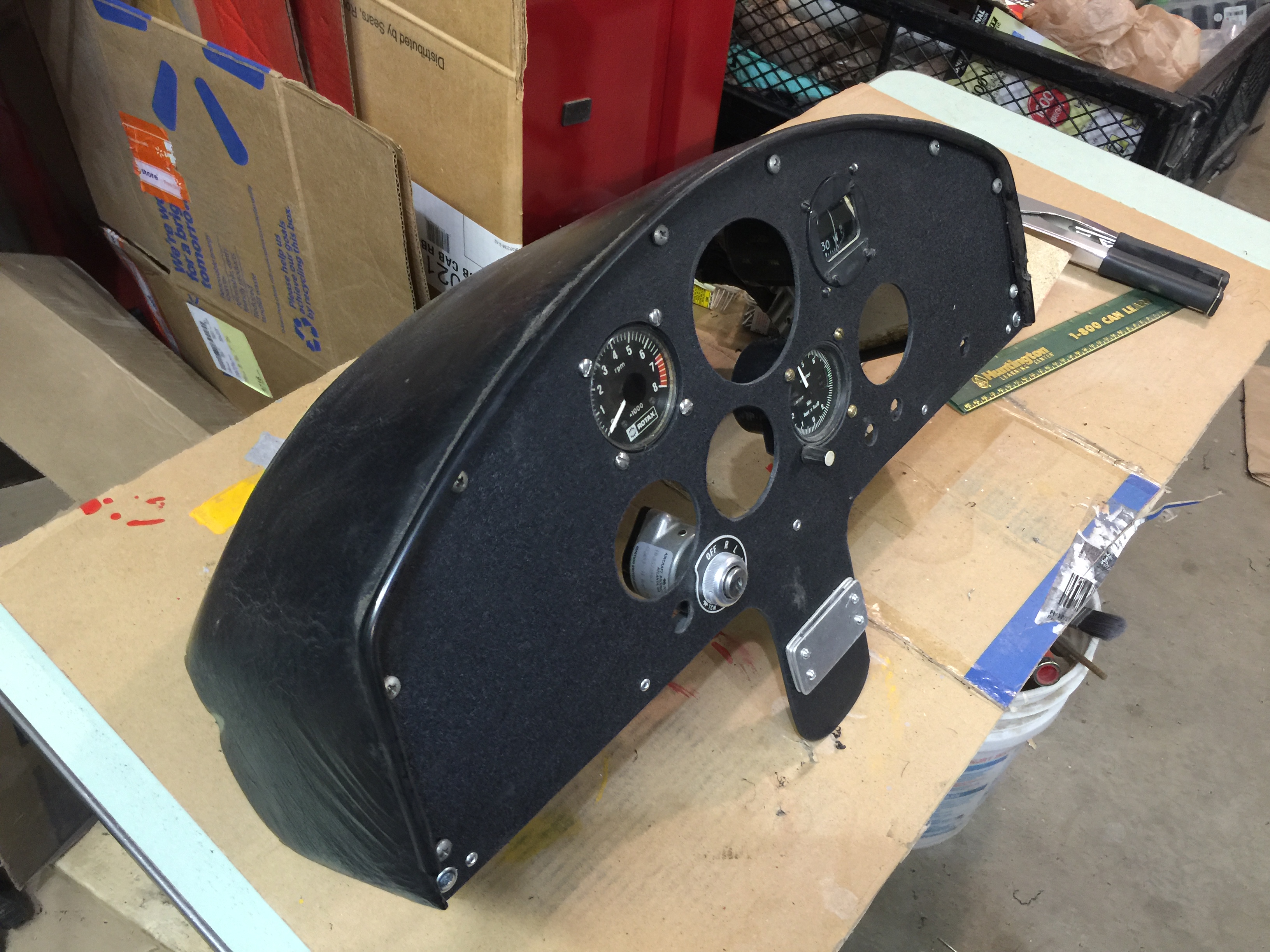

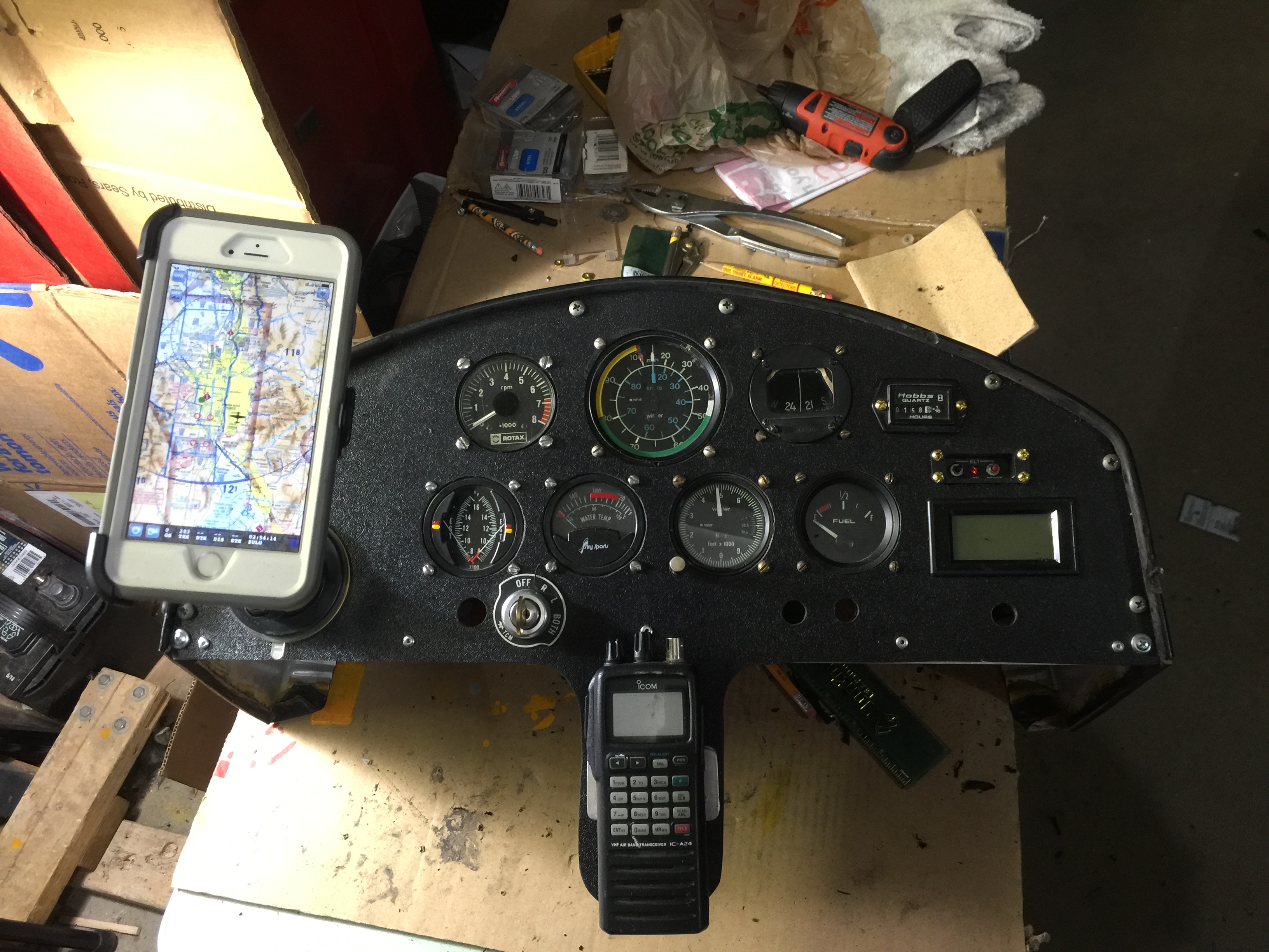

I am in the process of rebuilding a dash for my Mark III that extends 12 inches back to the pilot. I am 6'2" and can reach the mag switch and altimeter while still belted in.

Looking at the inside shot of the pictures you posted, there's not much room between the pilot's shins and the bottom edge of the extension.
I am not sure how big you are, but let me tell you how I get into my plane. I am 6 feet- 235 lbs. I sit backwards on my seat, lift my left leg over the stick, and down onto the rudder pedals. I of course reverse this process to get out of the plane. My plane has longer gear legs, so I had to change the method of entering the cockpit. With the smaller gear legs, One can lift up the wind screen- stick the left leg in, then put your butt on the seat. Much like what you do to get into a sports car. These are only ways to get in that I have found. Smaller younger pilots will be able to do things that I probably cannot.
The only thing on my cockpit that I need to do anything with is adjust the altimeter. I do that on the ground. The rest of the controls that I need- tank selection- fuel pump, strobe, ignition switch are all located in various spots that are within reach.
Primarily what I am saying is that you can position every thing that you need in spots that allow you to reach them while seated and flying. It just takes some thinking on your part. However you are the one that will be flying it, your choice, but give it some serious thought. I have a small center console in front of the stick that holds my radio, all my switches- plug ins for the intercom. HAC man system on the left side by the throttle, fuel selector switches on the gusset to the left of my seat. Take a poll and see how many have moved their console out.

Being one who must remain conscious of leg room, I would be careful how deep you make your extension and/or the top to bottom measurement. Too much in either of these dimensions will cut down that leg room. Looking at the inside shot of the pictures you posted, there's not much room between the pilot's shins and the bottom edge of the extension.

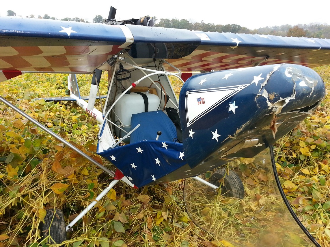

Something to consider about your instrument panel;
Autumn of '13 I took off in my FlagFly and at about 800' I had an engine
out. Too low to do a 180 so I looked for a place to put it down. Lots
of soybean fields so I picked the best one and, thinking the soybeans
were maybe 6 - 8" high, went in to land. Found out after I was able to
locate the seat belt buckle (major disorientation when hanging upside
down by the belt!!) drop down and climb out before it caught fire that
the soybeans are about 2 1/2 to 3' high, and the stems are like hemp
ropes. When the landing gear got into the soybeans and stopped, the
nose dug straight down into the ground and bent up as I was forced
forward by the inertia. My shins got acquainted with the bottom of the
instrument panel and I snapped off the bottom of the slip indicator with
my right shin bone. Took a while to heal.
If you look at the pic of the front end and wonder how my face did with
the tube that supports the windscreen, not too bad, Third deep cut at
the same place on the bridge of my nose in my lifetime, so the new scar
is hardly noticeable. I miss the FlagFly bad but I'm not in a position
to replace it just now, plus I'm a tad sensitive about 2 stroke flying
now. That's just me, your mileage may vary.

I agree with what Larry says here. (Even if Scott Olendorf's panel setup is extremely cool)
It is really easy to make the panel on the FSII slide out a bit; notice that the wood has holes drilled in it and the windscreen tubes fit through it. You remove one screw on either side and the panel will slide up the tubes about 8 inches, plenty of room to get access to the back side.
Radio Shack is out of business, but the little black box with all the switches on it has lots of room for all your wiring needs. Probably other electronics shops sell similar boxes.

I sold it to a man up on the Cape (Cod) who has a business of restoring
antique cars. He called me about all the dimensions and built a
stainless steel trailer to come down and pick the FlagFly up.
The damage, although I ended up upside down, was solely to the cage, but
I figured it would be foolish to spend the money (I'm not equipped to do
it myself) to have it repaired and still have a 2 stroke engine. Now
that it's gone I probably should have considered replacing the engine
with a 4 stroke because it was built meticulously and I loved that
little thing!!! Like a sports car in the sky.
