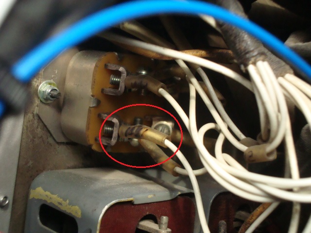

The Reds unwisely used 20-gauge white wire for nearly everything, which makes physical wire chasing difficult on the aircraft, but each wire should be ID'd with a 3-figure code on a clear sleeve at each end, ie - "3Y2", "7X12", etc. See photo of a typical sleeve on my bird, it states "14Y1".

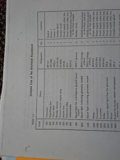

 The first 2 characters identify the system (landing gear lights, oil pressure gauge, etc) and the last digits are the actual individual wire. These wire codes are directly noted on the wiring diagrams and there's a very handy Table 7.1 in the manuals that explains each system's specific nomenclature (the 3Y, 7X, 25W, etc. See photo).
This will help you find the specific wire bundles and routing for these gauge gremlins.
