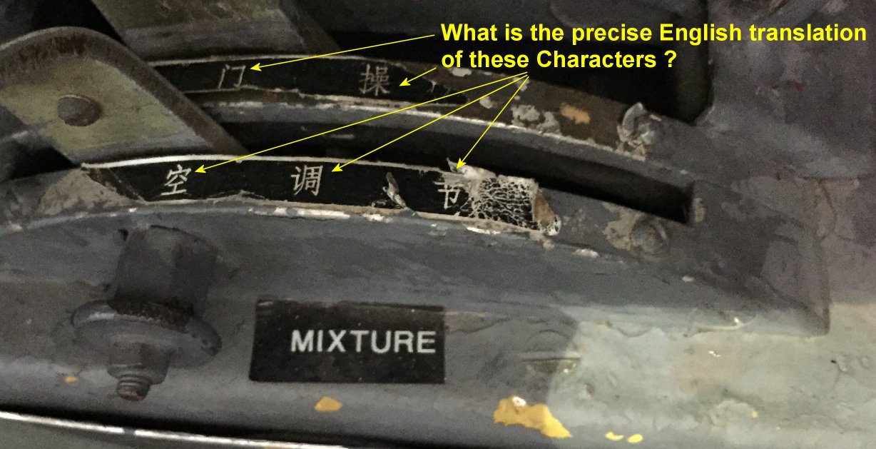

What are the exact meanings of the Chinese characters in the image below. From the discussion in this thread the Mixture ones I presume relate to Altitude in "Thousands of Metres", but what are they exactly ?
One or two are missing in this image

PostPosted: Fri May 22, 2015 3:16 pm    Post subject: CJ6 Housai Reply with quote
Can't see images.

PostPosted: Fri May 22, 2015 3:27 pm    Post subject: CJ6 Housai Reply with quote
"Abandon hope all ye who enter here" - or something close.
In Mandarin you could render it as "there's still time to buy a Yak"
Sorry not to be of more help
Cheers
J

rmhou(at)yahoo.com
PostPosted: Fri May 22, 2015 4:26 pm    Post subject: CJ6 Housai Reply with quote
Some characters are missing in your labels, but they look to be the following:
The top label is "throttle control"; and
The bottom label is "high altitude adjustments".
To counter John's translation, the above labels also mean "I fly faster and further than Yak's" Wink

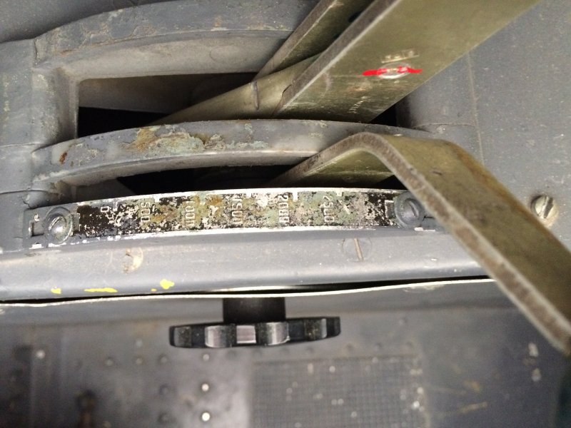

Found these on the backseat Mixture quadrant. Buried under paint and other crap. Only visible after a really good clean Smile

"To counter John's translation, the above labels also mean "I fly faster and further than Yak's" Wink"
Not all YAKS Robin ...... Smile
Mark
