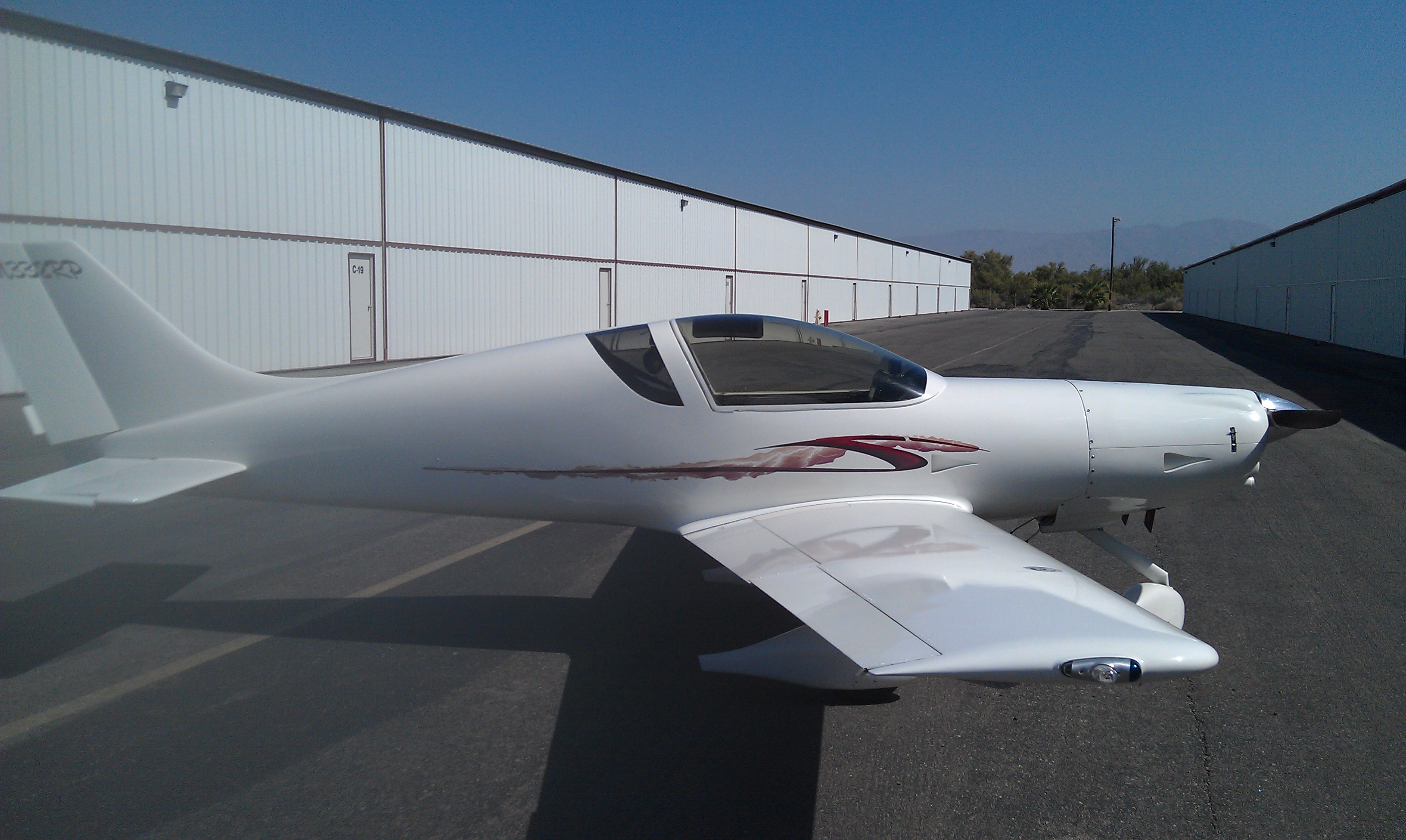

rwilhelm(at)dc.rr.com
PostPosted: Thu Jan 08, 2015 4:12 pm    Post subject: question Reply with quote
I am not sure what good my pictures would do for anyone else but a Jab 3300 install. Even that would be stretch because everything forward of the firewall in not Pulsar.
Ray
