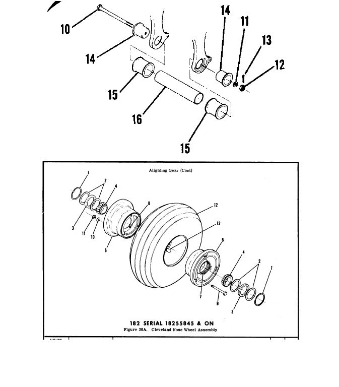

Glastar has this same issue. The difference is that they use a Cleveland wheel that has seals like the main axels. They use an aluminum spacer between the fork and the bearing (slipped over the axel) and then a small roll pin in the fork that seats into a small slot on the spacer to stop rotation.
With the radius on the bearing that we have the only solution is to have a spacer that has the same radius and a large surface area.
Another thing to try is to have a spacer inside the wheel on the axel so that when you clamp up the whole assembly the inner race of both bearings are clamped between the spacers and thus you can clamp the bearing race tight without preloading the bearing excessively.
All in all not a great design from Van.

Today I stopped by a machine shop and had them take off about .115" off
my axle, to accomodate 2 AN970-6 washers on the outer edge. Yes, they
are .063 each, so .126" would have been the standard, but I wanted the
axle to be even just a little more snug than before, because any flexing
inward will bring that valve cap closer to the fo rk. As a side note,
this from John D. today...a note someone sent him:
"returned the nosewheel to Matco to have it replaced with WHLNW511.25
which is correct for the valve stem on the tube and avoids the clearance
problem with the supplies WHLNW501.25."
In other words, Van's is sending out the wrong wheel for the application
on this plane...because they use this wheel for the RV-7's and such, and
didn't want to have to stock 2 parts. So we get to receive the one that
isn't made for the application, and therefore unless you swap wheels,
you're going to have minimal valve stem clearance.....pretty nice, huh?
Anyway, I had the axle cut shorter at a machine shop, and then I just
had to guesstimate how much to take off the 2 spacers. Knowing they had
worn into a taper on the inside, to fit against the bearing, I had them
only cut d own by .085" total. I did .035" on one side, and .050" on the
other. That way I could have a slightly longer sleeve on the left side,
so my valve stem had just that little extra clearance from the fork.
This brought forth a small problem... Tonight when I assembled it as in
the first photo below, it looked great. VERY much better than original.
Then, when I put the whole wheel together, I found that the spacers
had worn probably at least .120" because there was tons of slop in the
spacers yet, even though they now had a nice flat surface to sit
between, and had been cut less than the axle, and the washers were in
there to fill in some space. The spacers just spun. So, I decided
since I already ordered another axle, I'd take my bandsaw and VERY
carefully trim off some more axle, and just use one more washer on the
left side. That should keep that valve stem even FURTHER away. If I < BR>> was right, I could get it so there would be plenty of pressure on the
bearings and spacers to hold them in place so they don't spin. Sure
enough, it worked just great. I could now torque that bolt down tight
and keep the spacers from spinning, and the bearing too. Just to be
totally sure they never spun again, I drilled a couple of holes in the
stainless spacers, and remounted it all. Then I made a pilot hole in
the aluminum axle shaft, and took it all apart and tapped it for an 8-32
screw on each spacer. Then I cleaned it up, regreased, and put it all
together. Now it is very solid, and should never wear the fork
again....I just am left with a crappy fork...so I'll probably just get a
new one. Once my new spacers and axle come in, I may tear it all apart
and use those pieces, but I'll still probably cut the axle and spacers
down and use the washers on the outer ends. It will prevent your forks
from being the sacrificial component. The bearing, for future
reference, is a Timken LM-6700-LA (I think that's right, but I'll
re-check tomorrow)

PostPosted: Tue Aug 15, 2006 10:11 am    Post subject: Serious Front Axle Maintenance Issue on the RV-10 Reply with quote
I have attached a pic from the parts manual of the nose wheel and axle of a
C-182 for reference.
Kevin
40494
