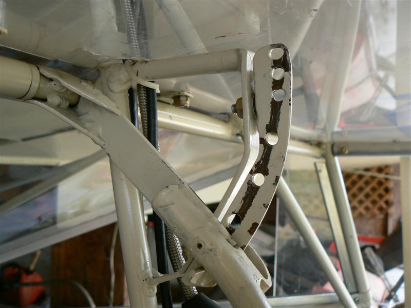

My flap problem on the acquired Mark III is that the detentes the flap
handle uses have been pretty much destroyed. I can't use them. So I have
secured the flaps full up with a hose clamp (not shown). I wonder, since
the other Kolb here at TorC Airport has no flaps and I have no other
reference, if someone can send me a jpg and or drawings of the appropriate
area the handle engages. Can't tell from what's left whether there should be
more detentes. A local A&P says he can make one and rivet it over what's
left. But he has no idea how many notches there should be, or their spacing.
Can someone also provide the measurements and spacing of the... what shall
we call them...hooks, flaps detentes, catches...?

PostPosted: Wed Aug 02, 2006 7:28 pm    Post subject: flap takeoff Reply with quote
If you want to be creative, you can have as many notches as you
want...even some reflex, so you don't need as much up elevator trim when
you are carrying a passenger -
http://www.bcchapel.org/pages/0003/pg3.htm
If you are interested, contact me off list, and I'll send you some more
pictures tomorrow.

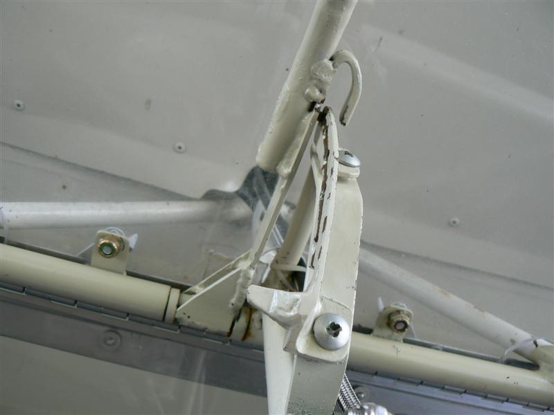

PostPosted: Thu Aug 03, 2006 9:01 am    Post subject: Re: flap takeoff Reply with quote

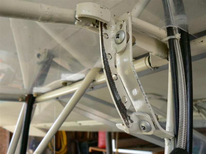

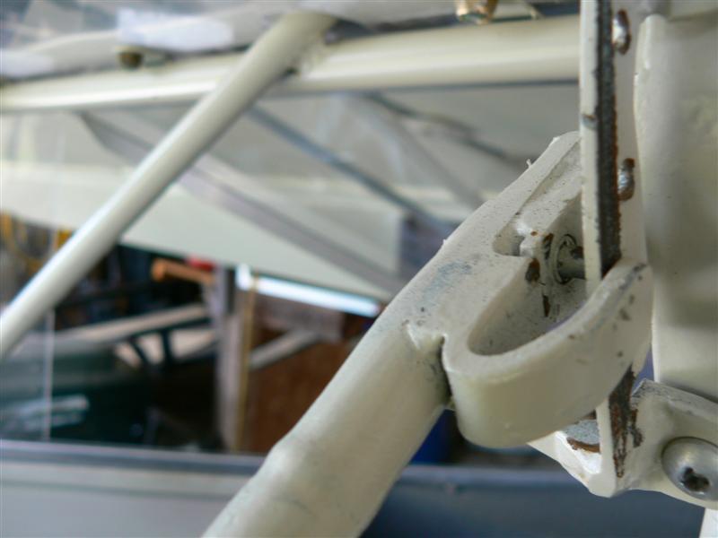

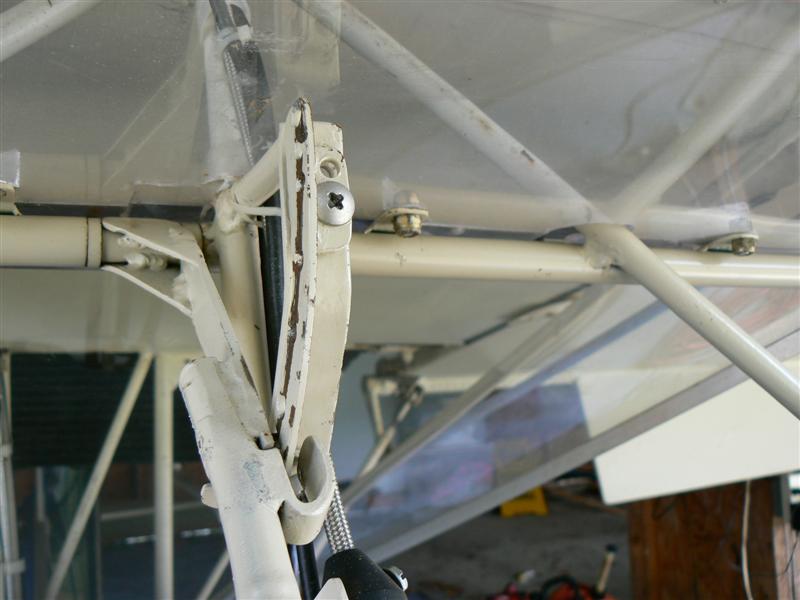

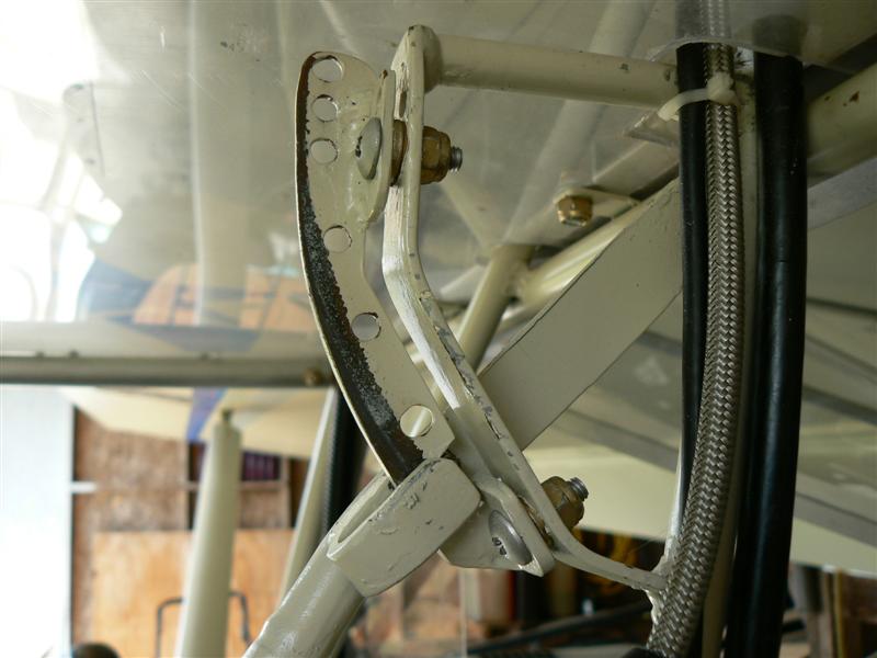

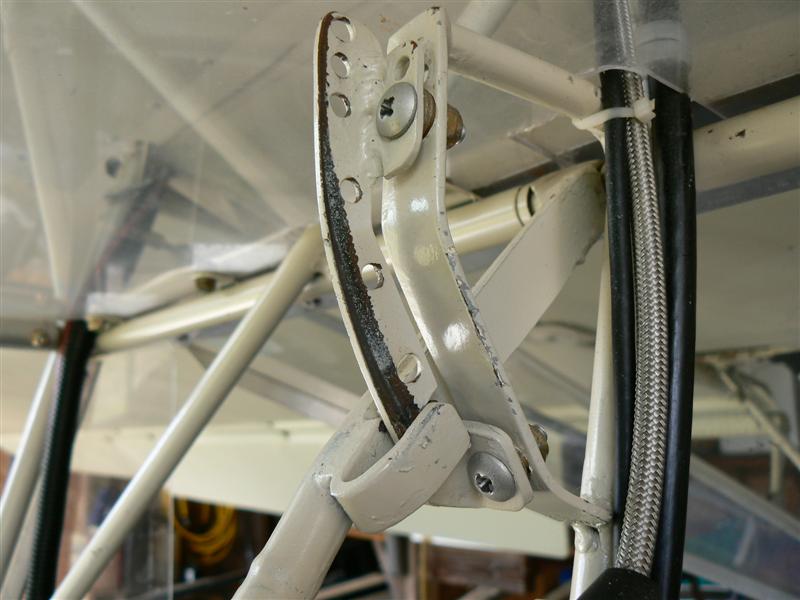

Here are some closeups of the mechanism. The detent with the holes in it is bolted on to the flat front part of the original detent piece. The handle is modified by making it longer (easier to pull flaps on, more leverage) and also bent a bit to fit under my lowered windshield.
I drilled a hole through the handle tube and welded in a bushing, and then drove a roll pin into the bushing. I located the holes for the various flap detent positions by attaching that piece to where it needed to be, and then scruffing the roll pin up and down on several times, that showed me where the holes could fall in line. Had to do some grinding/tweaking to make everything line up. Finally, I welded a retainer to the handle which bends around to keep the handle from moving very far to the right. You have to tuck the detent piece into place before you put the screws into it.
With this system, I have about 3 degrees up, neutral, about three degrees down, 10 degrees down, 20 degrees down, and 30 dgrees down. Not quite as much as Kolb originally had, but that is deliberate. If you have 40 degrees of flaps and have to go around or flare with a heavy passenger, you sort of run out of elevator authority. Having a bit less flaps helps cure that, and it still lands about as short as it did with 40 degrees.
Having 3 degrees up reduces the need for as much up elevator trim when carrying a passenger. And when I get light on fuel, 3 degrees down also helps it trim better. Due to differences in airplane weights and pilot weights, your results may vary.
