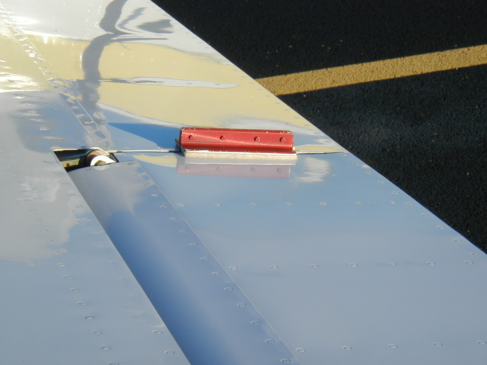

Here's a picture of a full metal version and there's a version for the rudder using the stops too.  If anyone is interested, I can get pictures of all of them and post.  The advantage is that the surfaces are held without the pressures being transmitted through the control rods and cables.  Also, the controls will not move and that should be noticeable during the checklist (you do use a checklist, right?) or taxi if you forget them.
As far as locking goes, I plan on locking the throttle and mixture controls too.  I plan on making locks similar to the ones at Sportys (http://www.sportys.com/acb/showdetl.cfm?&did=19&product_id=3569).  You can get a pair of those padlocks at Lowes or Walmart for $20 and I'll weld up the tube.  I like the simple doorlocks from this list and I plan to use them too.  I don't want it to be too easy to get in my plane after removing the cover.  I want "them" to look for easier targets.
