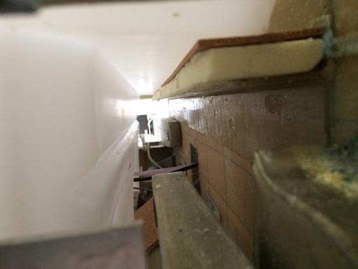

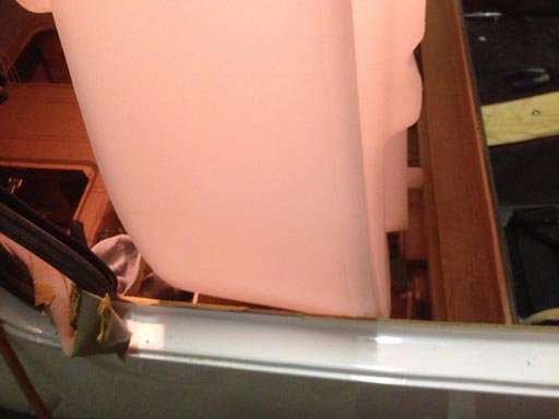

Having just replaced my fuel tank, I can speak to this issue. I did the replacement with doors on & wings off. There is one issue in fitting the new tank. The door sill on one side must be cut out to allow the new tank to go in:
[img]cid:90305085-EE13-46AC-952C-784C0463C387[/img]
[img]cid:BAD48C18-EDA4-4A84-B444-282ED12102FD[/img]
If the top were not on, this cut would not be required.
But, there’s no way you would be replacing the tank till long after the top is on in any case. You can slosh all the av/mo gas you want doing fuel testing, etc, during the build and you won’t affect the tank. The tank will have to be in contact with the fuel for an extended period of time to absorb sufficient fuel or entrained solvents to soften the tank material.

Once the cradle gets bonded in the top "shelf" of the tank is supported by the other lay up 'T' piece which is on the seat back.

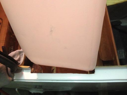

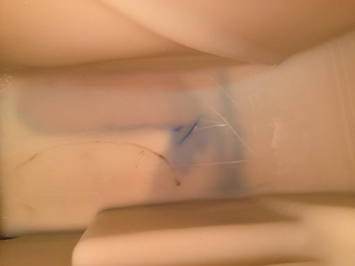

Yes, to the stress concentrations caused by the fiberglass “shelf." My tank cracked right at the corners of one of those fiberglass layups:
[img]cid:64619E84-D1BA-4D2B-B86C-A6DDB1BC9EA5[/img]
In this view the top of the tank is off and you are looking down into the port side of the tank. The crack is pretty well defined in blue and is right on the corner of the outside, forward corner of the “shelf.” Right at the 45º predicted by stress analysis.
Kinda/sorta, the fix is to provide support under the tank. The rear “shelf” is still there attached to the rear bulkhead which carries most of the load supported on a layer of cork. There is also support built under the forward part of the bottom of the tank. This is a thick micro applied in lines upon which the tank was set (plastic wrap used as a parting agent) and the micro allowed to cure. The micro was also covered with cork. The micro is not to provide primary support only secondary support should the gas soften the tank and allow some sag. The micro would support the sag rather than sagging over the shelf causing another stress riser. The aluminum T shelf on the front bulkhead had a layer of urethane foam bonded on top to support the ledge of the tank. This was also covered with cork.
[img]cid:303EFBE6-3486-457C-9F40-977668A5C1D0[/img]
From my (very limited) research on this issue it appears that tank cracking is a combination of things. First, of tank softening due to the absorption of fuel or solvents in the fuel. Second, softening causing sagging. Third, stresses induced by sagging over a corner of the fiberglass used to support the tank on the aft bulkhead. Fourth, perhaps the tank becoming brittle and more susceptible to cracking by removal of the fuel and subsequent evaporation of the fuel or solvent from the softened fuel tank material. I’ve seen pictures of a crack virtually identical to mine only on the starboard side. I also saw a picture of a crack on the starboard side corner of the fiberglass support in the tunnel area.
Some sort of support is needed under the tank to prevent the sagging causing stress risers on the corners of the fiberglass. I’m providing support as suggested by Bud in his fuel tank replacement guide.

> One thing I noticed with your setup is that the tank could potentially
> pivot and tip forward under weight. The cradle may need an additional
> support at the forward end.
> In my case, I am bonding the cradle to both bulkheads (seat back and
> baggage bay), creating a sturdy raised floor for the tank to rest on.
> Like yours, I also have lateral and fore-aft support to hold the tank
> in place. I don't have pictures yet, but will have some soon.
> On Sat, Mar 29, 2014 at 5:07 AM, spcialeffects wrote:
