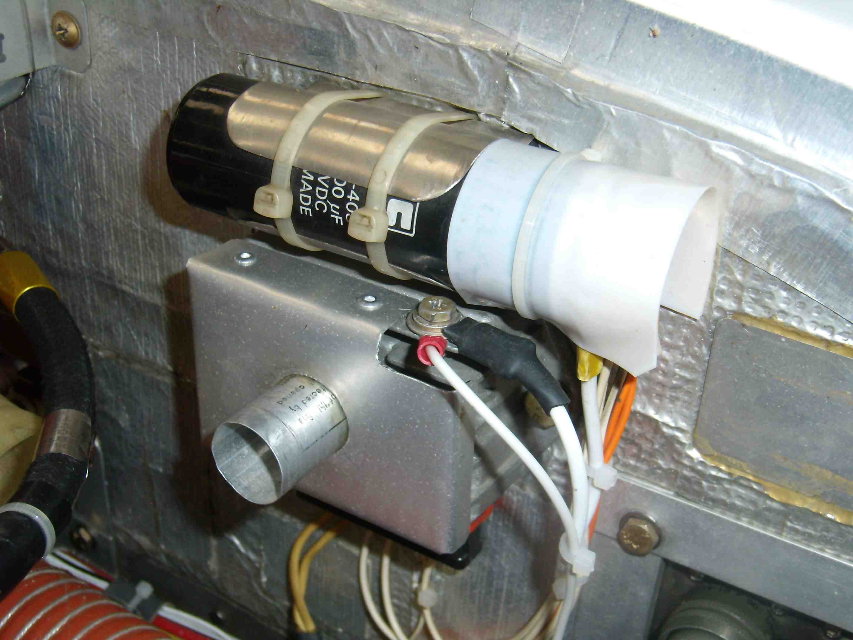

Very interesting discussion on the regulator-rectifier. After my first Ducati regulator failed at about 150 hours, I designed some simple installation improvements in order to increase the reliability of the unit.
I believe the main problem is to dissipate the heat. On the Europa, the regulator is bolted to a composite structure which cannot act as a heat sink. So it is necessary to duct cold outside air to the unit fins. I use SCAT ducting to take the air from the front of the cowling to a plenum riveted to the Ducati fins.
Another issue is grounding: the unit being bolted through a weak glassfiber/foam sandwich structure, there is no way you can compress the ring terminal enough to make a good ground connection. Now my ground wire is bolted to one of the regulator fins using a separate bolt which can be torqued properly. See attached picture.
Then there is the warning light which occasionally was giving false information while the bus voltage was just right. I have since disconnected the L terminal and installed a separate low/high voltage monitor (B&C).
The replacement Ducati regulator I installed more than ten years ago has now close to 1000 hours. May be because I have been carrying a spare unit since the original one failed?
Remi Guerner
 Filesize:  197.7 KB

PostPosted: Wed Jan 22, 2014 4:58 am    Post subject: Re: Ducati rectifier/regulators Reply with quote
The problem with external diodes as mentioned above is that the heat sink they mount to will be at battery voltage. A better solution is to use a bridge rectifier so the diodes are insulated from the mounting package. Then the heat sink will be electrically independent. Such a bridge is a Vishay 36MB120A ($Cool. This is a 35 amp, 1200 volt device which is similar to the original Ducatti diodes. I plan to install this Spring.
Jim Butcher
N241BW
tonyrenshaw268(at)gmail.c
PostPosted: Wed Jan 22, 2014 9:59 am    Post subject: Ducati rectifier/regulators Reply with quote
Hi Remi,
Thank you for a vanilla way of dealing with the problem.
Tony Renshaw
Sent from my iPad
Remi Guerner
