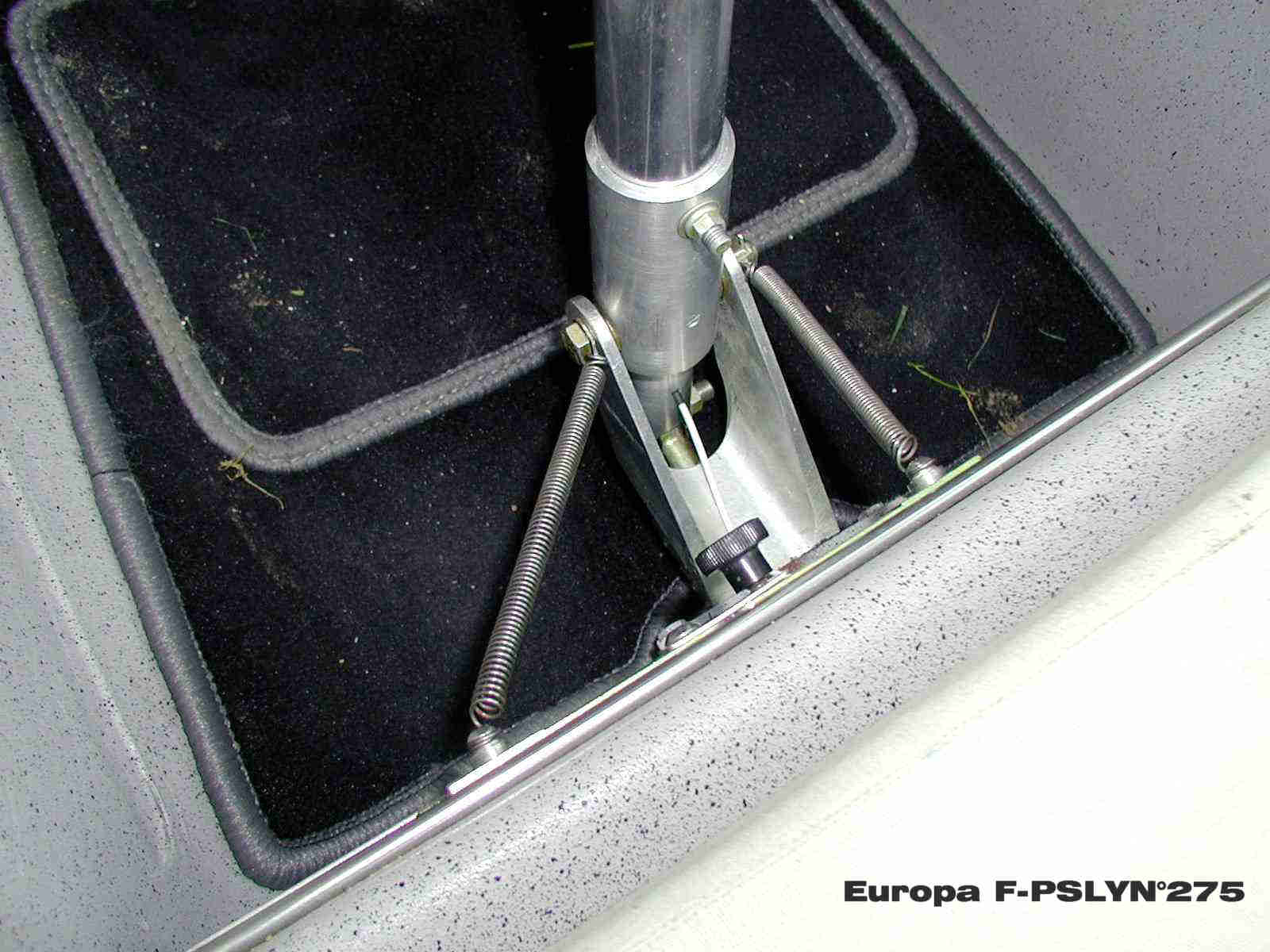

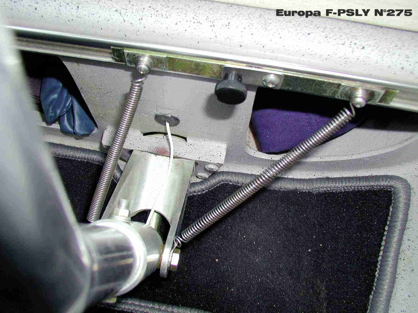

PostPosted: Wed Dec 11, 2013 12:33 am    Post subject: One wing low Reply with quote
Hi all
Mine cost a few Euro and works fine since 1999 without energy.
See attachment.
Alain CHABERT
Gsm : +33-6-07.71.02.17
e-mail : alainchabert(at)wanadoo.fr (alainchabert(at)wanadoo.fr)

pete(at)lawless.info
PostPosted: Wed Dec 11, 2013 2:54 am    Post subject: One wing low Reply with quote
Hi Alan
Like it a lot – really neat solution to the problem and very simple!
Pete

PostPosted: Wed Dec 11, 2013 3:28 pm    Post subject: Re: One wing Low Reply with quote
Hi Alain
I like your set of springs great idea, nice of you to post the photo,s.
Think I could manage that one Ok,
Many thanks.
Alan
